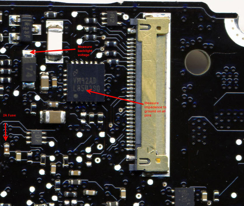

The boost diode is the device with 74 written on top. The end with the white stripe is where you measure the backlight voltage. The device you circled as FET is the NAND gates that provide the enable signal for the backlight circuit. If you pm me I can probably walk you through a few diagnostics to help isolate the issue.
Hi, first of all, thank you all (mainly Dadioh of course) for this great thread.
My problem is basically the same as most of you - non working backlight, everything else seems fine. I bought the macbook from ebay as AS-IS, though that I will replace the screen, however I found out, it was spilled on it... than found this thread and read all through it. But I never found exactly the same model as mine (13 Macbook Pro 2,66GHz, mid 2010), so here's the picture:
http://dl.dropbox.com/u/2635790/quIfTtoLygA1pOSJ.jpg
Can anyone confirm, that I marked the components right, please? (I'm pretty sure about all of them except the boost diode.)
I measured the fuse (or what I expect to be a fuse), but it seems ok (closed circuit, very low resistance), so that leads me to conclusion that the WLED driver is damaged. However I don't really know how to proceed from here, how to make sure it is damaged, because it's a bit different component that was talked about in this thread (mine is LP8545 versus LP8543 which is in the previous macbook models...).
Also I'm a bit worried about the WLED availability... I checked the newark.com, digikey.com and avnetexpress.avnet.com but non of them have the component in stock 🙁
Anyway, I read a lot of success stories, so I'm hoping for the best.
Any ideas?
LP8545 datasheet (my model)
LP8543 datasheet (previous models)

Thanks for the reply. Actually, I read through the thread again and found out about the boost diode and measured it (using this picture: https://forums.macrumors.com/attachment.php?attachmentid=275509&d=1299882010).
It read something about 9-10V as opposed to 27V, which it should, so I made a conclusion it's the damaged WLED driver. (I managed to order it from avnetexpress.avnet.com, now waiting untill it arrives to Europe).
But.. what about the NAND gates and enable signal? How do I measure that? I checked the resistors around.. and all of them seems to be alright.

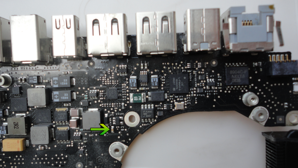

Hello Alex
Your fuse is best seen in the 3rd from bottom pic.With the heat sync & fan's facing you,look up & to the right of the right fan & the fuse is beside a big gray inductor.It's brown with a white dot on it.Good luck & we hope that your fuse is blown,cause that's the easy fix.Later
Hello Alex
Forgive me for being foolish, but is this the pic you're referring to?
[IMG=http://img199.imageshack.us/img199/4655/dsc02364mc.th.jpg][/IMG]
Any chance you can circle the fuse? Is it part F9800? I have the schematics for the logicboard and located that already.
Is this the part? Thanks! (trying to help out! LOL) 15'' A1286

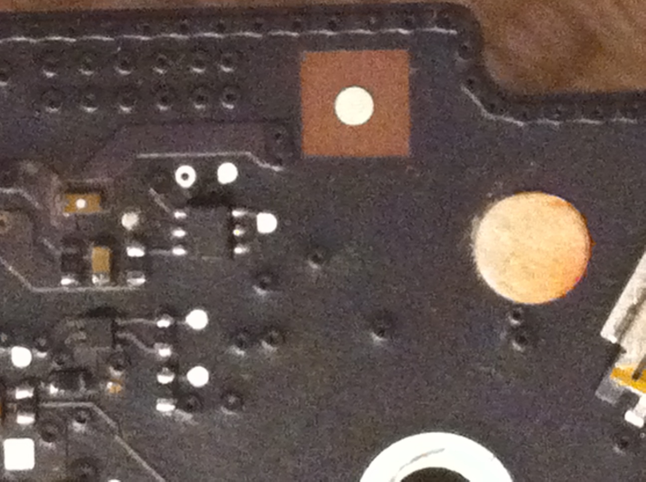

Hi Dadioh,
Could this be it? There isn't any solder to connect the probes.
That could absolutely be it. Is that on front or back of the board? If you have access to it you could power on the board and then carefully measure the voltage on either side of the fuse. It should be 12V on both sides.
Its on the front close to the lvds. I'll check for voltage and report back.
Ideally you check the voltage down at the solder pad of the circuit board and not on top of the component. The reason being, if the solder connection is good on the input of the fuse, the fuse is good, but the other end of the fuse is corroded and not contacting the circuit board solder pad you would measure 12V on the fuse end but that would not be making it down to the circuit board.
