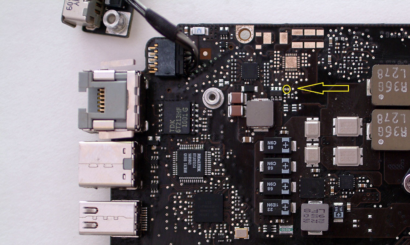

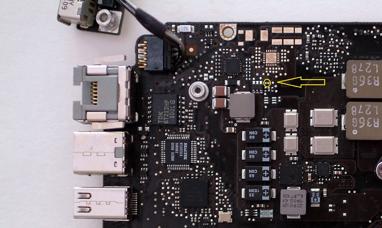

In order to identify the fuse we are looking at the very smallest components that you see on the board and then needing to zoom in and see if there is a white dot or an "F" on the top of one of those. I will see what I can do downloading and zooming on those photos. Also, it is entirely possible that the fuse in question is on the back of the board so you will need to remove the logic board and get photos of the back. If your camera has a macro mode use that.
edit: Can't see anything zoomed in. Need higher resolution.

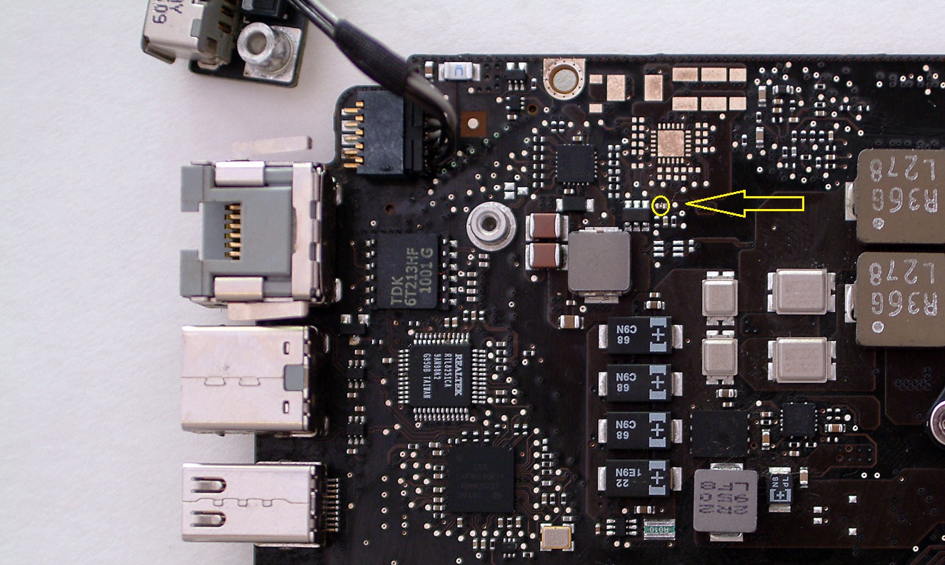

I have just finished going through a scan using this microscope on my logic board. I don't have prior knowledge of troubleshooting in the micro world but i gave it a try. I only found some traces of grease like substance around some of my resistors and caps.
Now, i am not able to trace the data signals as we have to turn the board each time a via occurs (completely lose track). Also, how to read the nVidia's BGA pins (something like matrix form, i assume - A32, J29)?
Any suggestions?

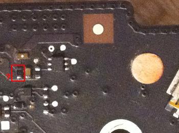

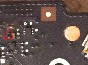

Thanks to everyone for posting as I have learned quite a bit. Special thanks to Dadioh without whom, many of us would have beautifully designed door stops.
My very inexpensive/cheap multimeter shows no continuity on this tiny little fellow with the white polka dot. This I hope means that I have correctly identified the correct 2A fuse/0402 package responsible for the back light failure. If my photo is not detailed enough, please let me know and I will try to upload a better one.
Dadioh or any one else who feels qualified to let me know that would be greatly appreciated. Thanks to one and all.

That looks like the fuse. If it shows open circuit and you have no backlight then you need to replace this. Somewhere back in the thread I gave some places to buy this.
Was this a liquid damaged board? If so, before replacing the fuse make sure you clean the board well to ensure that any leakage paths are cleaned up. Then replace the fuse and cross your fingers.
Good Luck.
Good Luck.

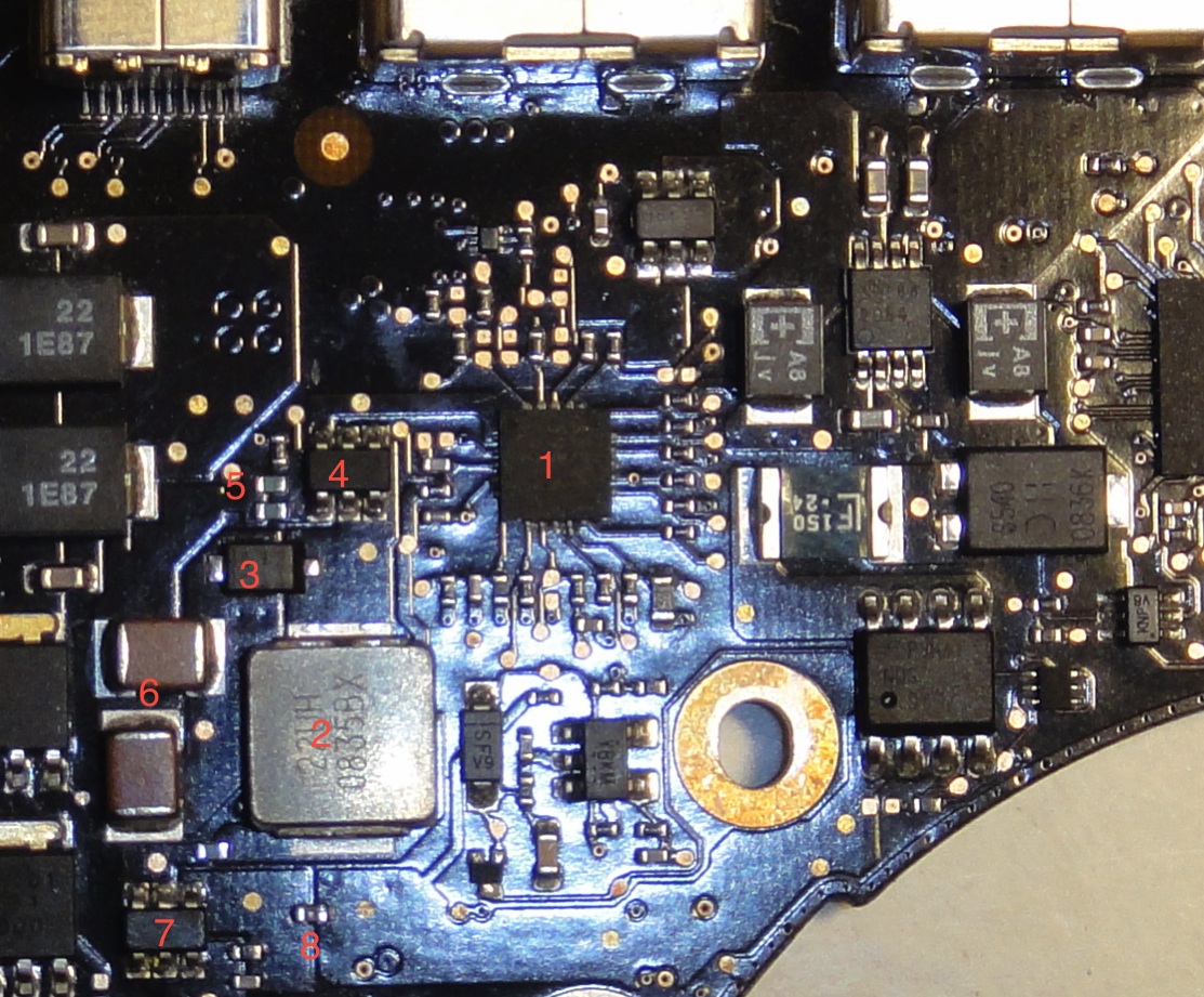

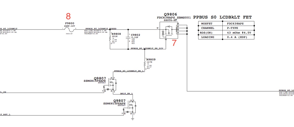

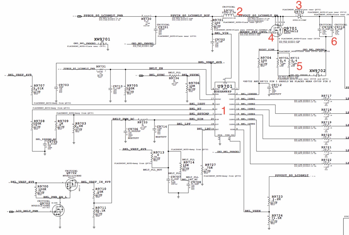

Great pictures.

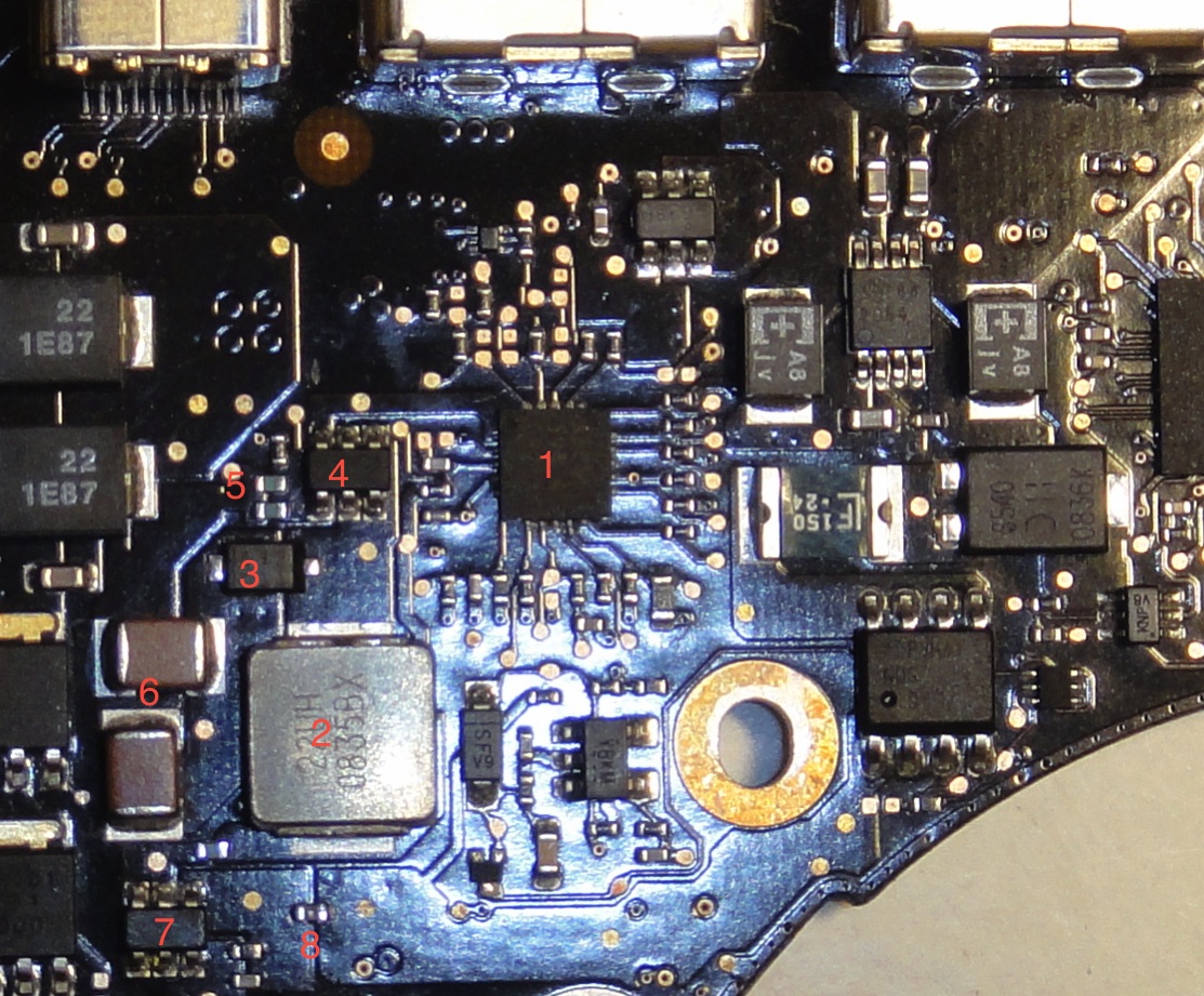

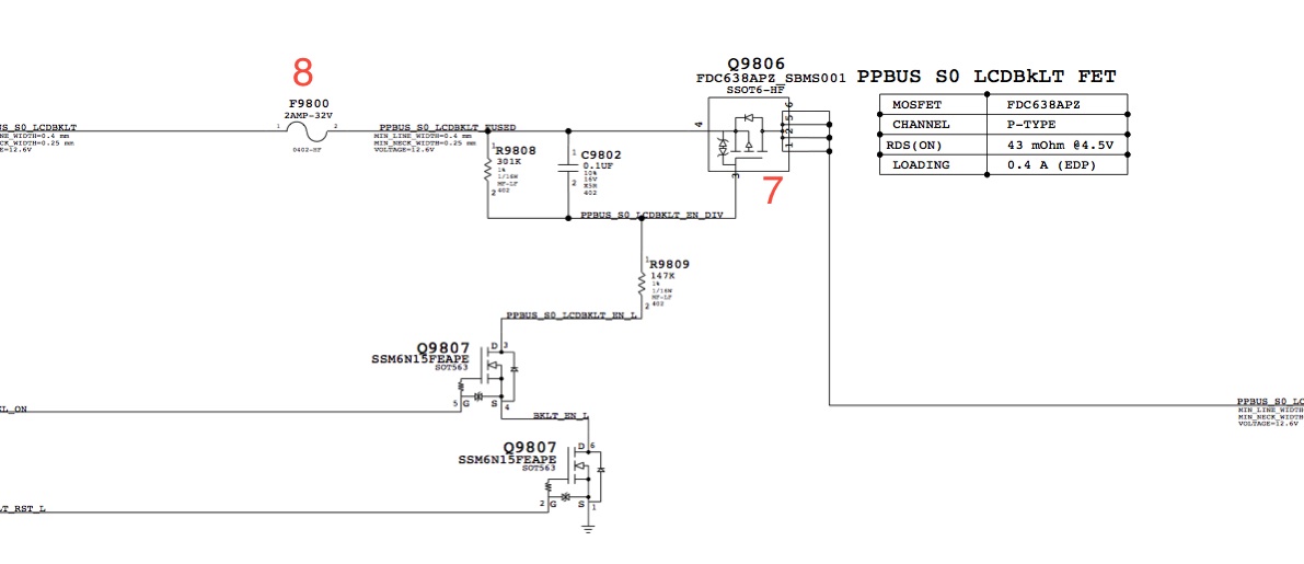

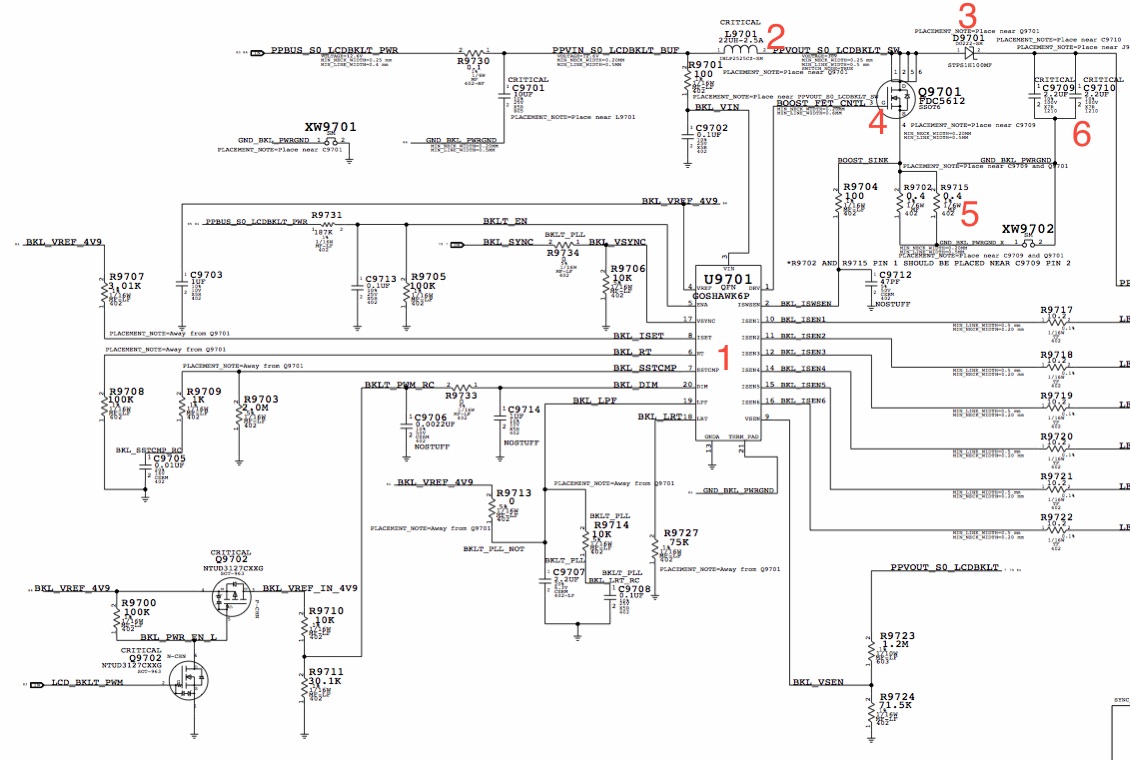

See attachments for a mapping of the backlight circuit to the circuit board.
