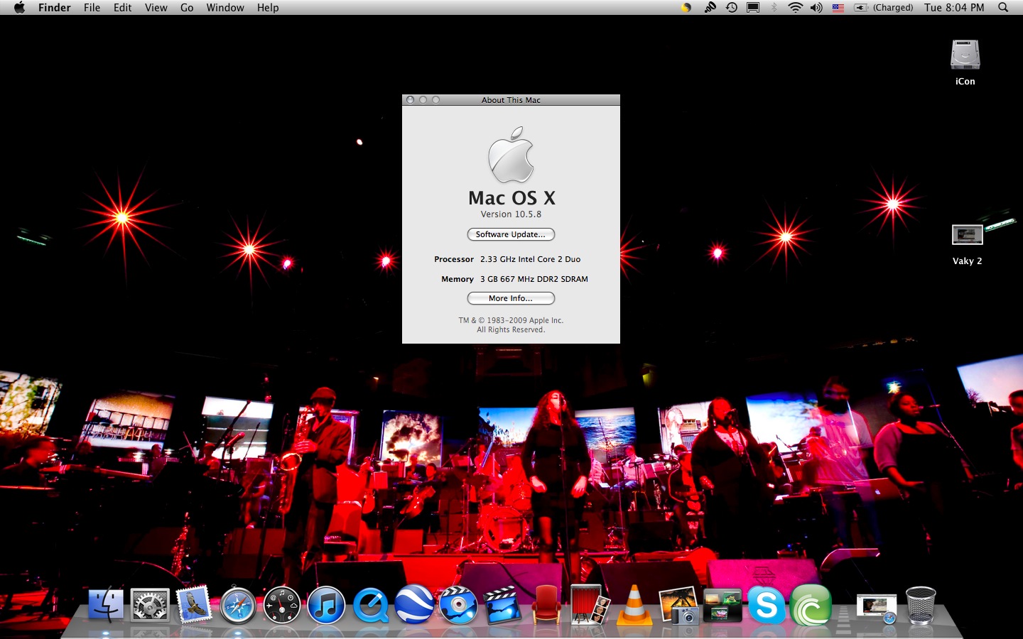

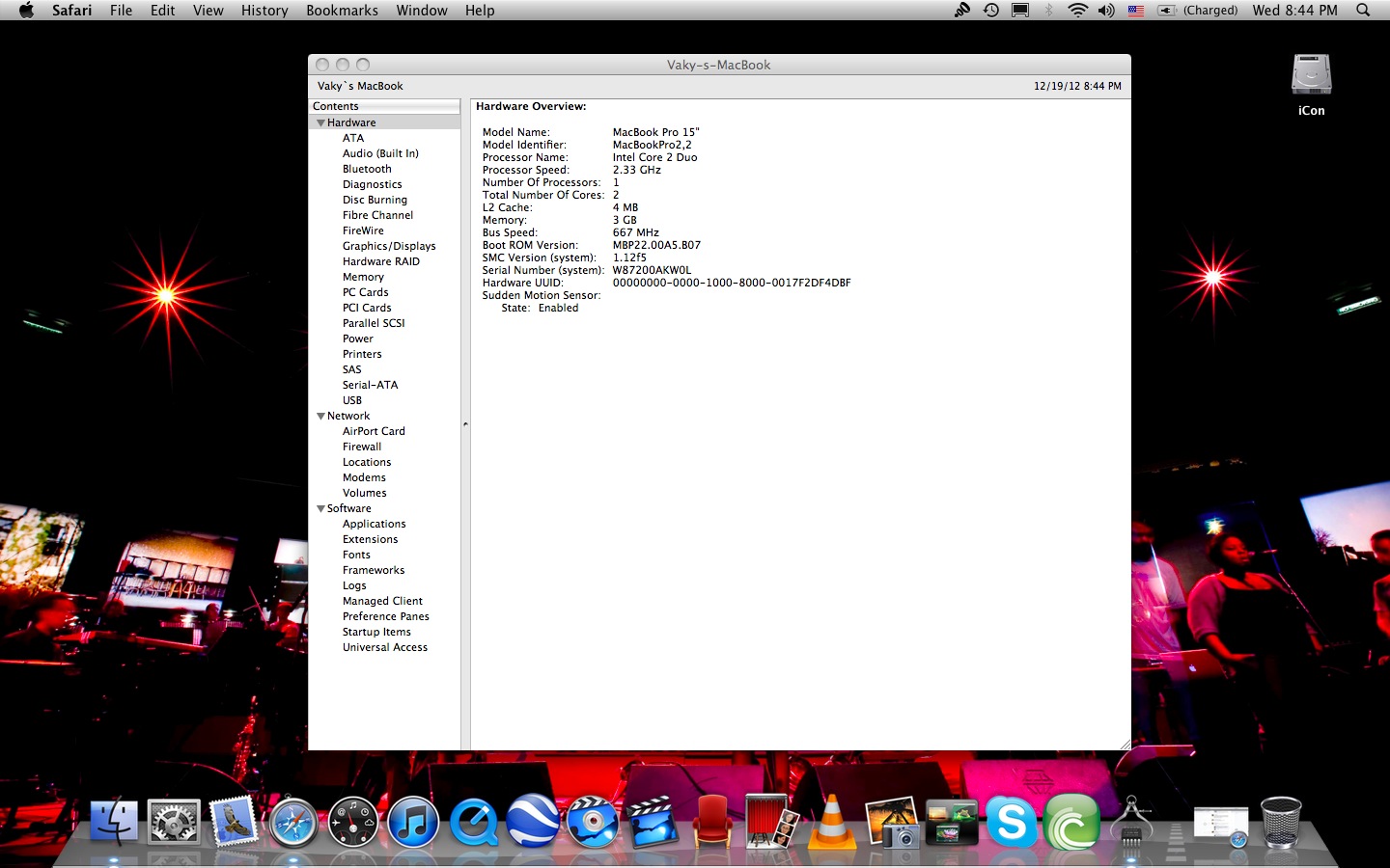

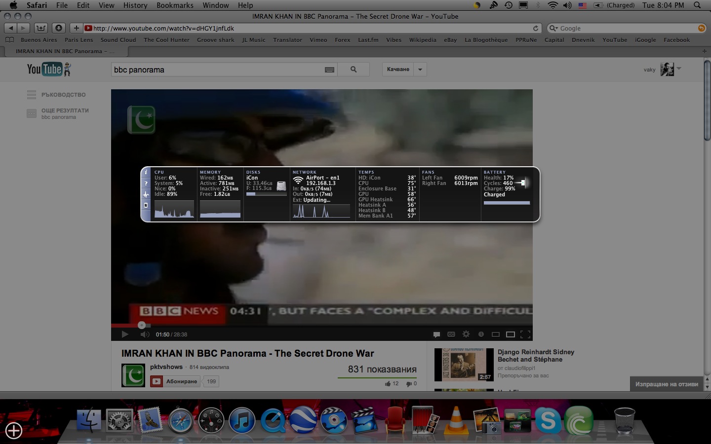

Hi guys.
This is the Mac version, I am playing some random vid on Youtube and the fans are at over 6 000 rpm in just 2-3 mins.
All answers are appreciated.

Yep, I have the latest🙂
Do you have a USB (8GB minimum) stick or an external HD which you can install a clean OS X on?
If so, I would recommend you to do so, and after you booted from it install flash only and look what it does there, if it is still the same it is almost 100% sure to be Hardware related.

Which exact model you have, go into System Profiler and look for Model identifier, then I could say what your mac can run.

I am willing to bet it is the GPU failing which is a bummer but there should be someone local (not the apple store) that can reflow or reball that for a decent price I would say no more then $200 is a decent price for that repair......
is there a certain area underneath your mbp that is particularly HOT!!!!! if so let me know the area that might help us pinpoint the issue.....
