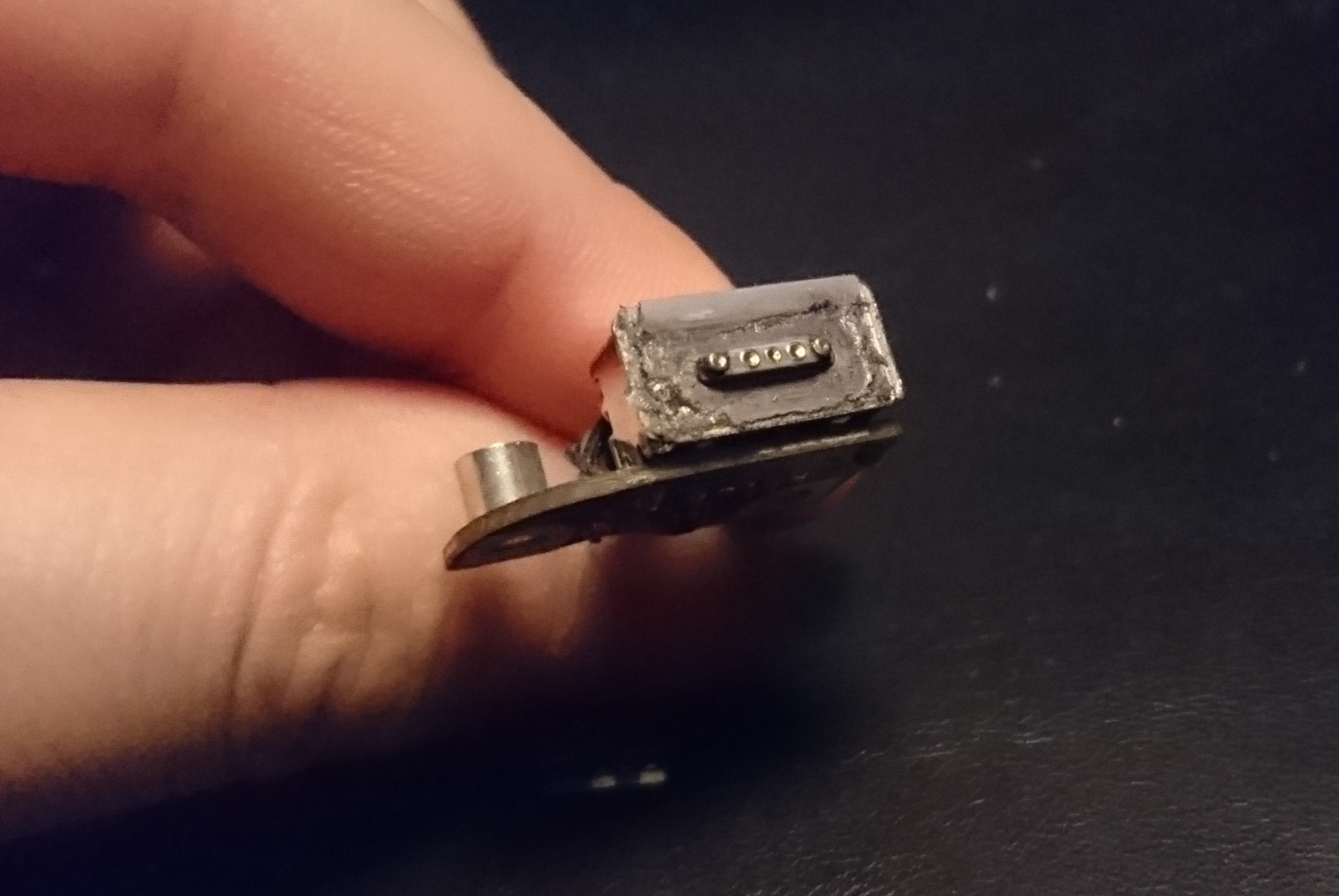

I have been having issues with the charging port on my mid-2012 13" MBP (2.9GHz i7, 16GB RAM, Intel HD Graphics 4000) for a while now - it wouldn't charge unless I fiddled the plug and put a piece of paper in the gap between the plug and the port to keep it exactly there. So I ordered a replacement port and followed the ifixit guide to carefully replace it. The old magsafe port looked like this 😱
