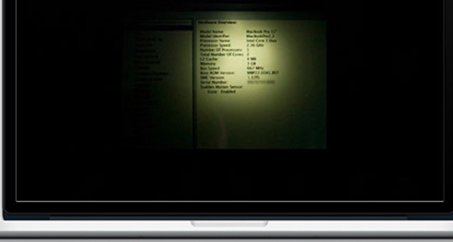

If the Apple logo is lighted up and nothing on screen, take an extremely bright light and shine it on the screen too see if you can see anything in screen.
Also try connecting it to an external monitor.

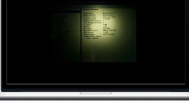

I tried an external monitor. It didn't work 🙁. I tried shining a light on it too. I didn't see anything.
