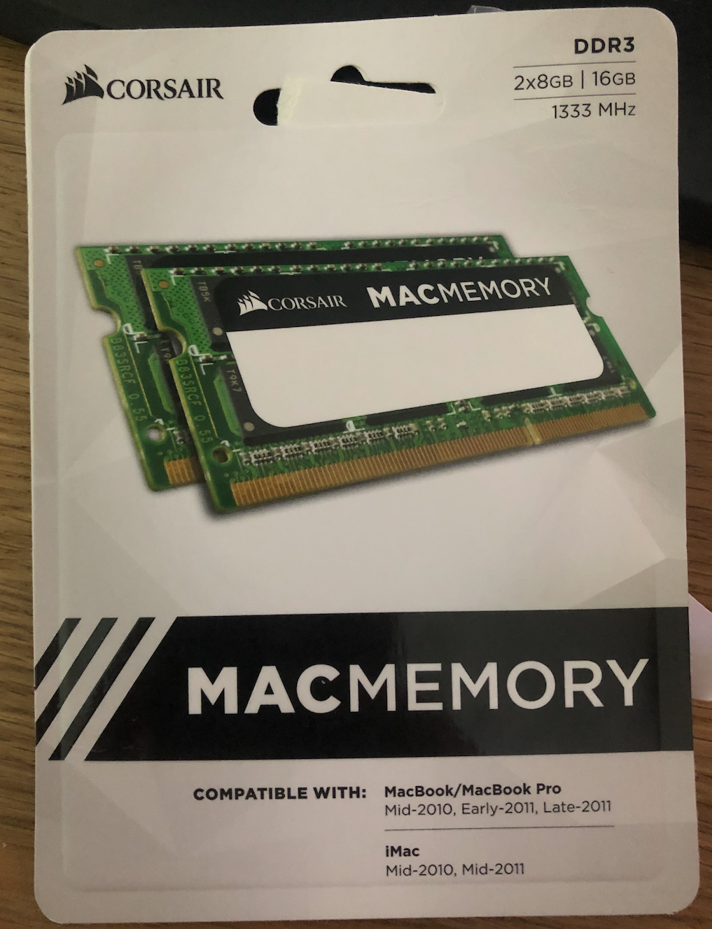

I grabbed mine yesterday, although had some obstacles to overcome.
First of all there is the Boot-Rom: I could barely find something about the MacBook7,1 and the latest Boot-Rom until i stumbled on a site where it mentioned that the latest version for this model is 68.0.0.0.0 but mine was showing MB71.003F.B00 and/but already running High Sierra. Afterwards patched Mojave before I actually remembered about the Boot-Rom.
So I went back and installed El Capitan + afterwards all AppStore updates and then downloaded Sierra and installed it on another partition. It went all fine and after the Sierra OS was set up I opened the App Store and searched for updates. These updates actually included the newest Boot-Rom-Version 68.0.0.0.0 that was installed with this update(which took a bit longer than usual).
The other strange issue is that I bought 2x8GB Corsair MacRam 1333MHz which do not work in the machine(although i knew that this model originally was running 1067MHz) but on the package it it specified as compatible with MacBook Mid 2010 (or MacBook7,1). One of these is able to run if another 1067MHz stick is installed and therefore the 1333MHz stick will be downclocked. More information in the attached image.
Machine running great now with 10GB Ram(correct 2x8GB 1067MHz 8500S coming soon!) and WD Blue 3D NAND 500GB SSD!

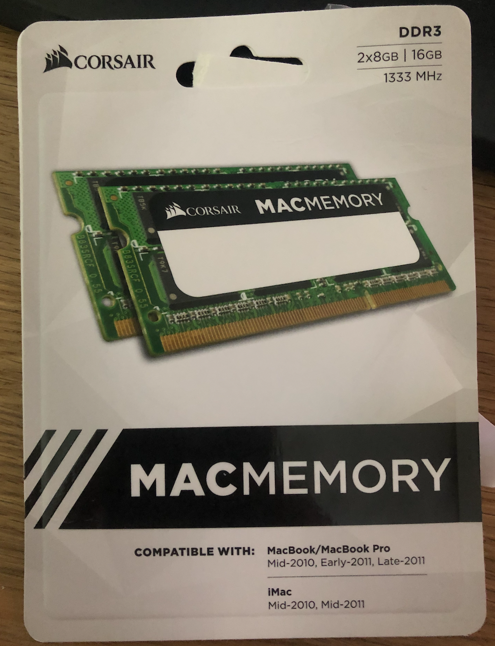

If you want turning a 1333MHz stick into a 1067MHz one you can run Thaiphoon Burner app (Windows-only). It allows editing RAM descriptors on your stick in a pretty straight-forward way. I did this on my Macmini 2010. You can edit the 8GB stick already installed on your Macbook, then put it on the slot#1, and finally you can use the remaining 8GB stick.
Thanks, will try that out! setting up windows on my MacBook7,1 currently!
