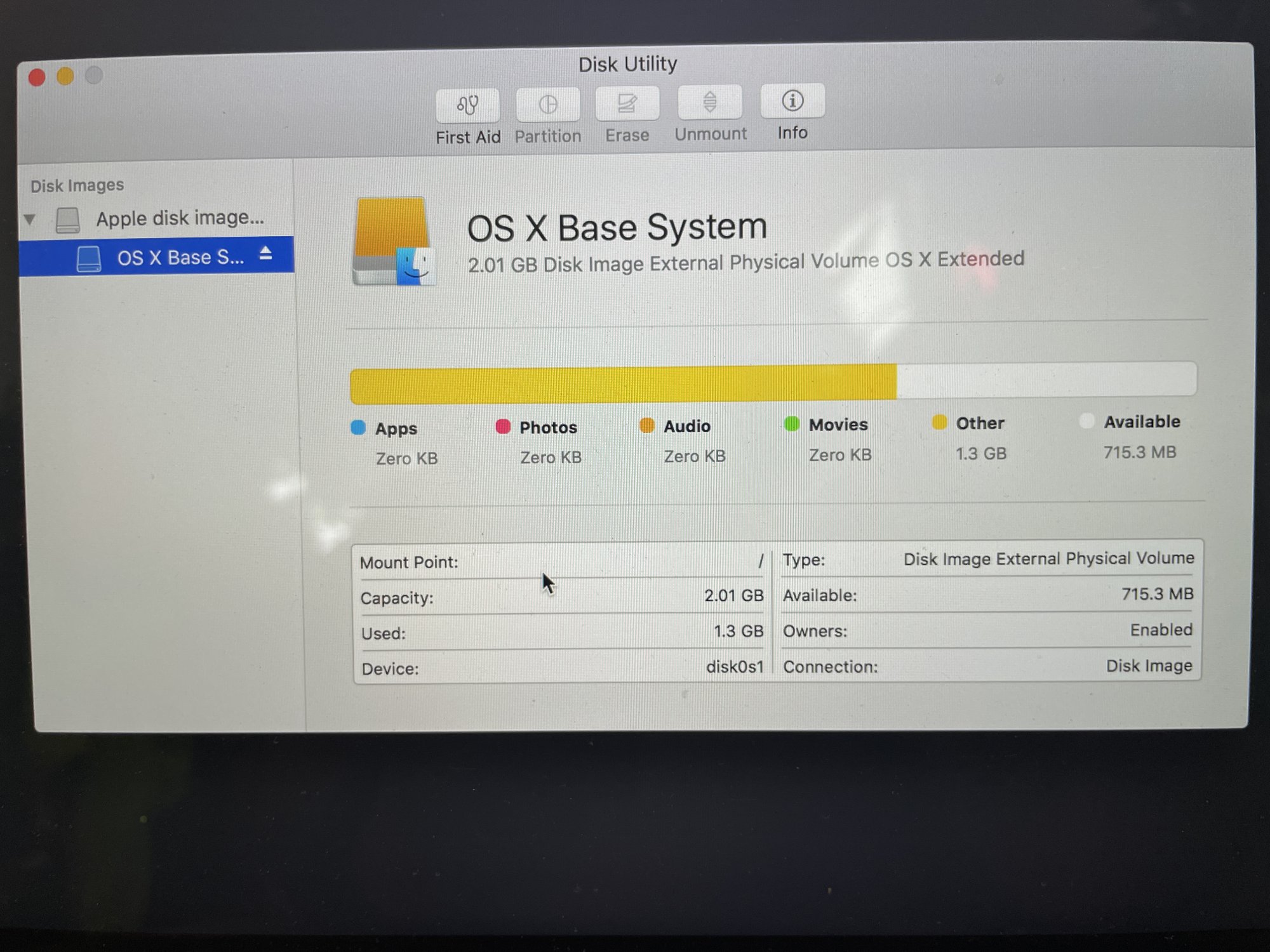

Same problem as above, and same 12" Macbook. I do use a stand with a fan since the battery expanded 2 years ago and it was replaced under applecare. But now it's so old, not under warranty. When I boot up, disk utility only shows 2GB, no other disk. I notice slight 1mm from the bottom casing, suggesting the battery expanding again in this summer heat which may have contributed to the damage.
Hoping repair doesn't cost more than $500 or else, this is a paper weight.
