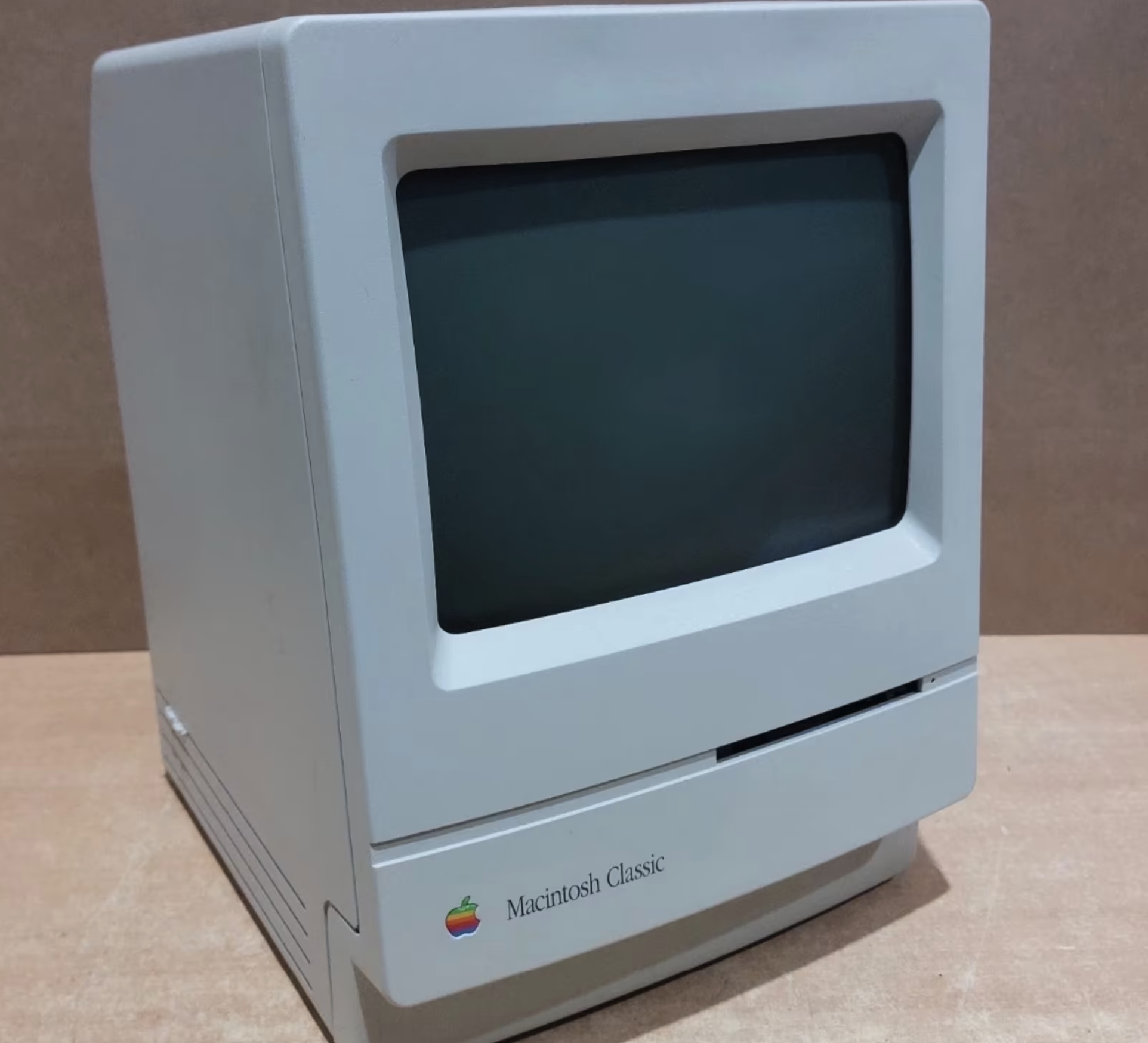

Macintosh Classic case

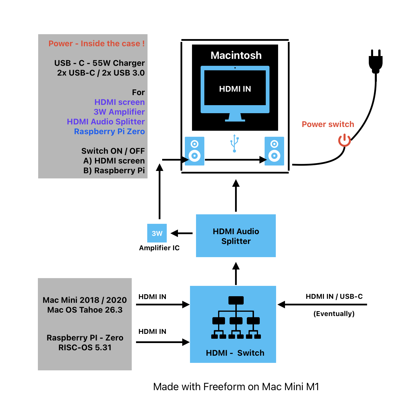

Schematics of my ideas.

these are at least some ideas for a Desktop conversation - you need 5V USB Power supply for IC and
screen - like HDMI screen / Raspberry Pi / separate ON/OFF switches / HDMI Splitter and Amplifier.

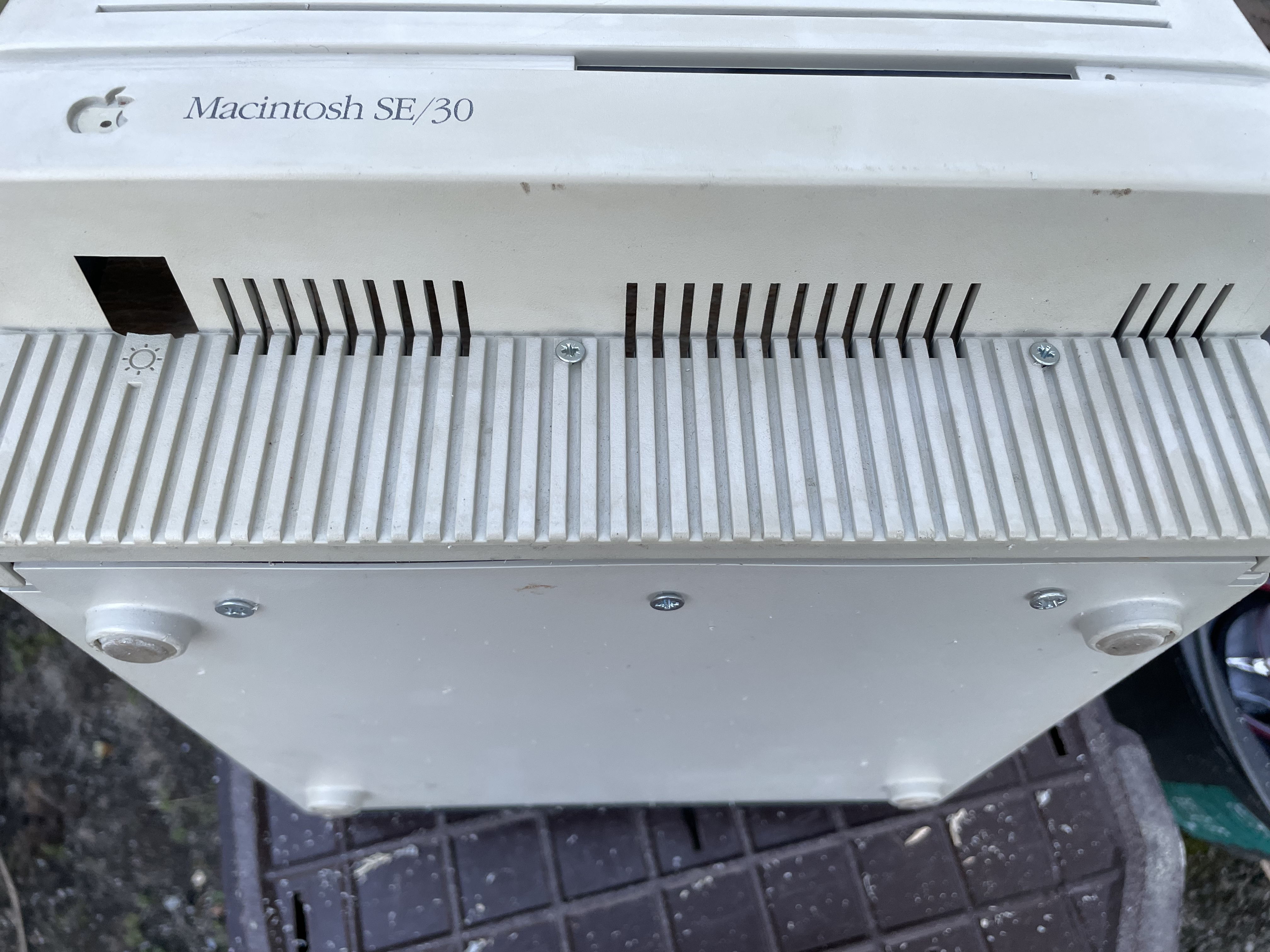

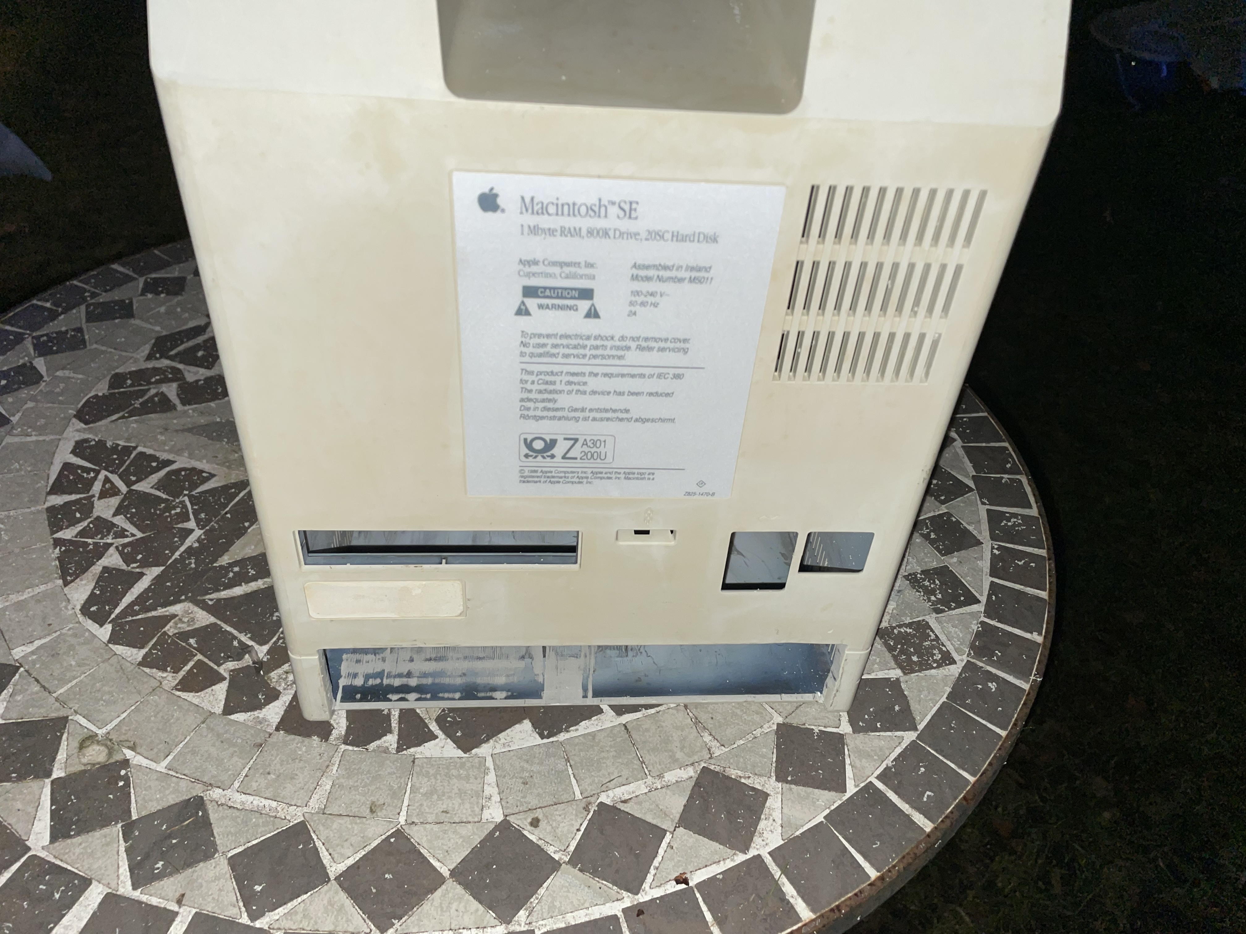

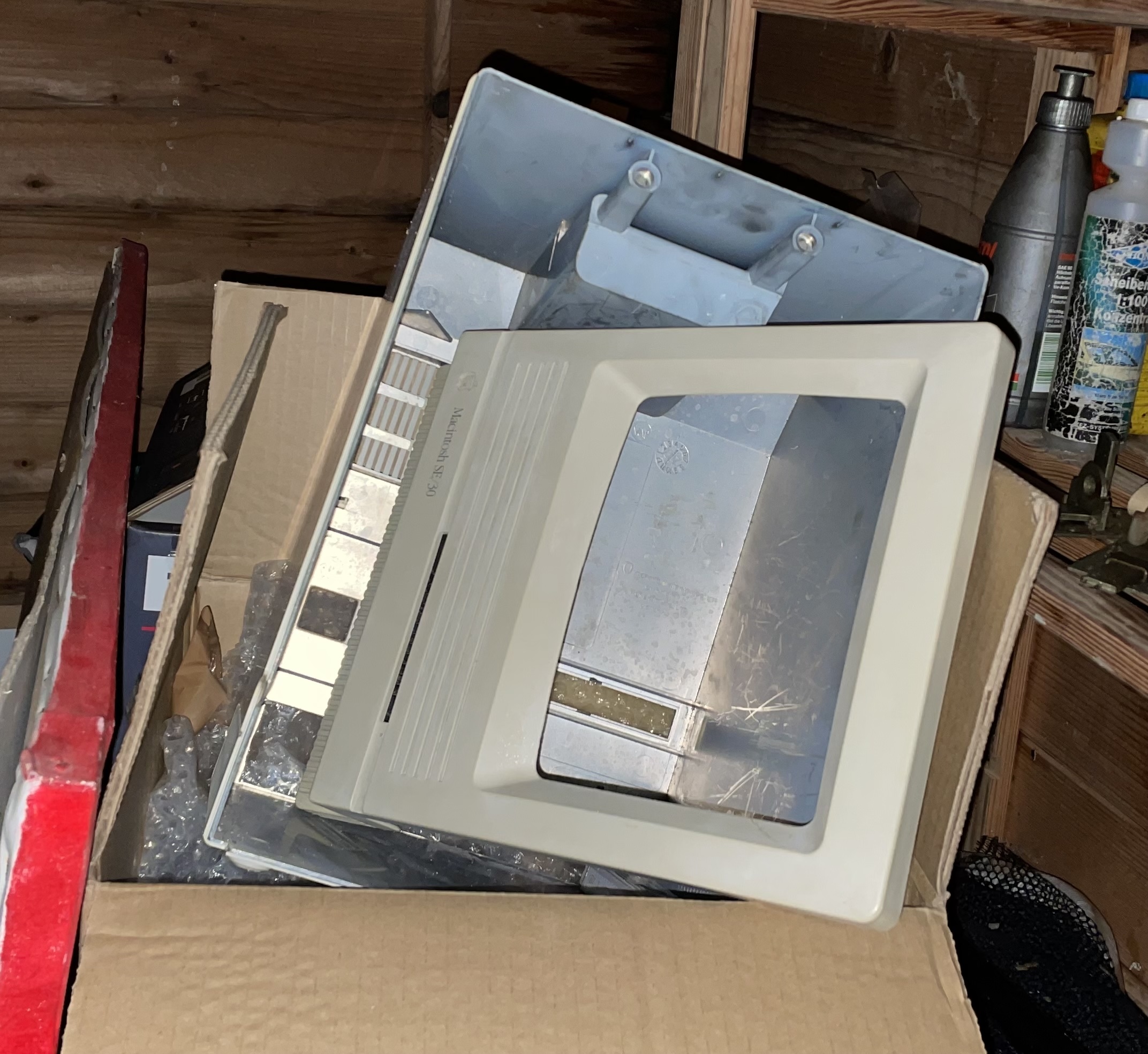

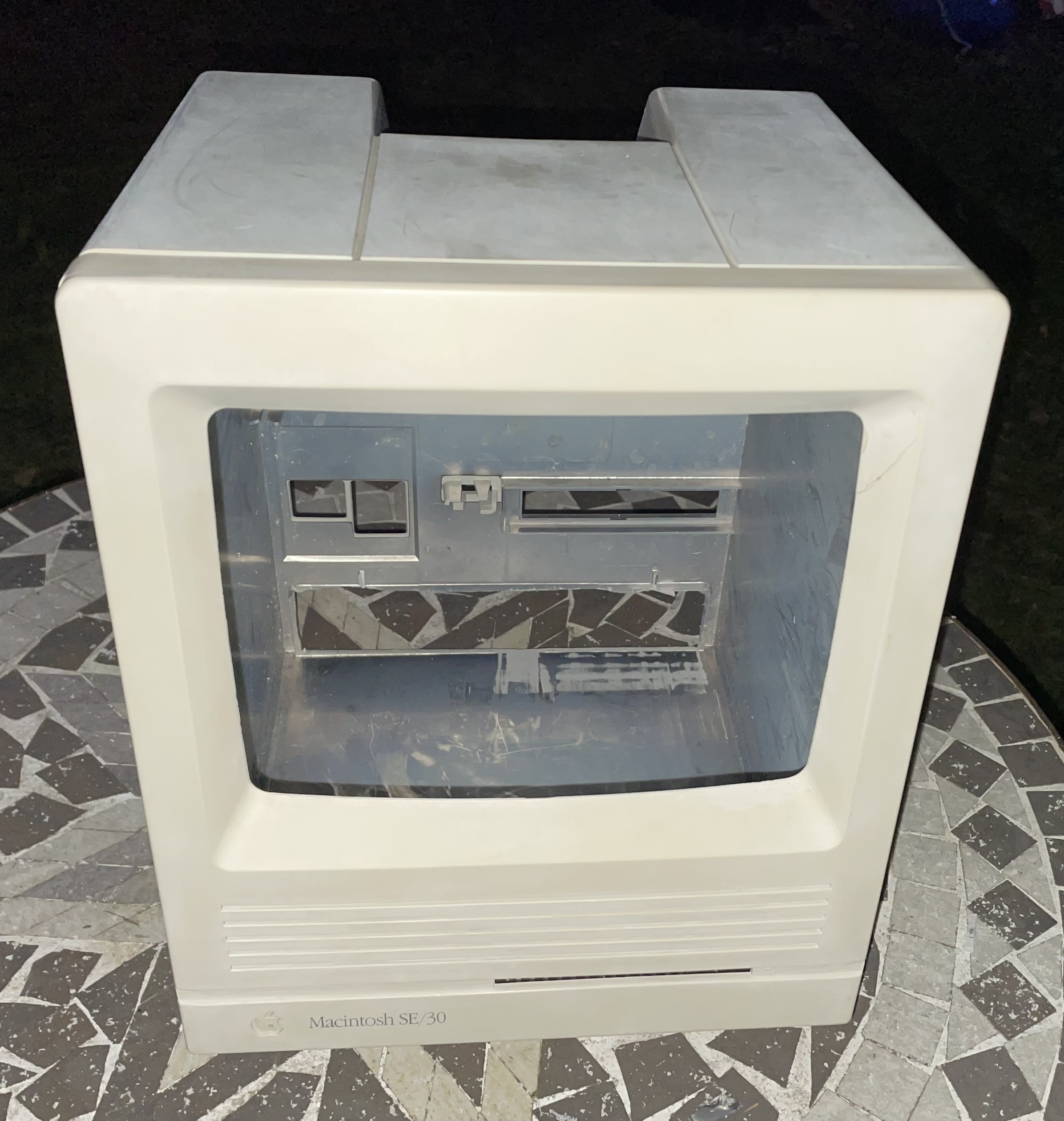

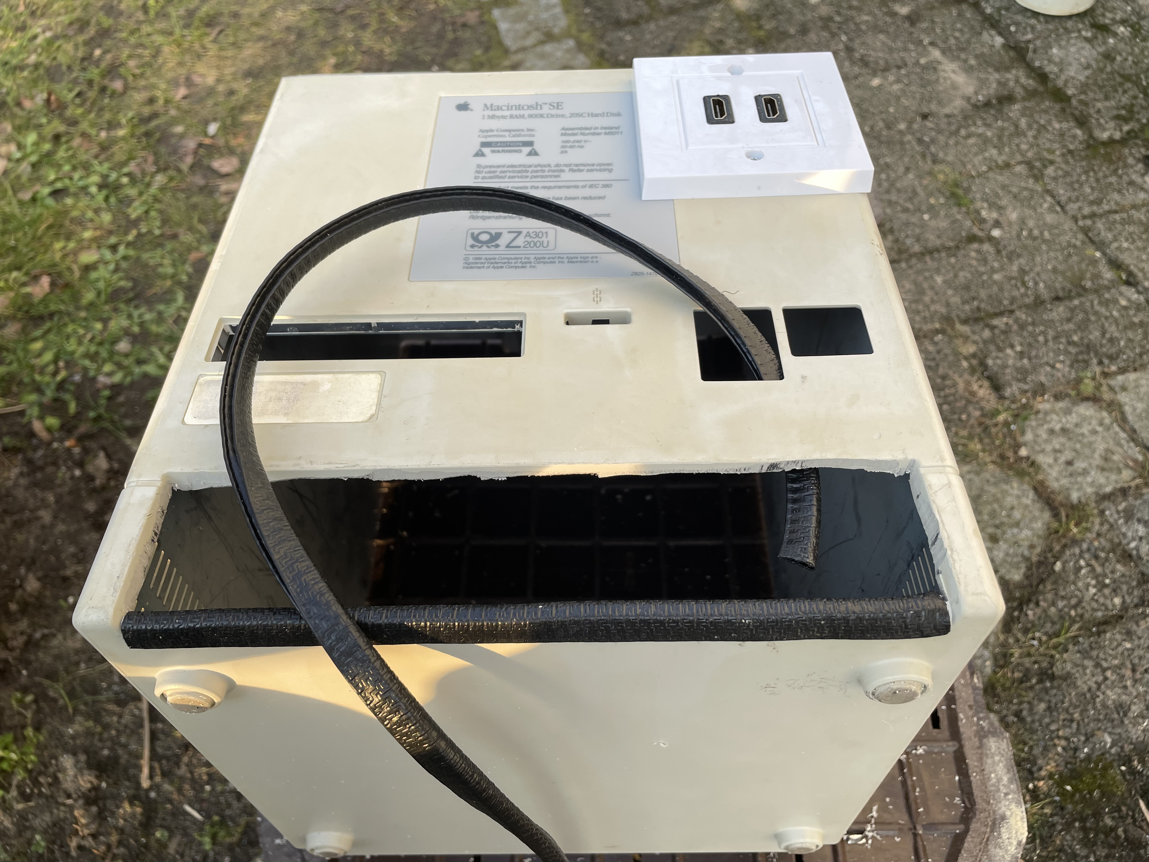

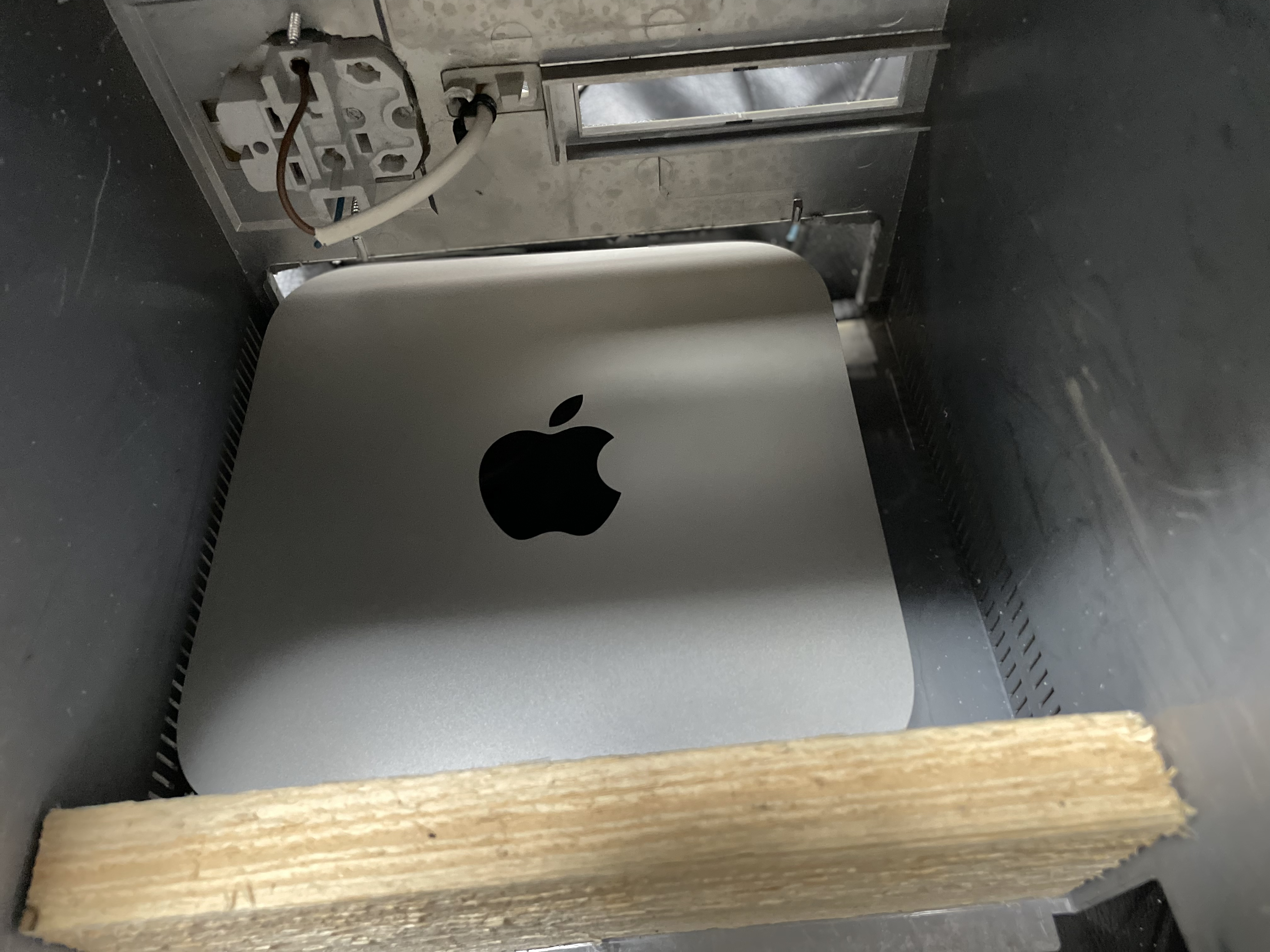

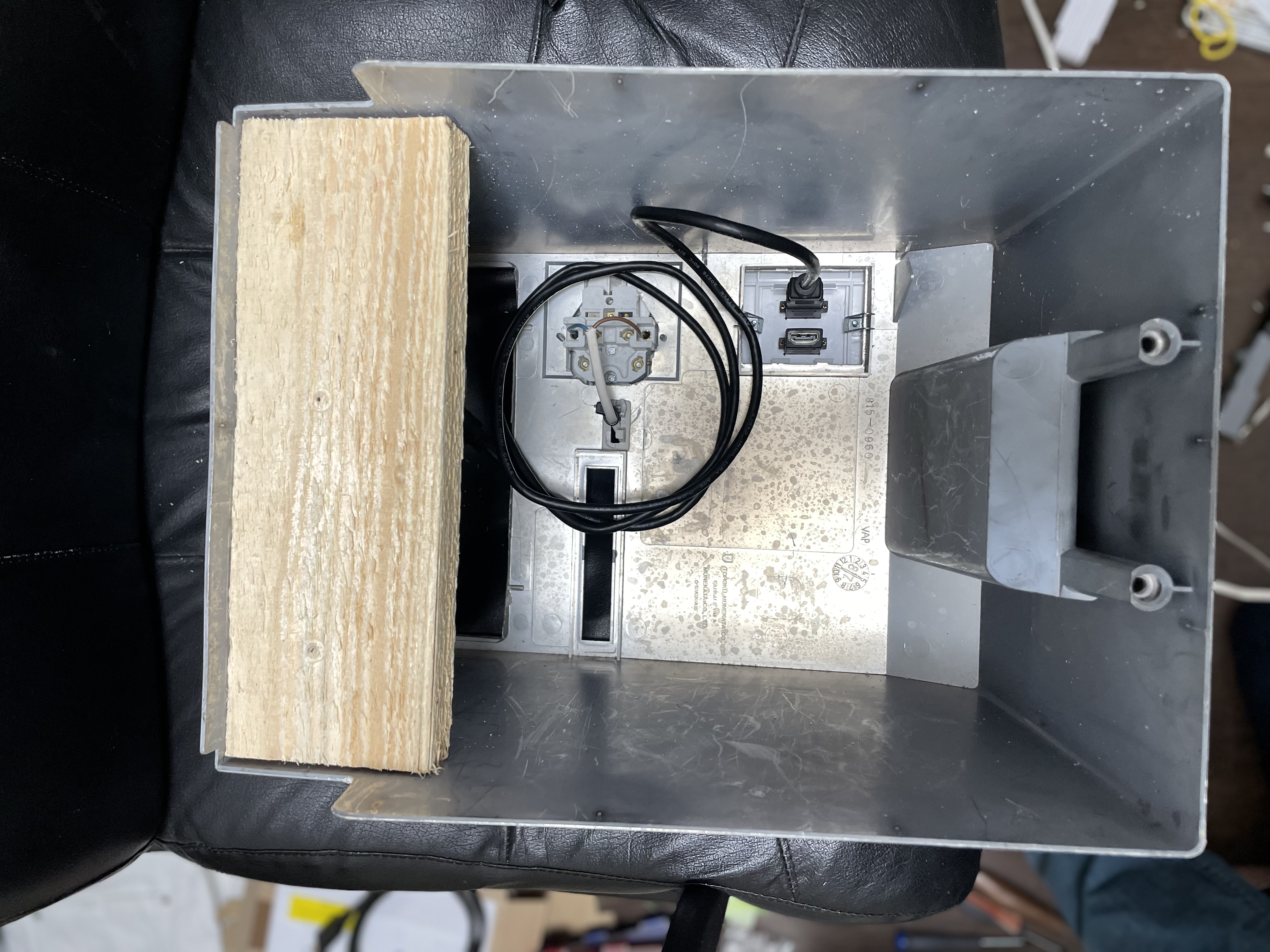

Arrival of the two 40 y.o. cases (one complete but defected)

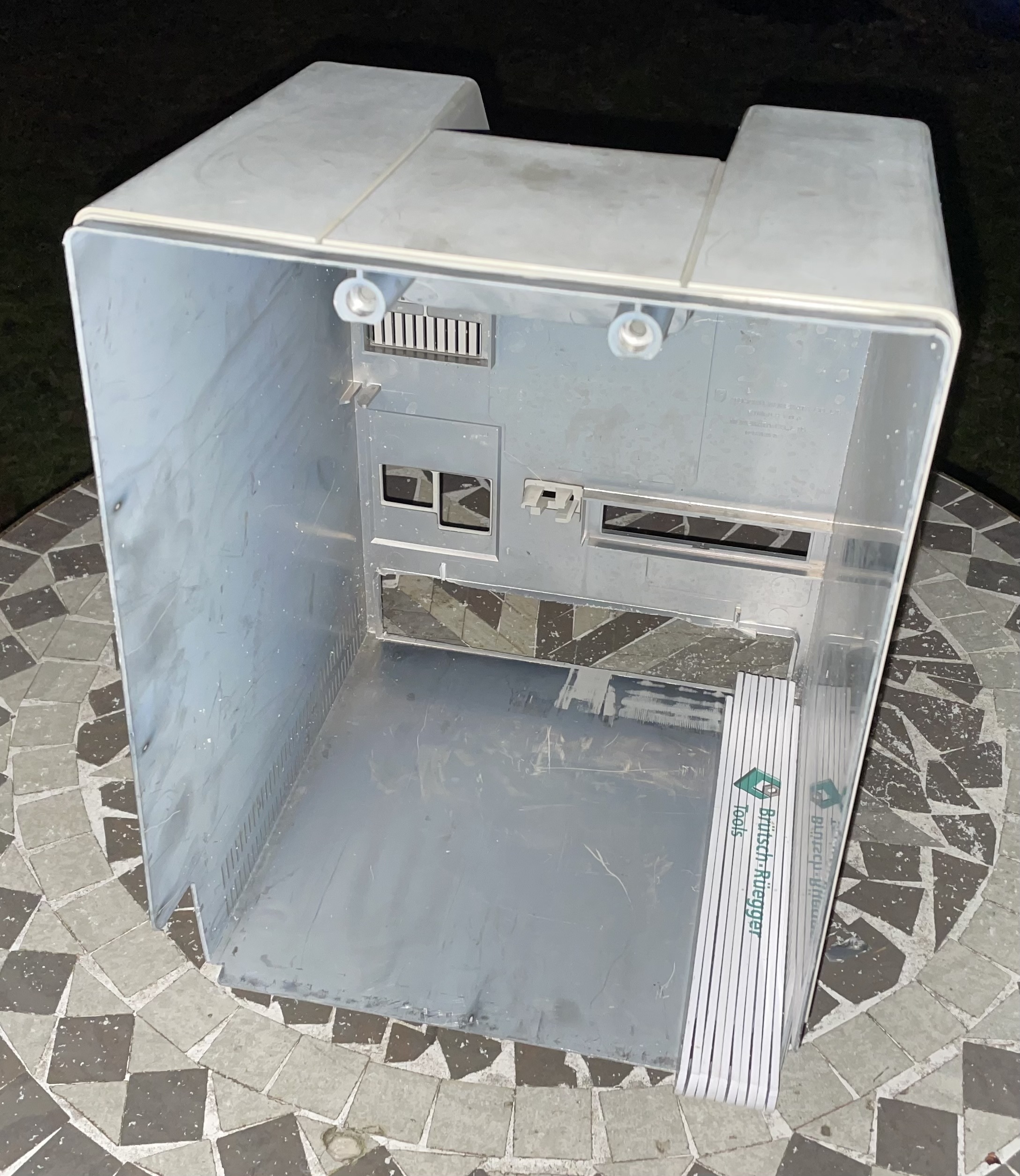

...only case (without metal frame inside)
...you can close the openings on the back with Sheet metal + rivets or screws.
...cut out the lower plug-in for the Mac Mini
2nd Macintosh (complete, defected power supply, I believe)

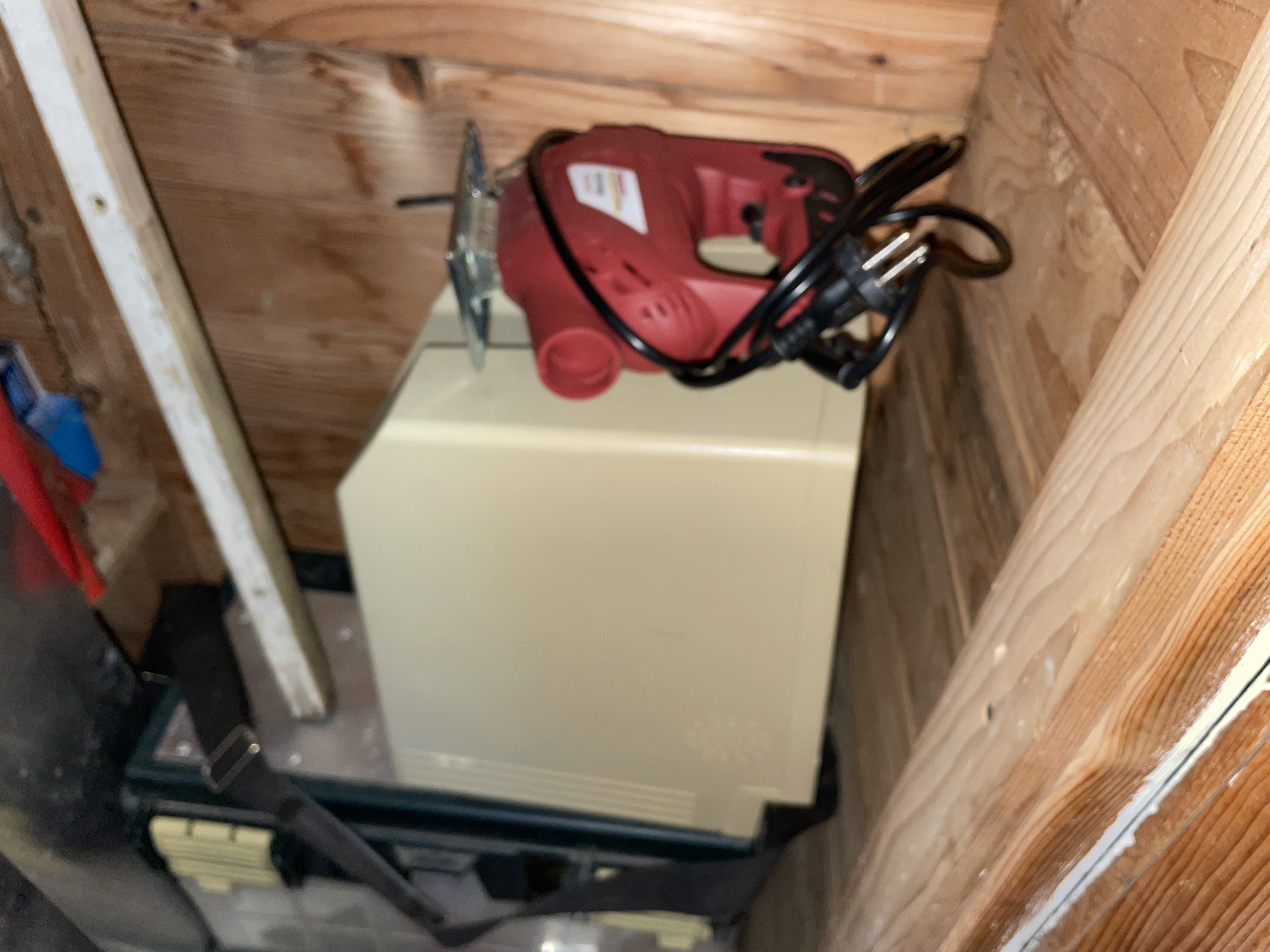

The housing are both in bad condition, the complete Mac (last picture) is more
yellow than the separate case, but I began to saw out the bottom position (for
the Mac Mini) with a jigsaw, but unfortunately it's already getting dark here...
To disassemble the other one (last picture), it takes time 'cause I must wait
for further spare parts and I only ordered one HDMI-Display first - it is not
possible to convert two Macintosh computers to a HDMI display at the same
time, I start with one case...
It's difficult to get :apple: cheap Macintosh housings on ebay or Kijiji 😬 and the
whole MOD-process should be cost more that I believe when I began...
Work in progress...

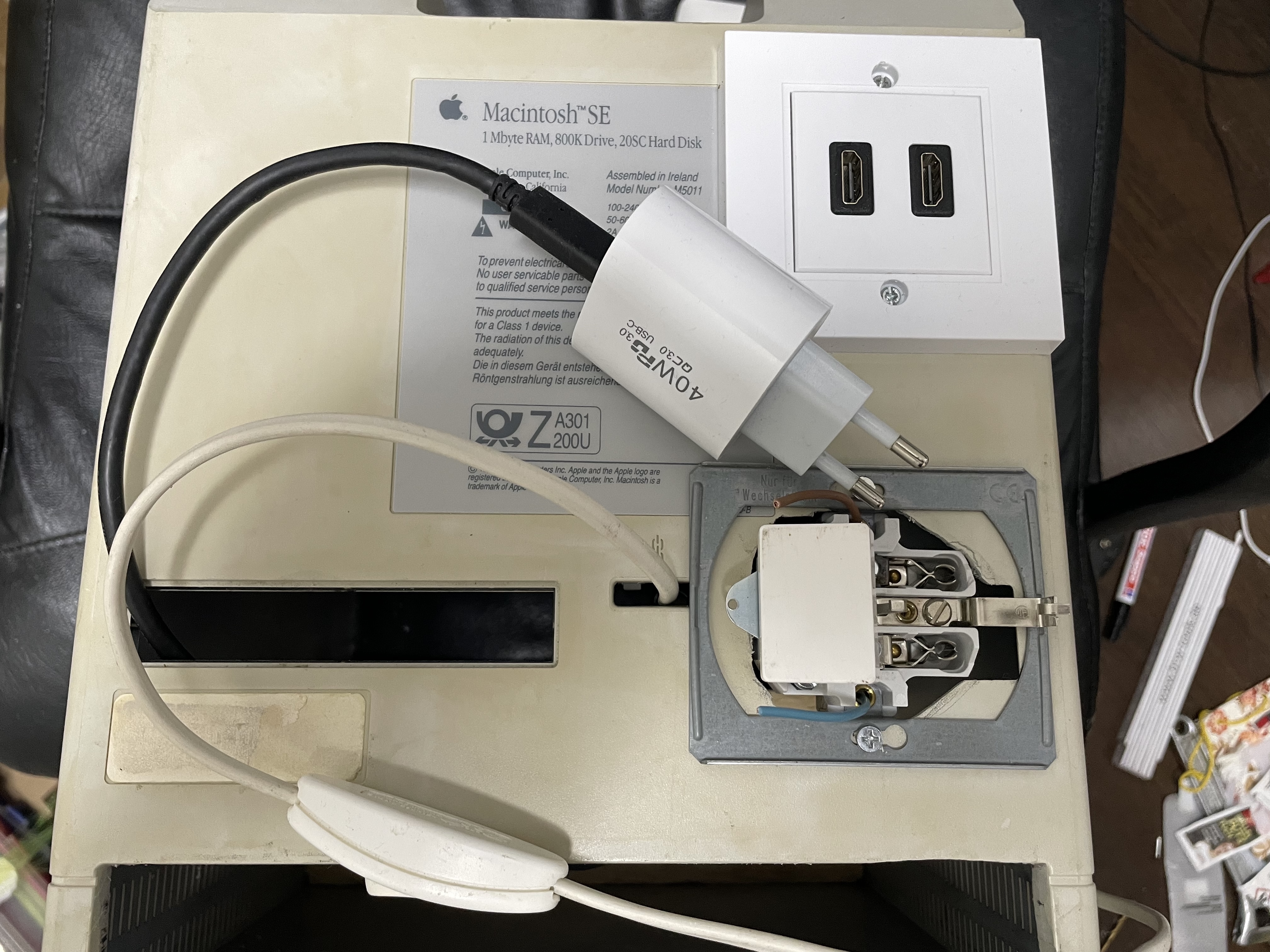

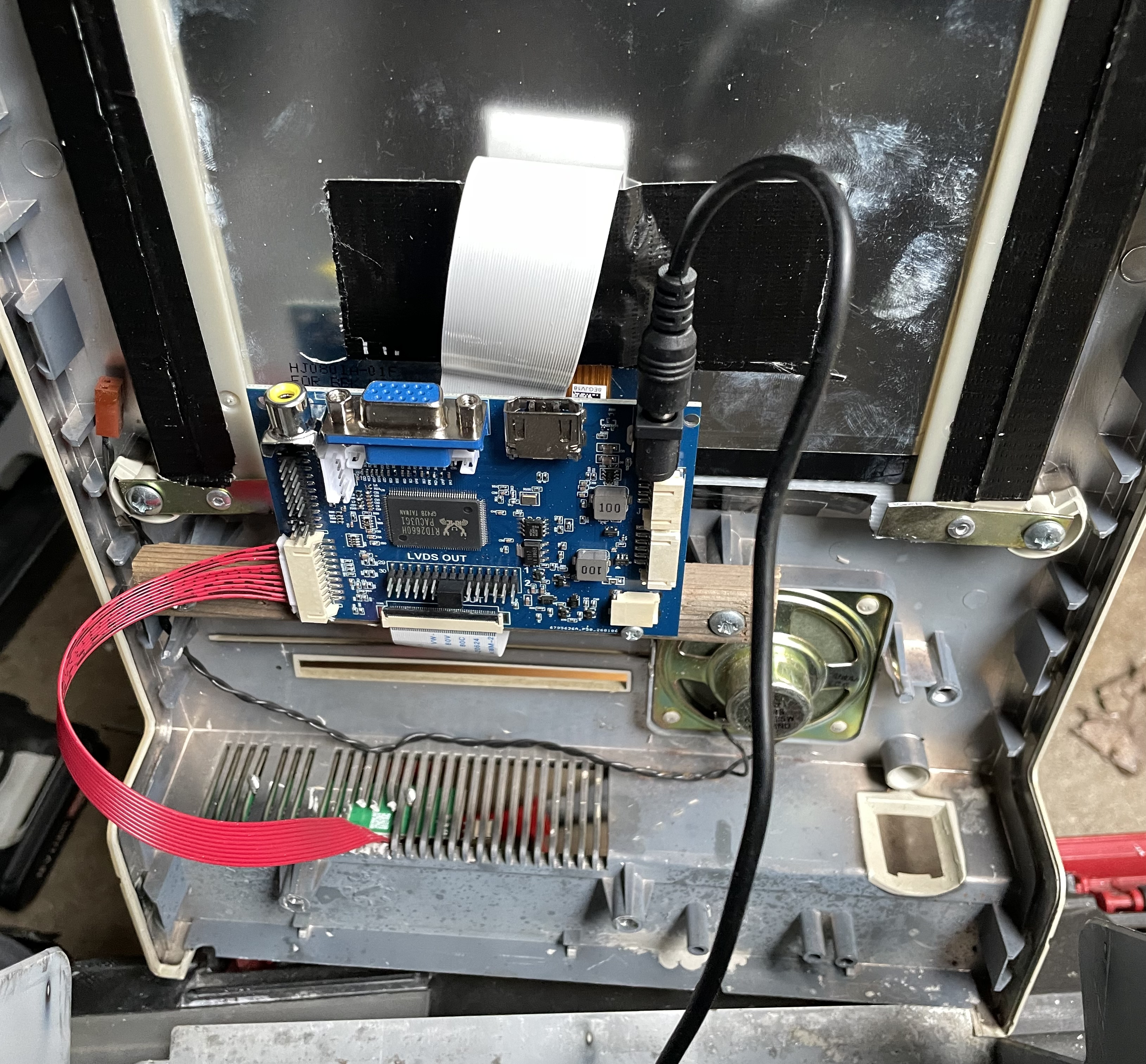

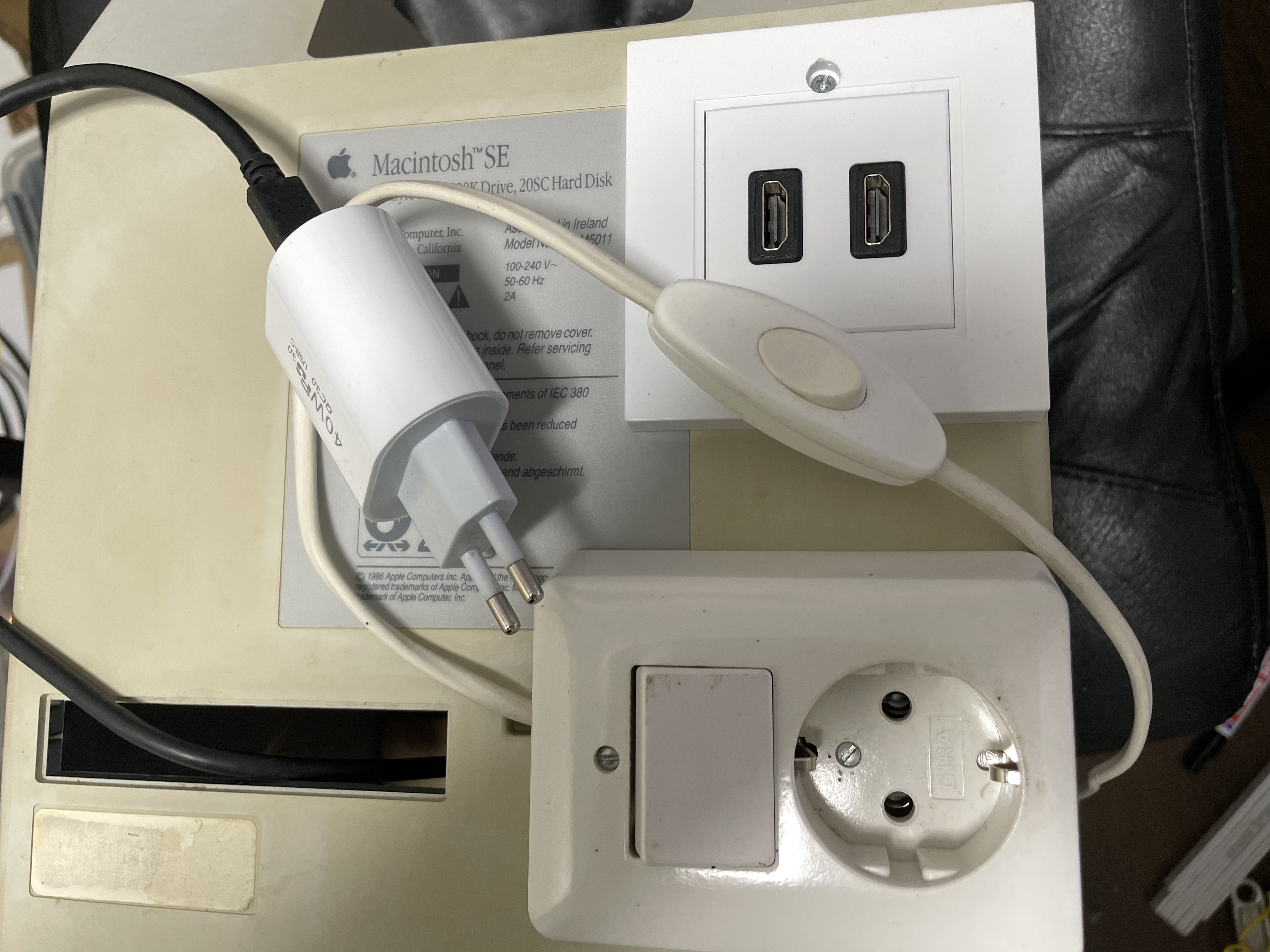

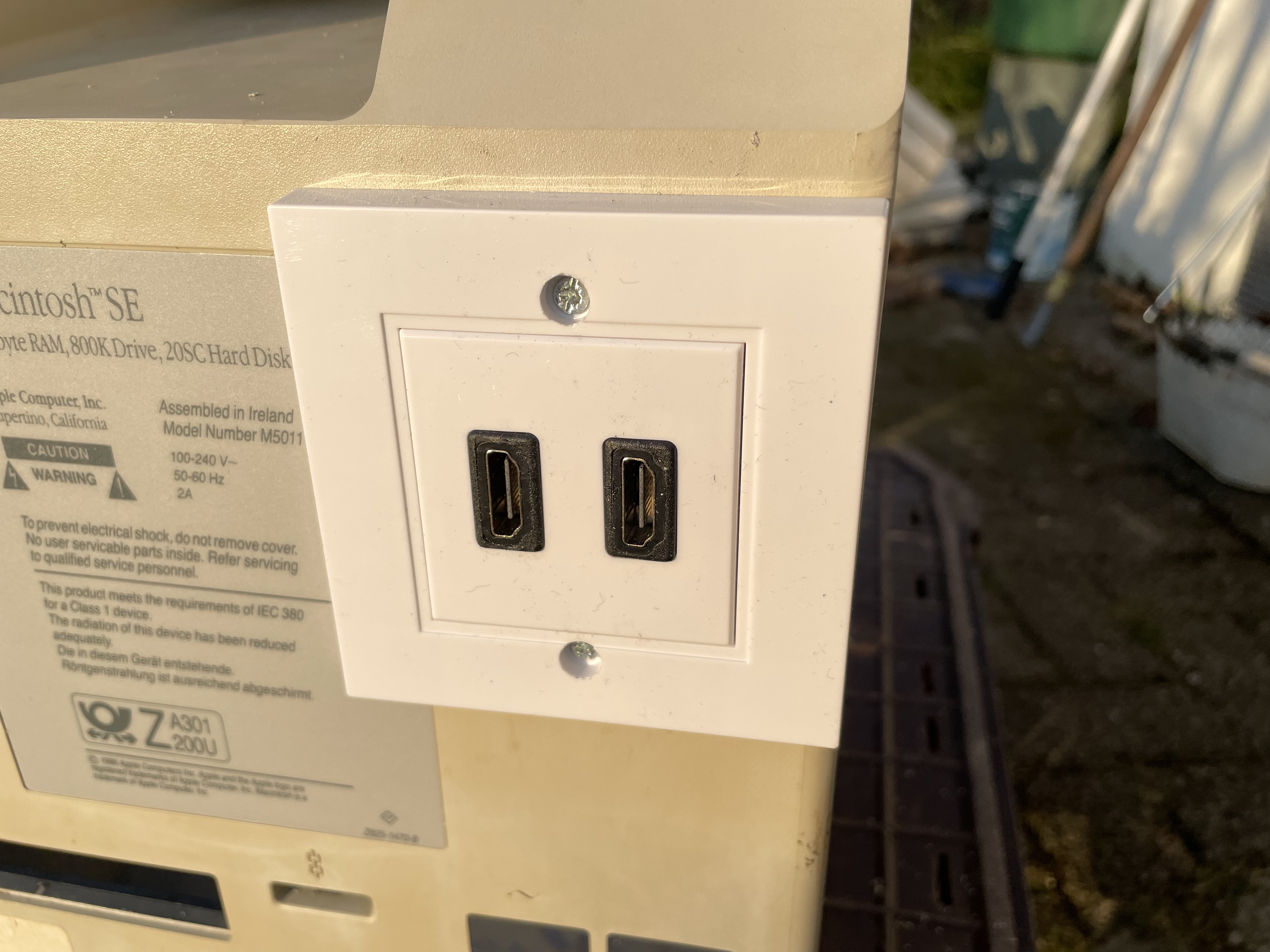

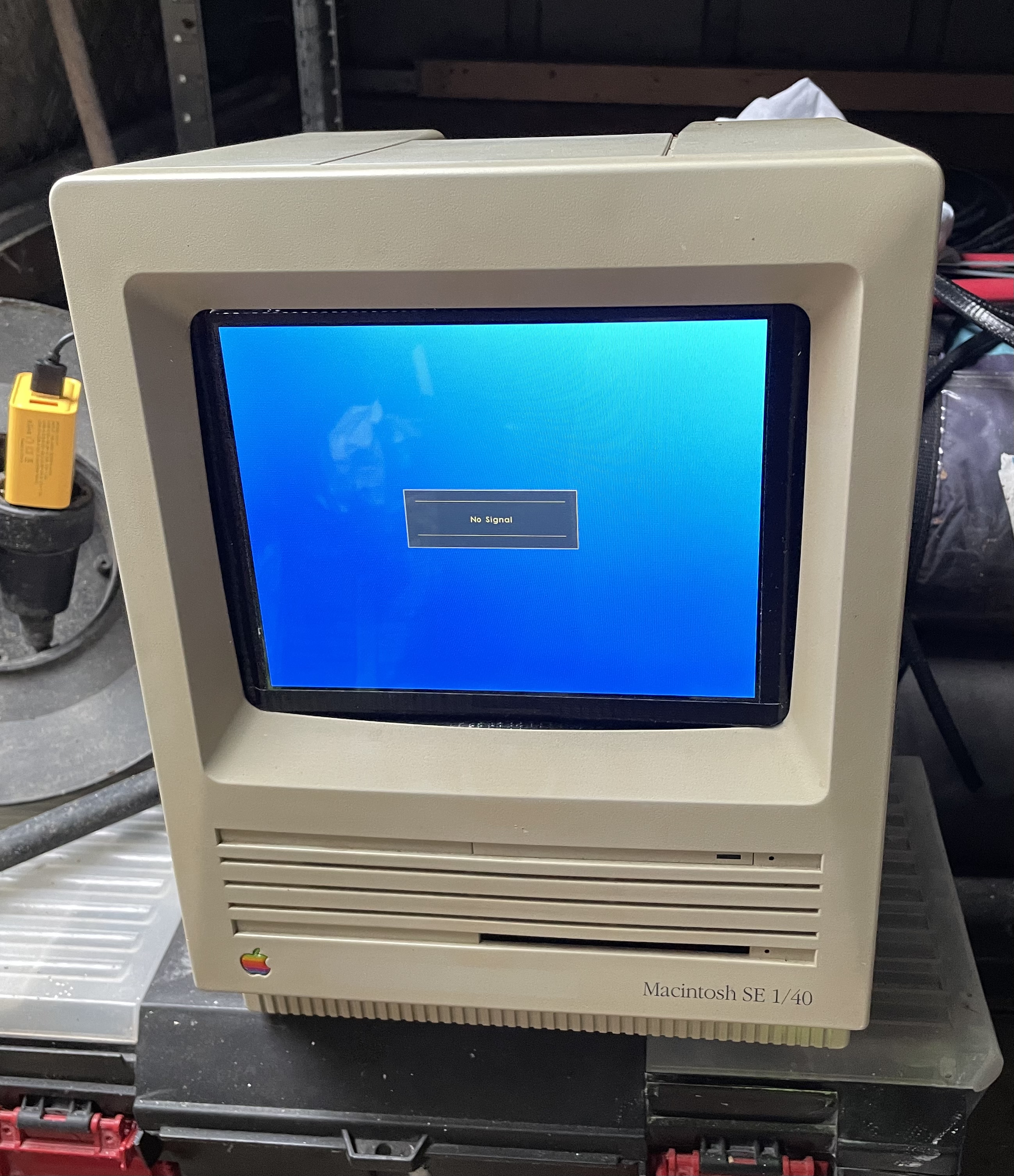

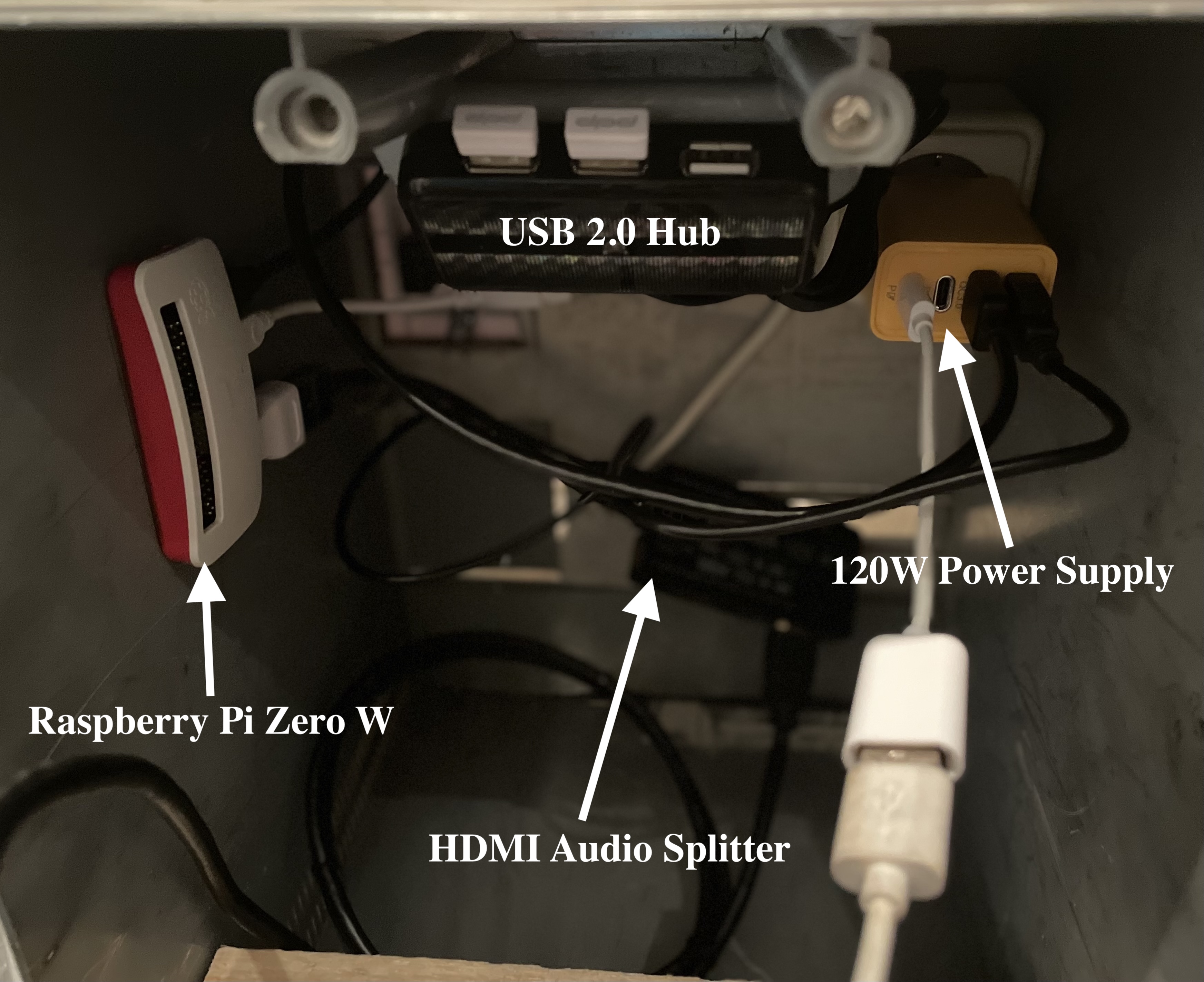

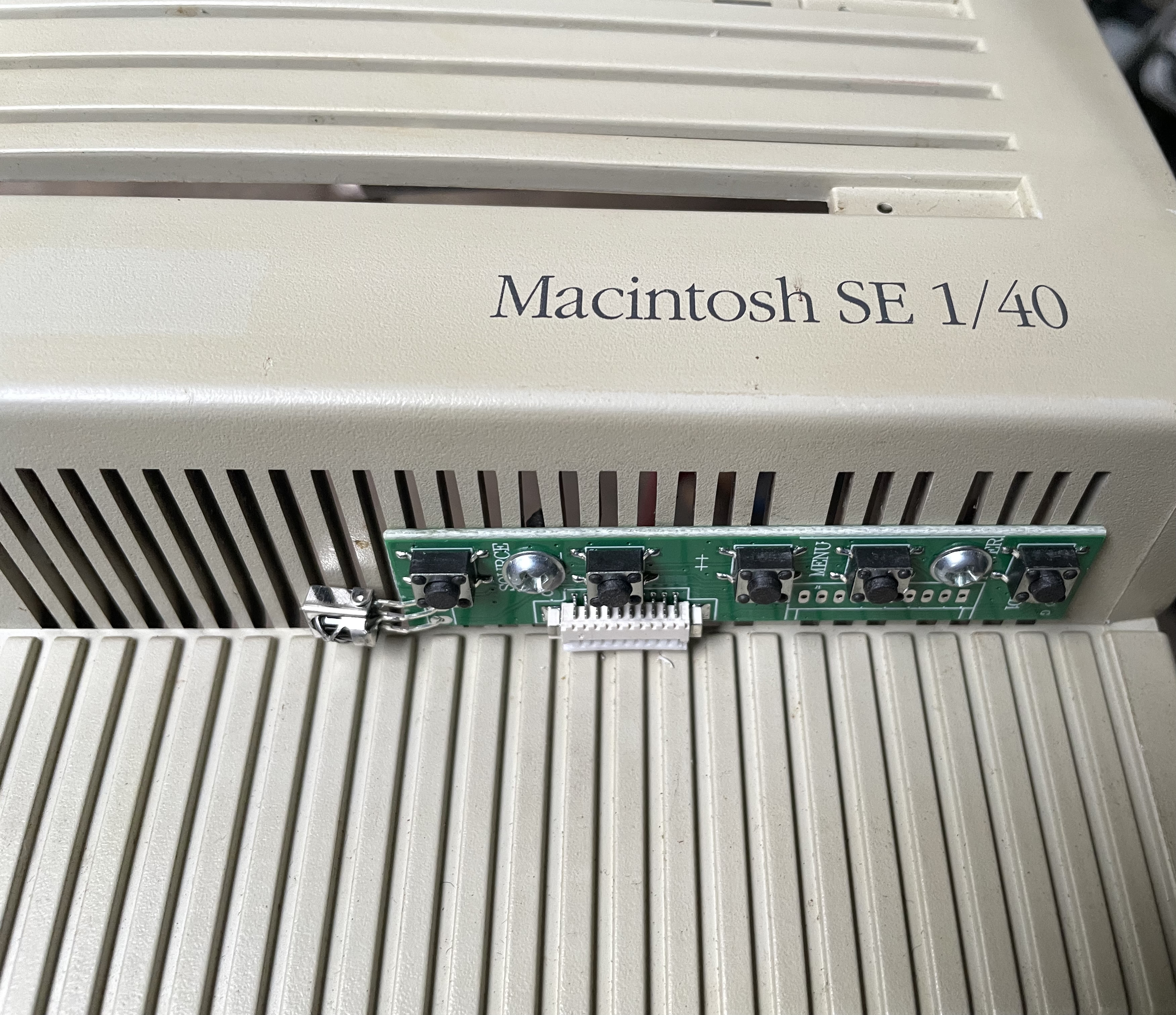

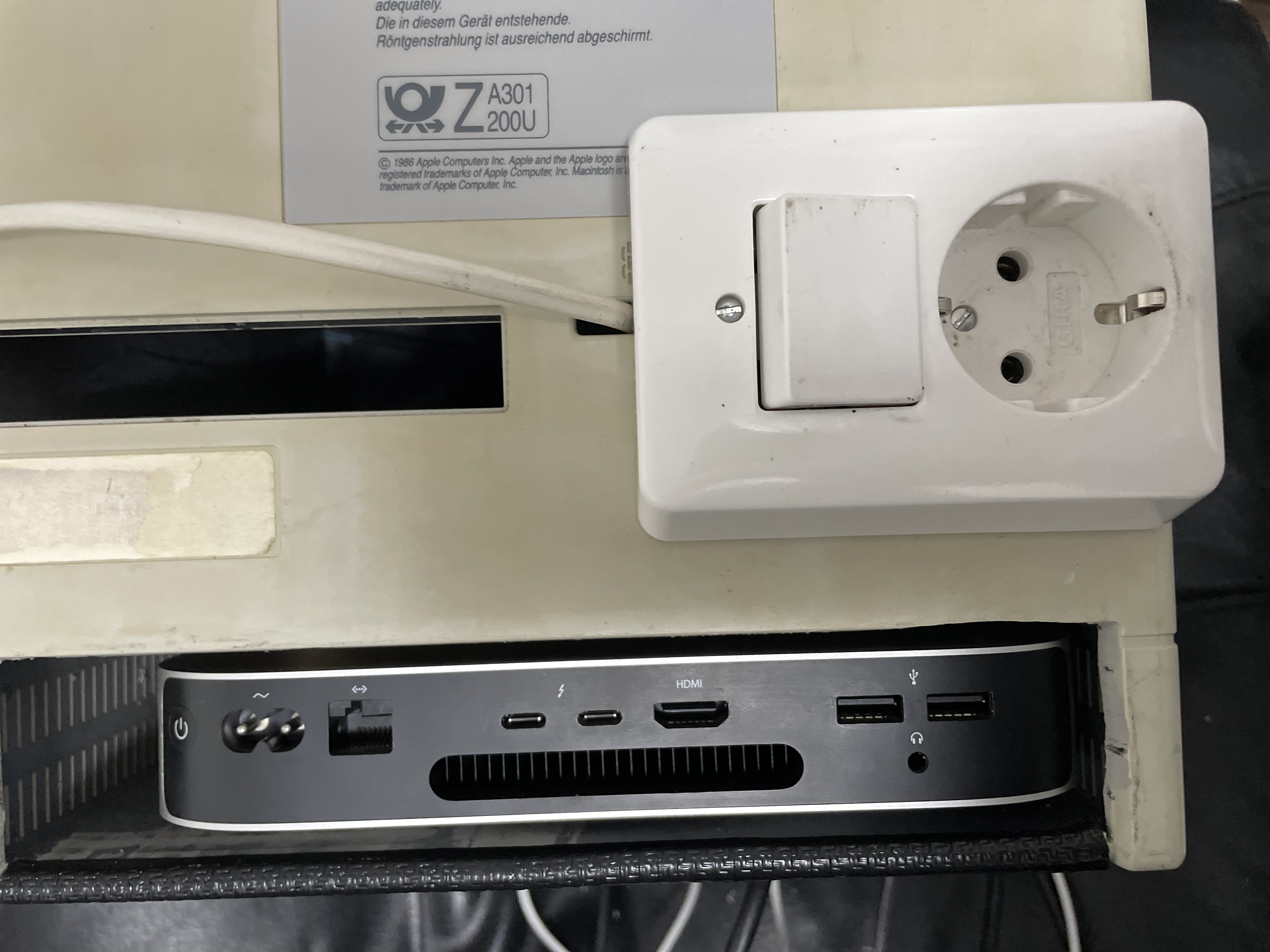

after getting a few cables, Splitters, the 8" HDMI screen and a few other components
I start with a Macintosh case in a bad condition to build up a first HDMI screen +++

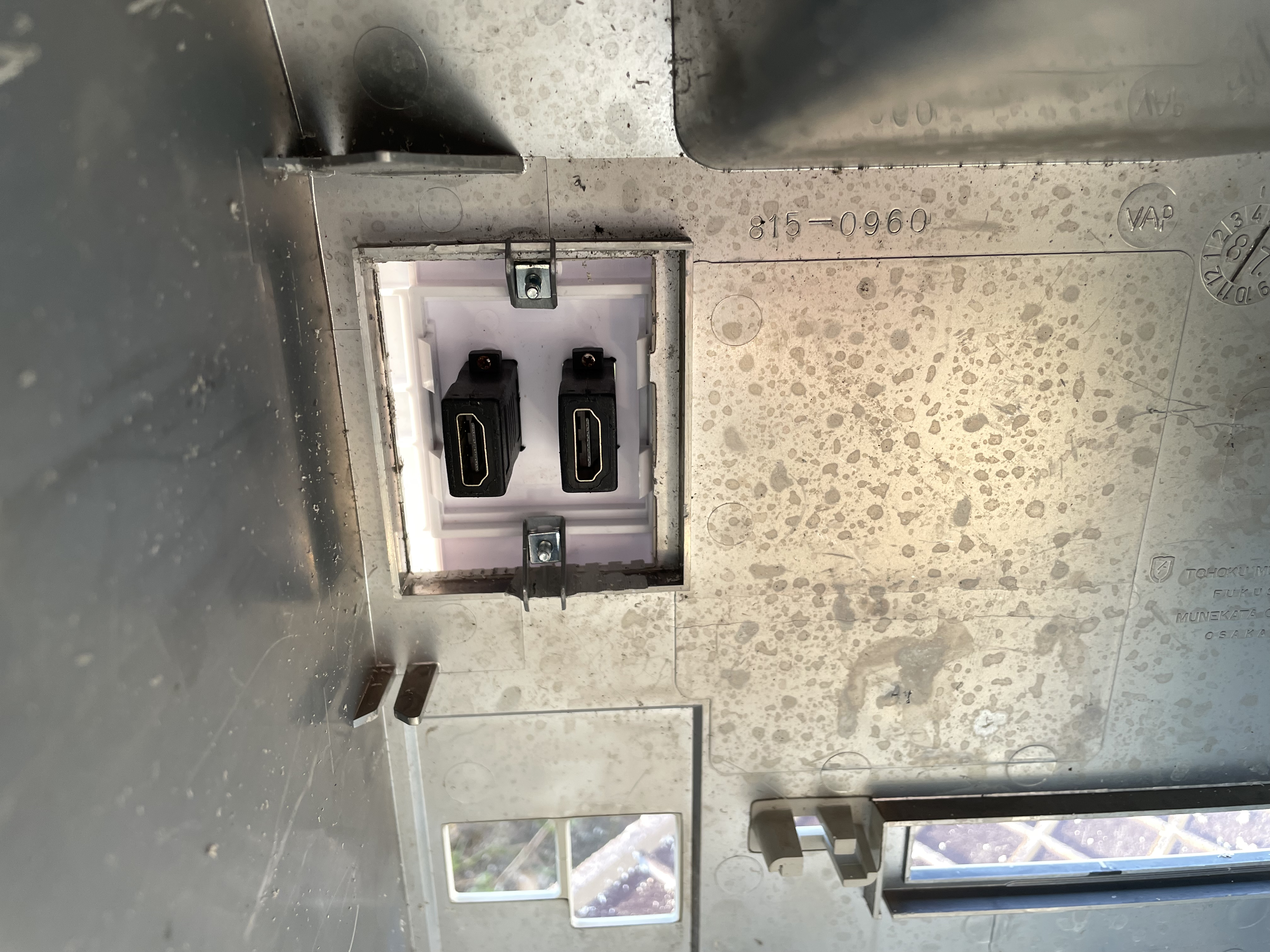

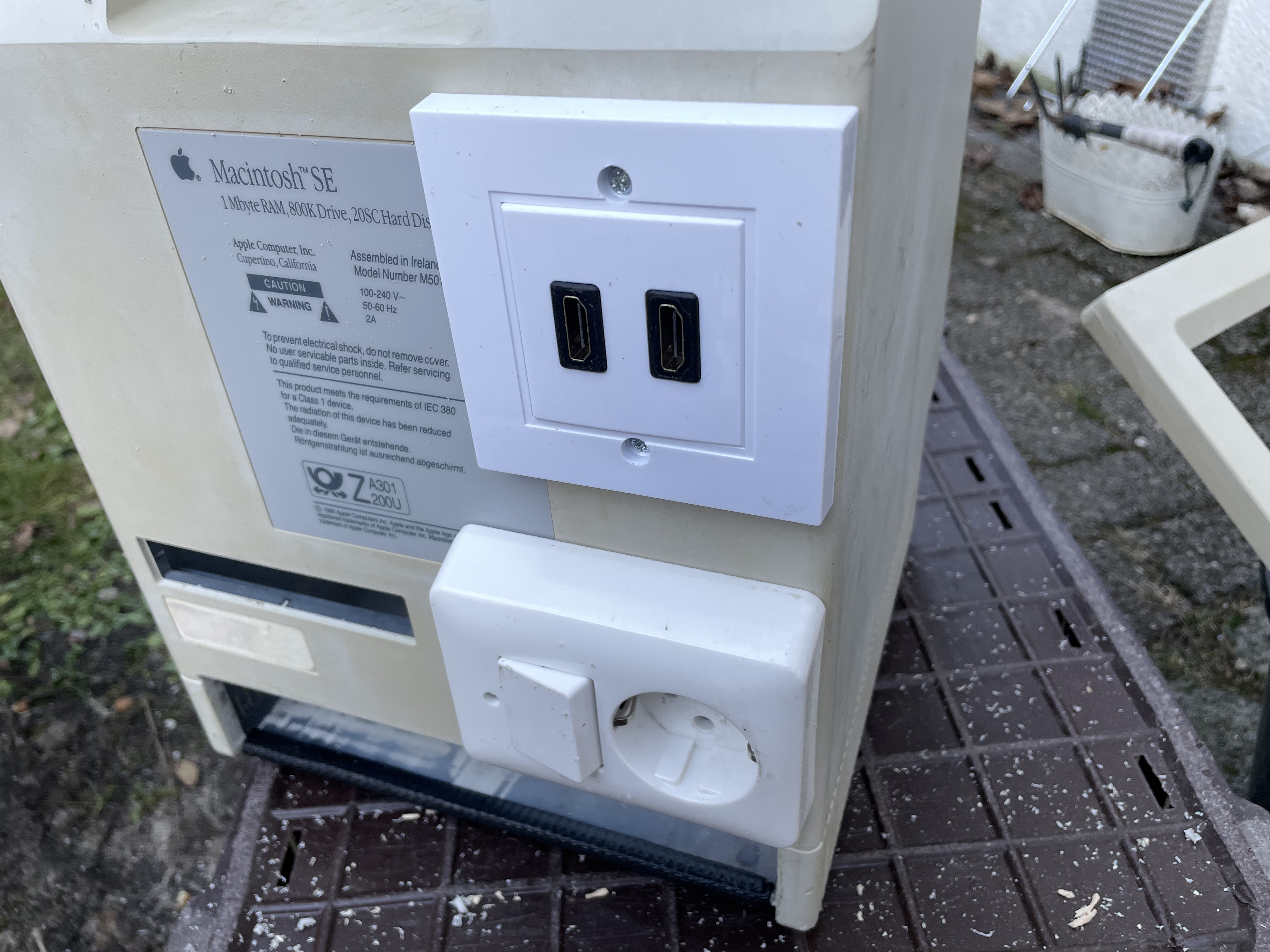

HDMI Line-through-socket ...ports with wallmount
HDMI inside (one port in to HDMI screen / one port out from Splitter)
Edge protection from the car industry...
Wallmount Power Supply plug (switchable, almost without cable) + HDMI
Reactions: Amethyst1

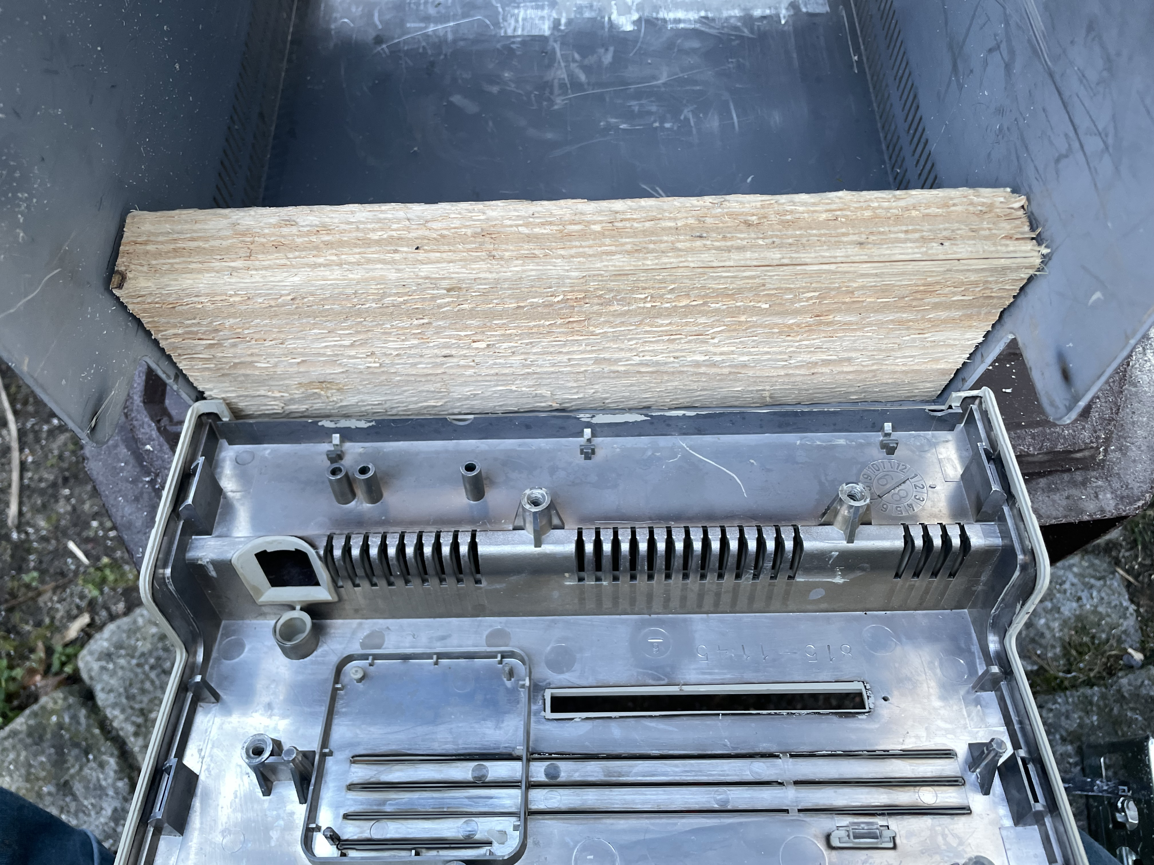

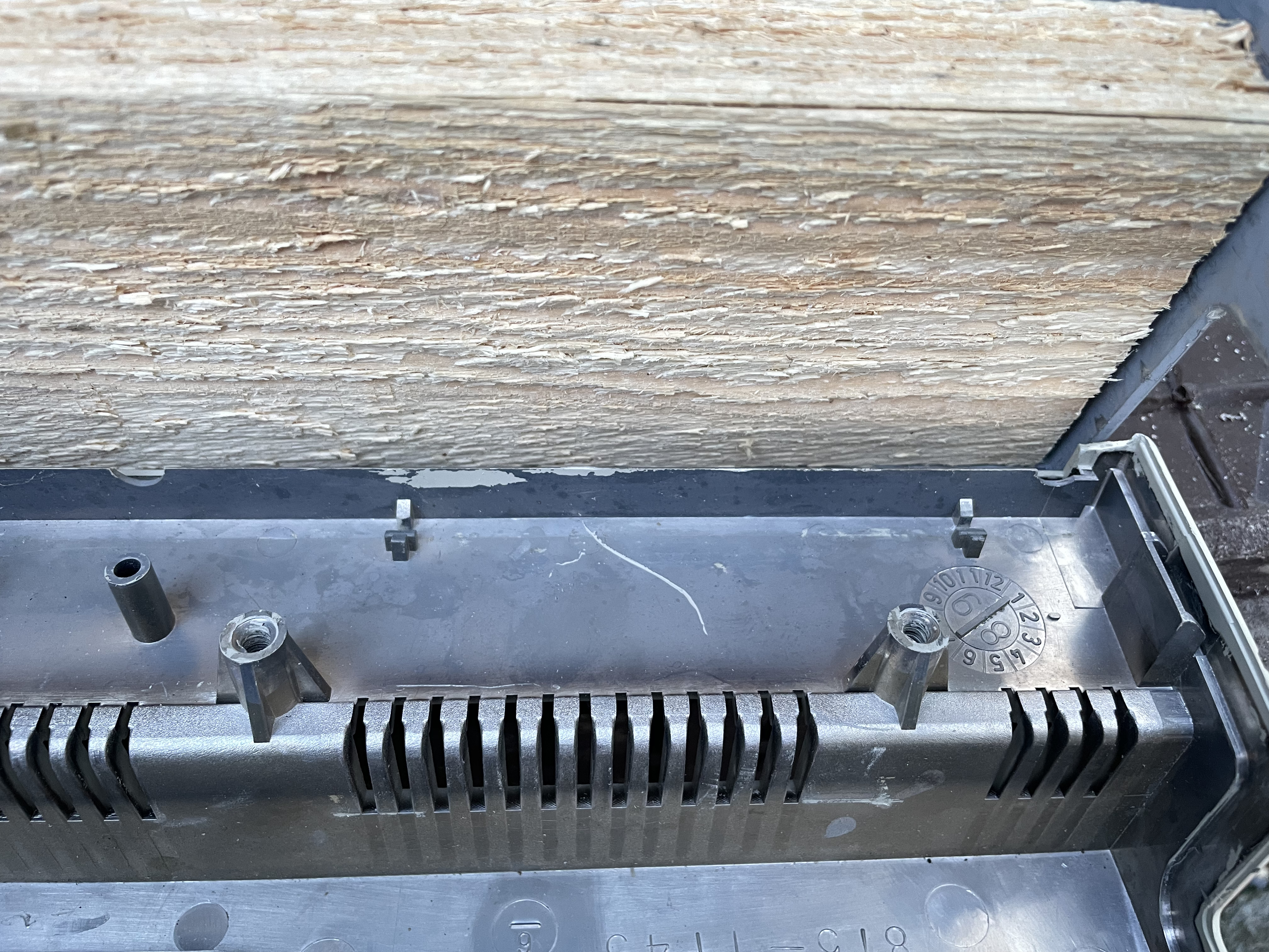

- part 2 (Fix the Front Bezel without inner metal frame)
...not finished yet !
(look at the wooden board, it looks like stonehenge and take an additional
look at the position of the screws, you drill holes from inside to outside and
use this holes for the screws to fix the front bezel to the back case).

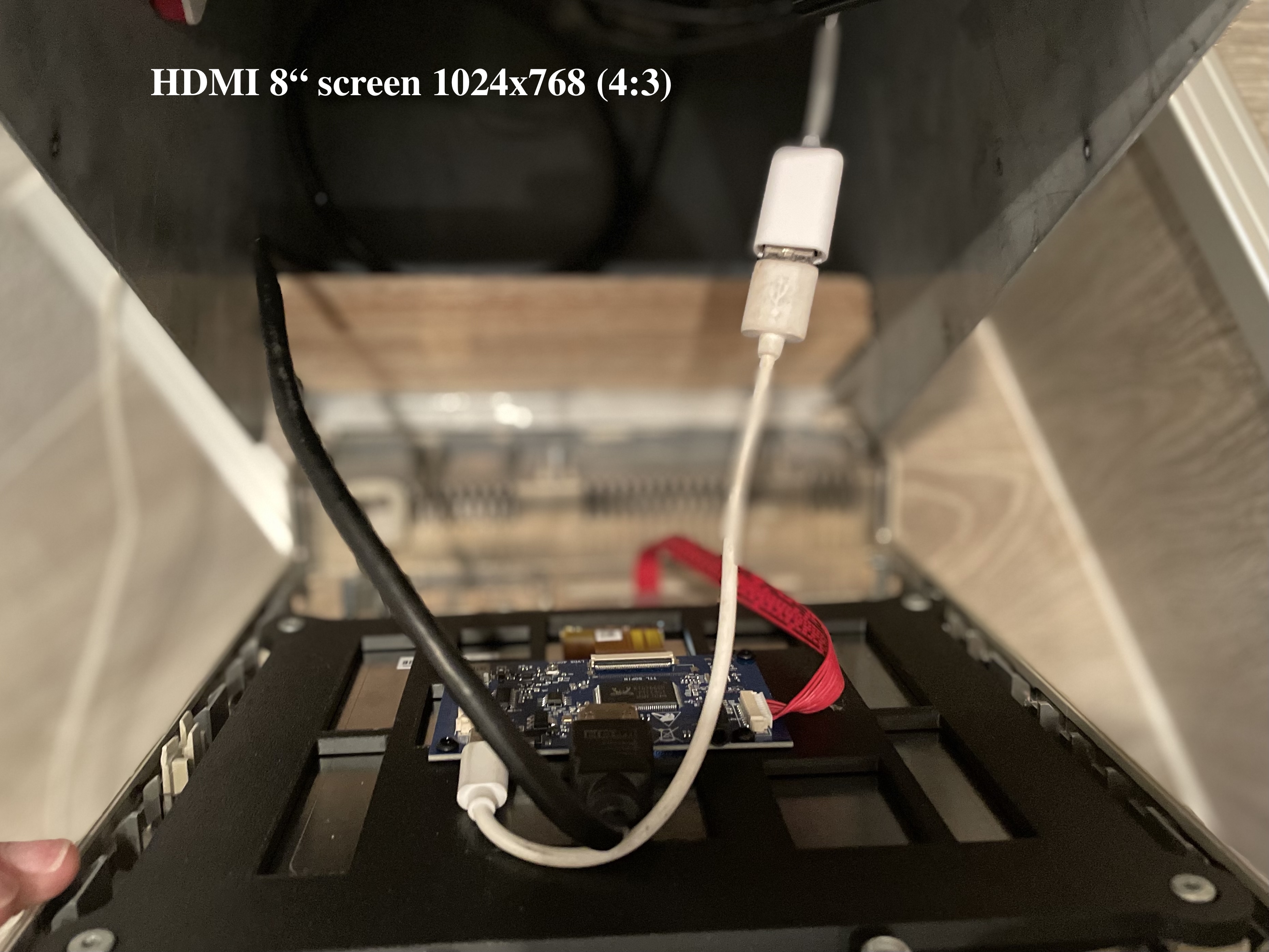

Electric installation (so far) 🤭 - it's not possible to use
a small powered 40W USB-C Socket plug power supply,
...take a PD (Power delivery) up to 100W for the Display

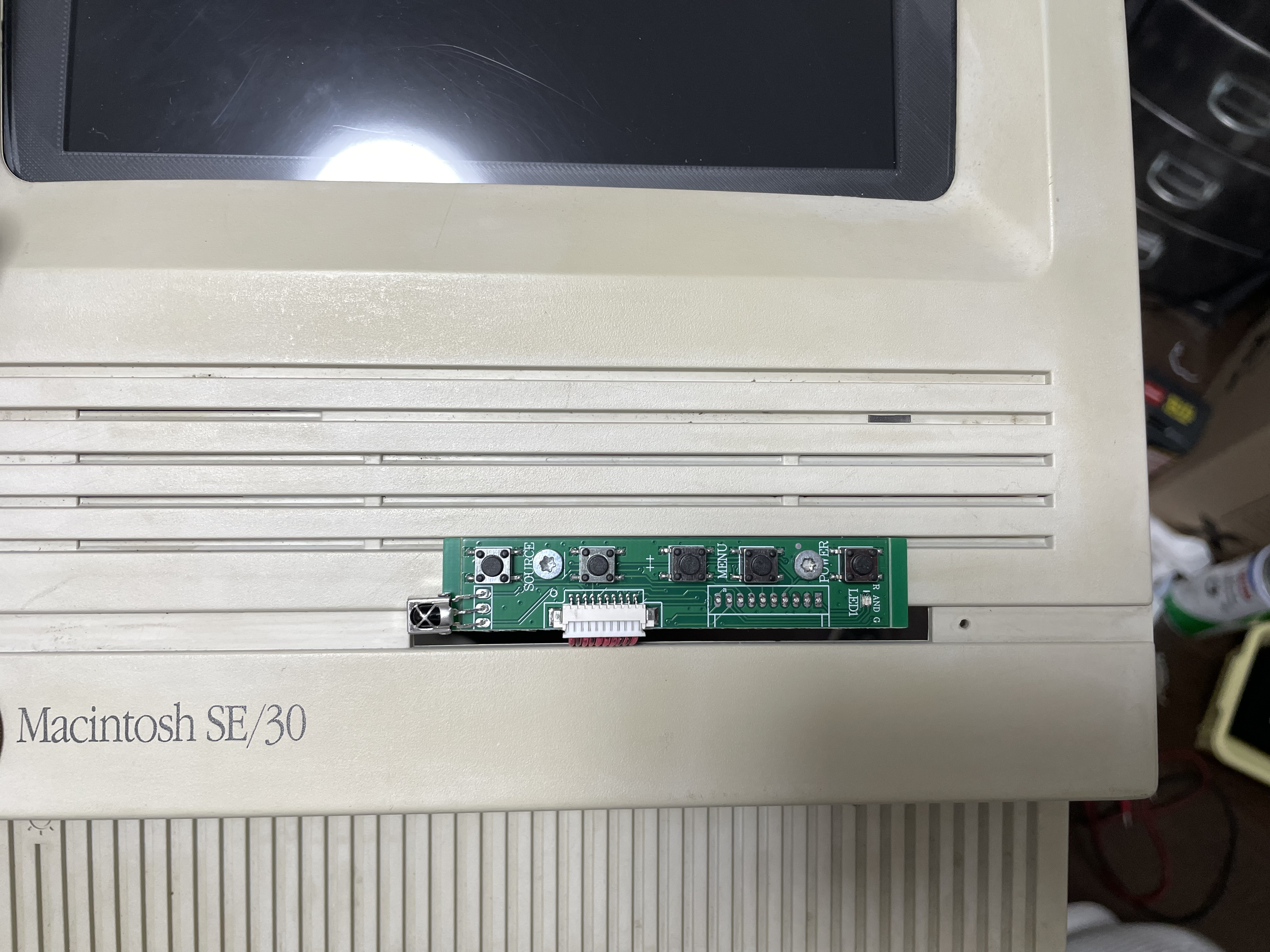

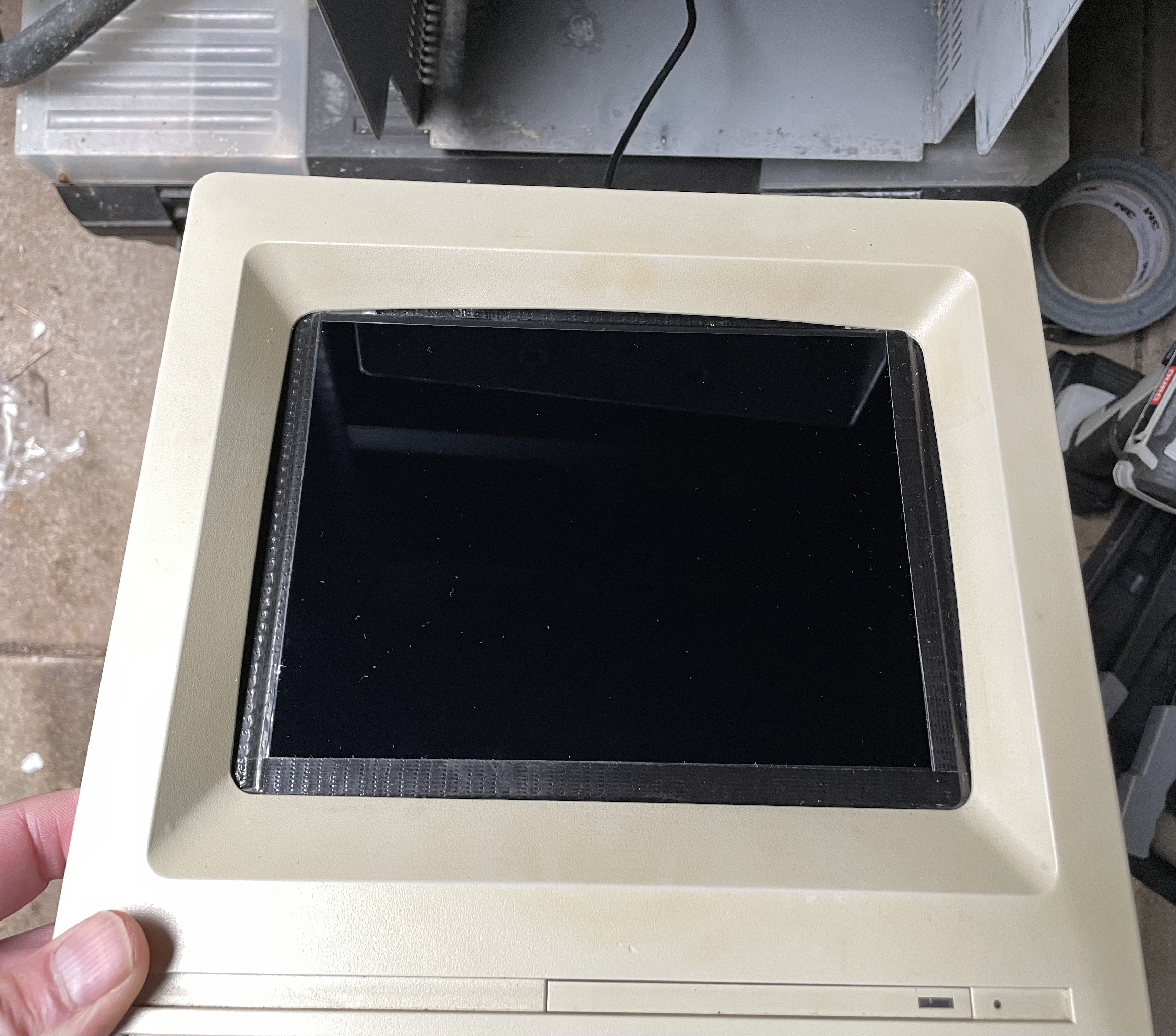

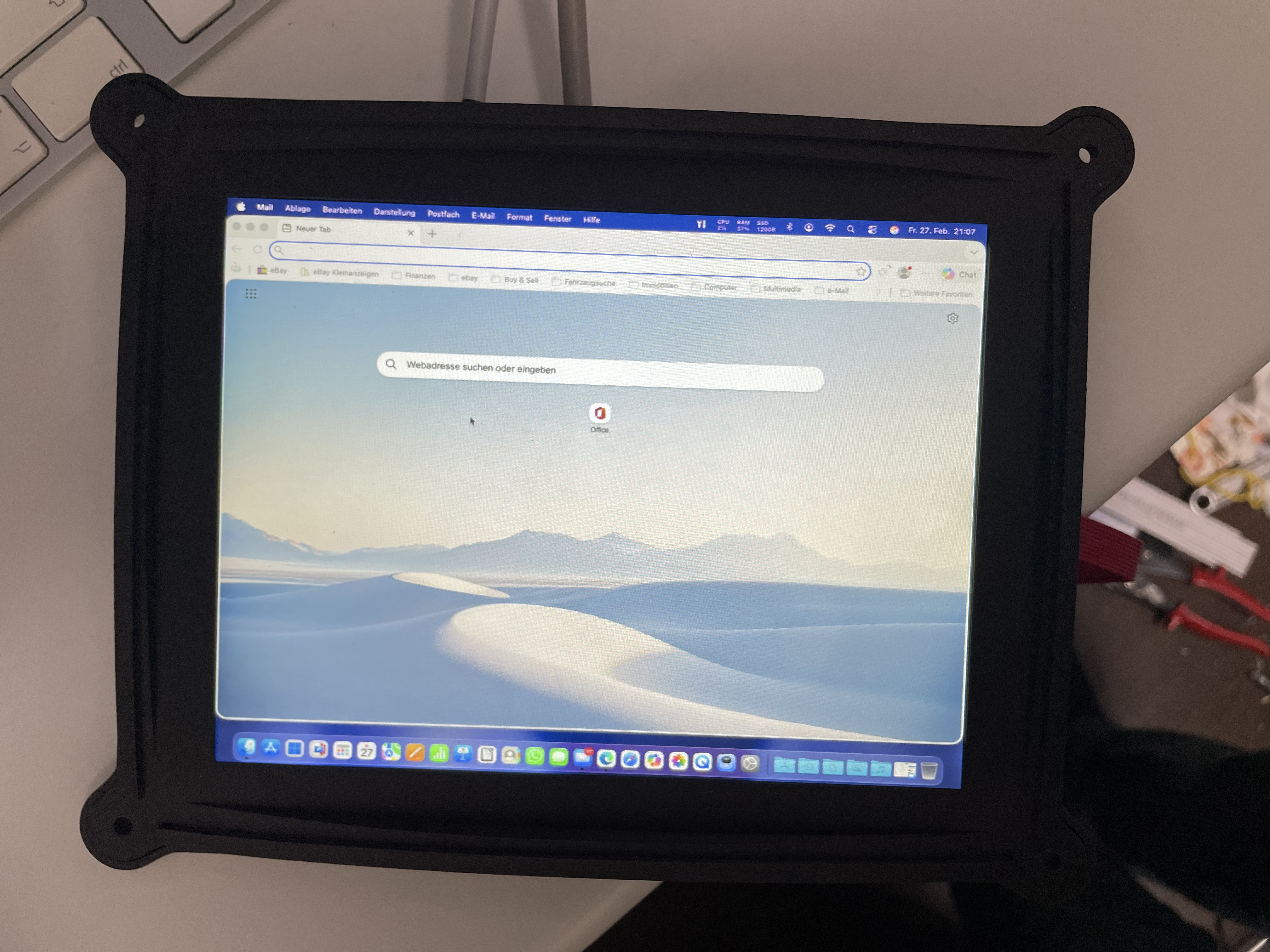

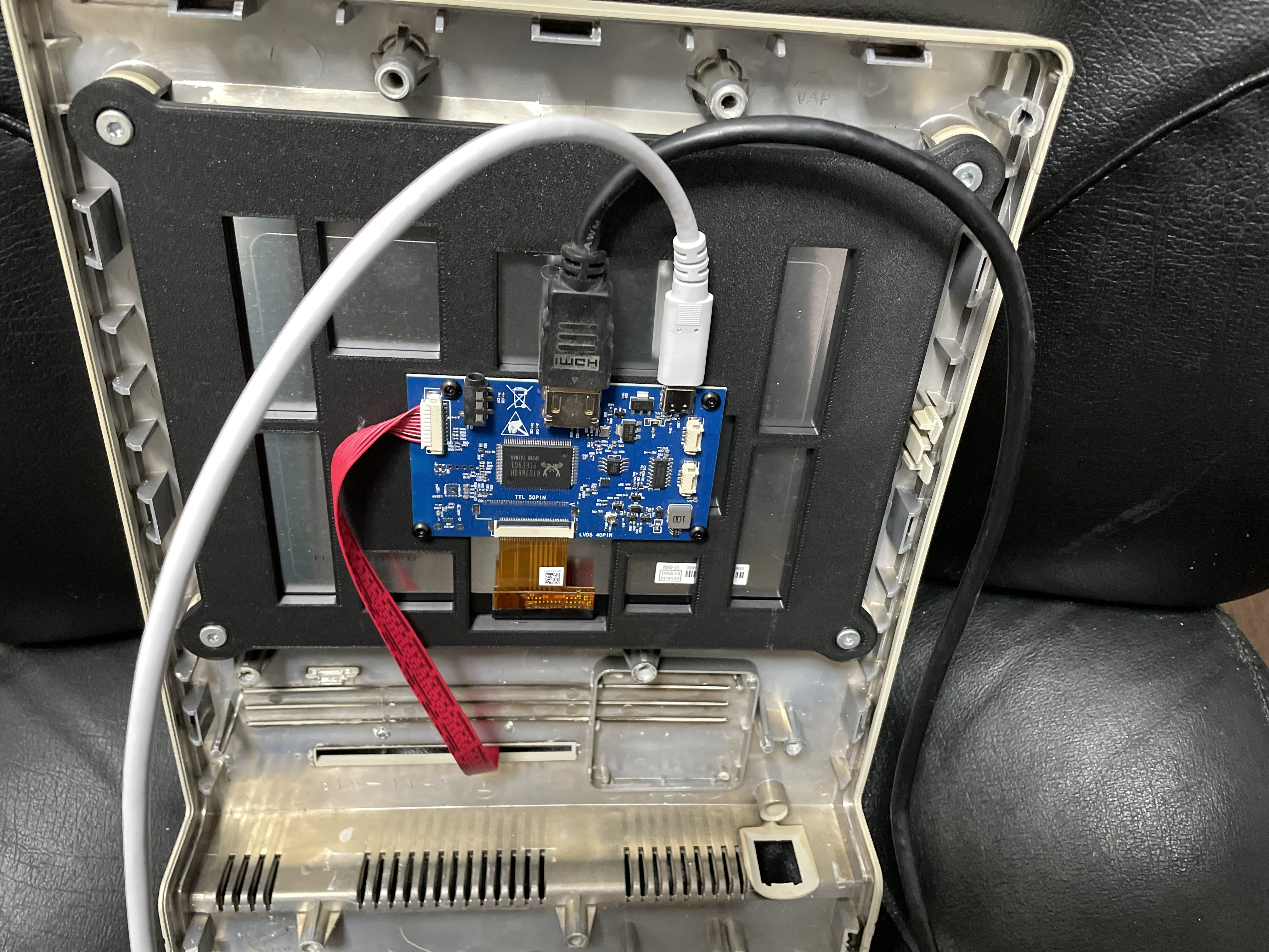

3D printed frame + 8" HDMI Display from AustrianMegaTech

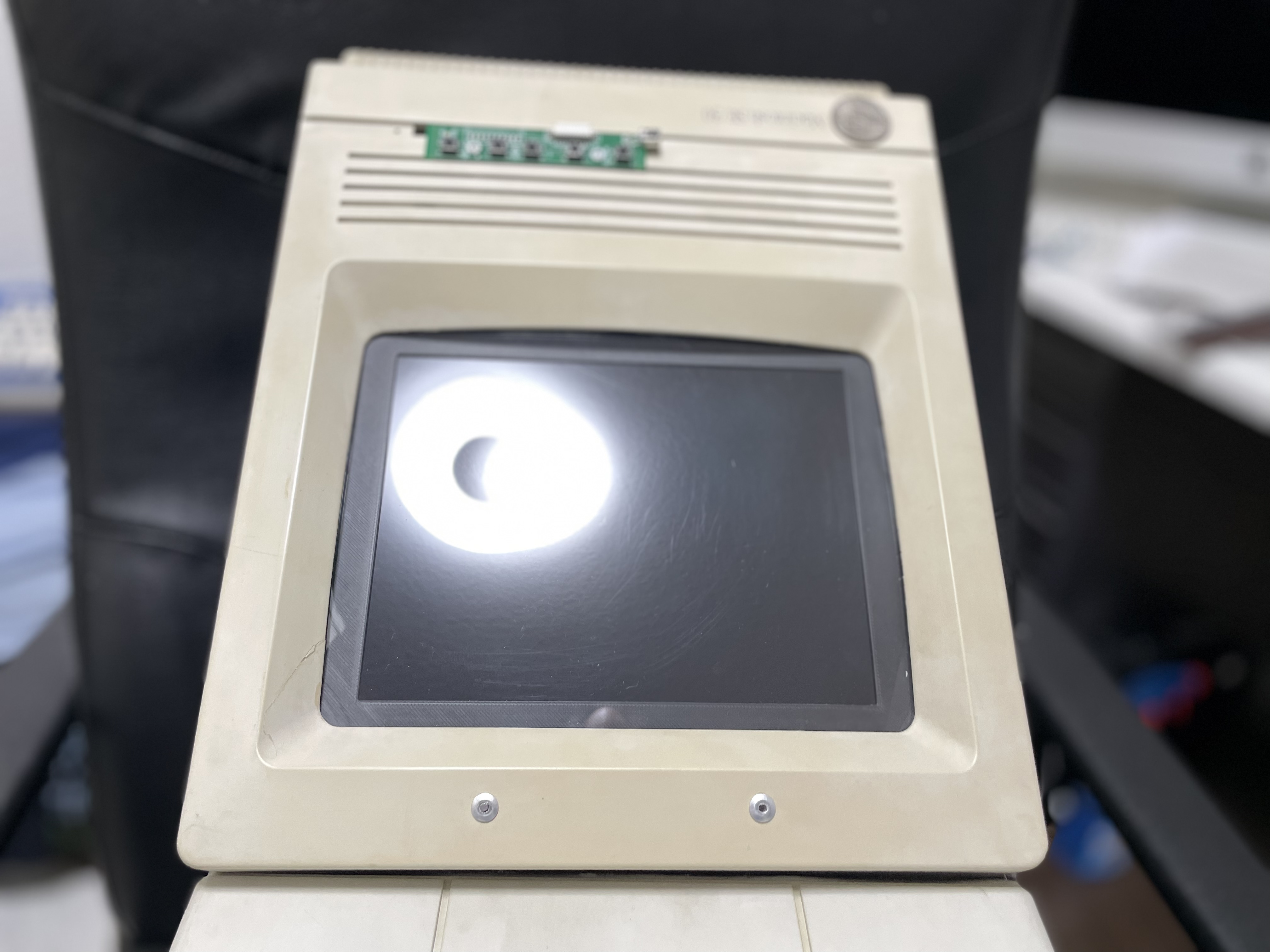

The plexiglass pane is very susceptible to micro-scratches !

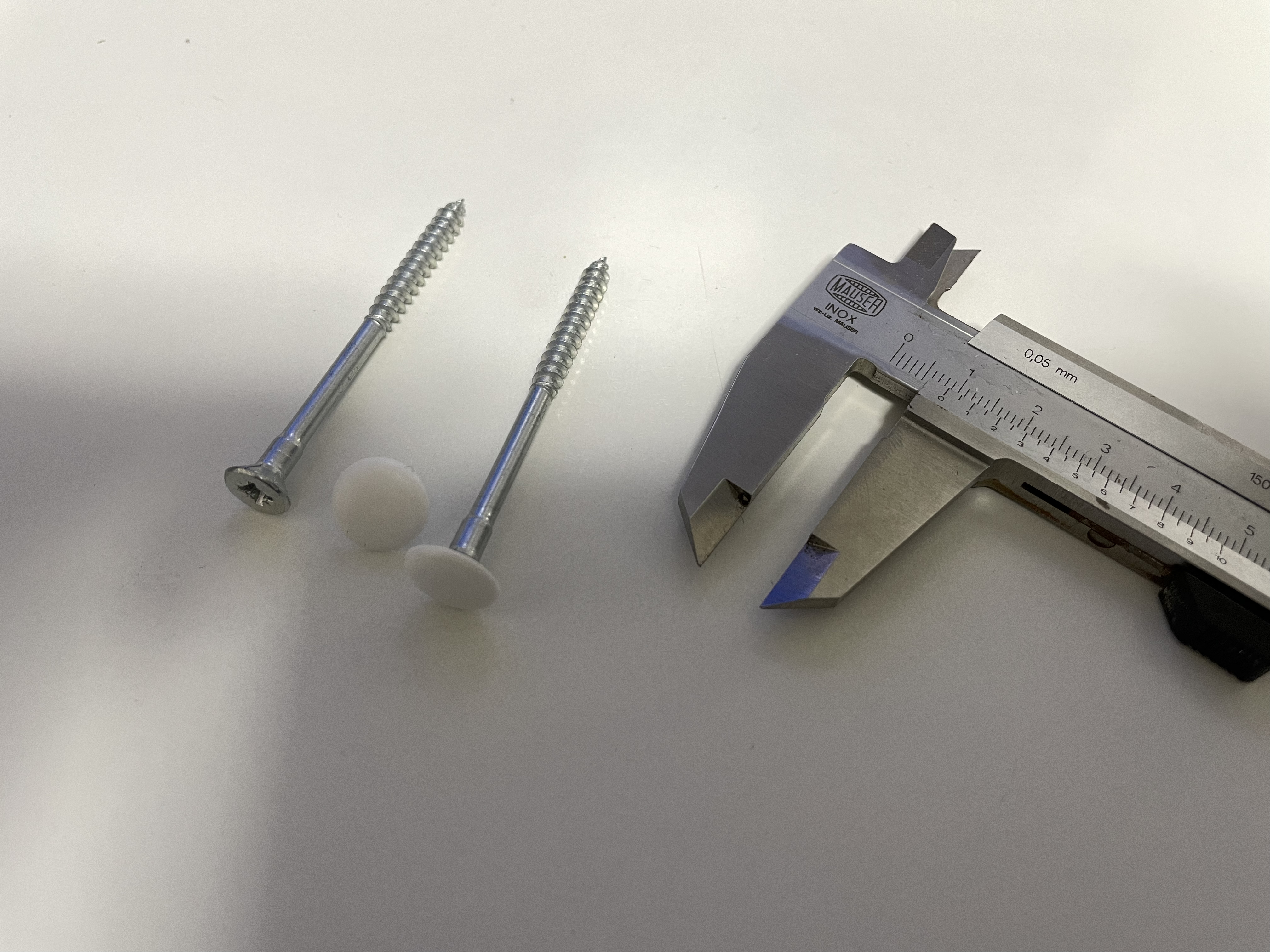

I began to take screws from front to back, but... I close the holes with rivets !
Not very beautiful, but I fixes the panel + access to the added remote control
Also a Mac Mini M1 or same case form is fitting (if somebody want)
...but I think I close the Mac Mini opening again with sheet metal or acrylic sheet

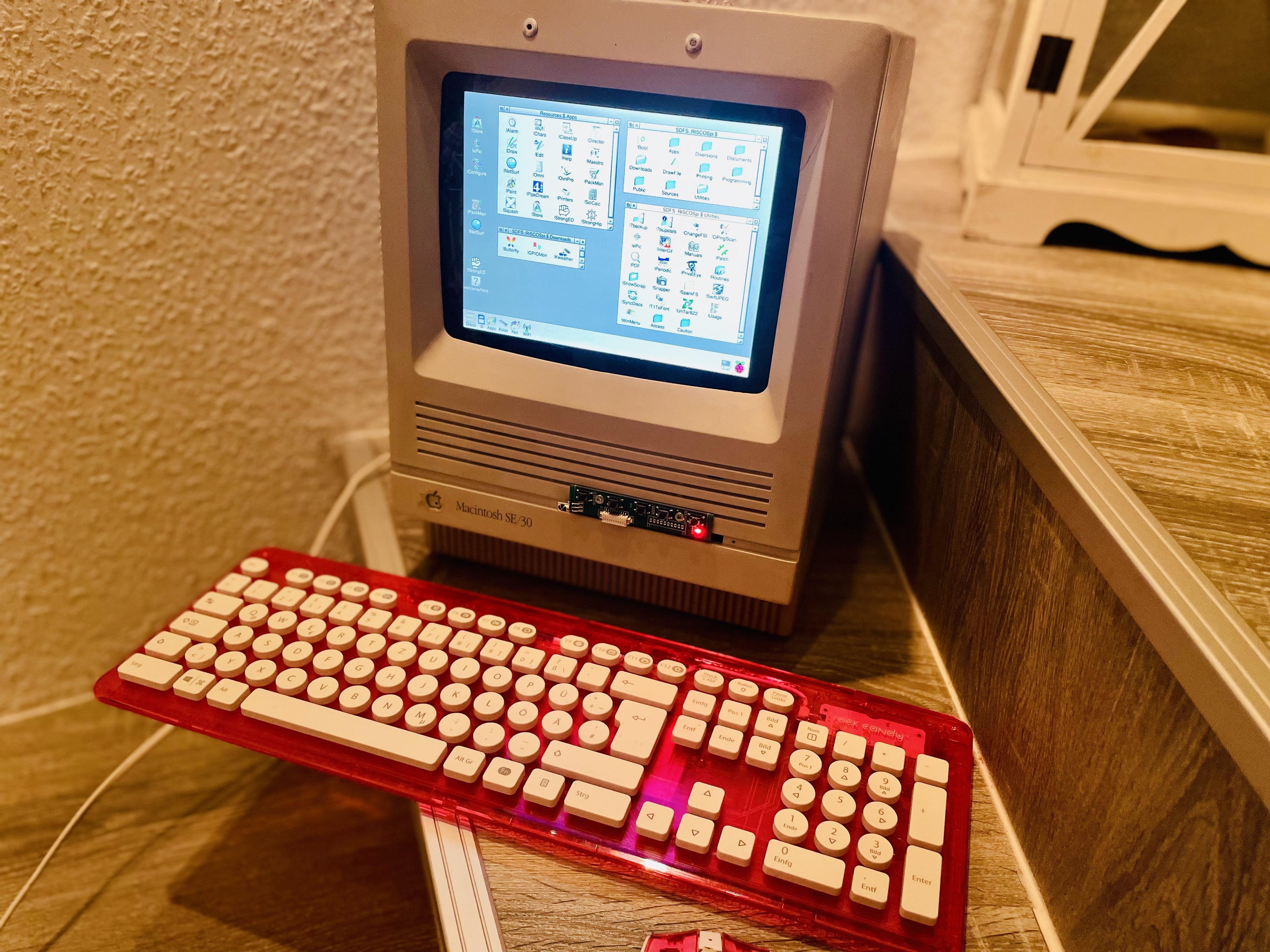

"Today, I was just looking for some junk in my workshop to get this
Macintosh up and running. Further devices will surely be better..."
"God bless the broken road !"

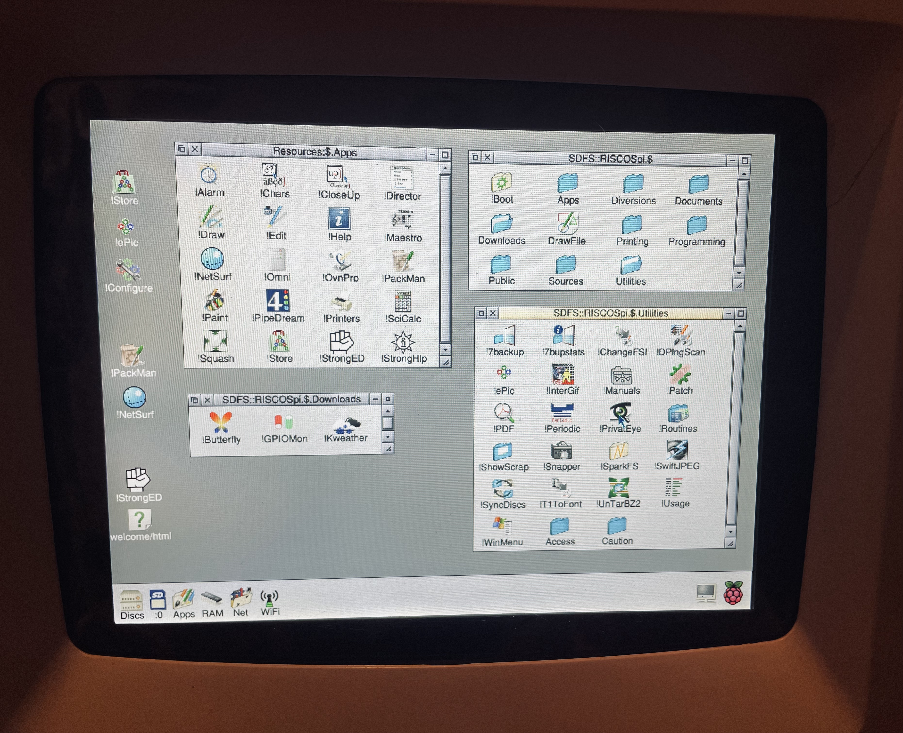

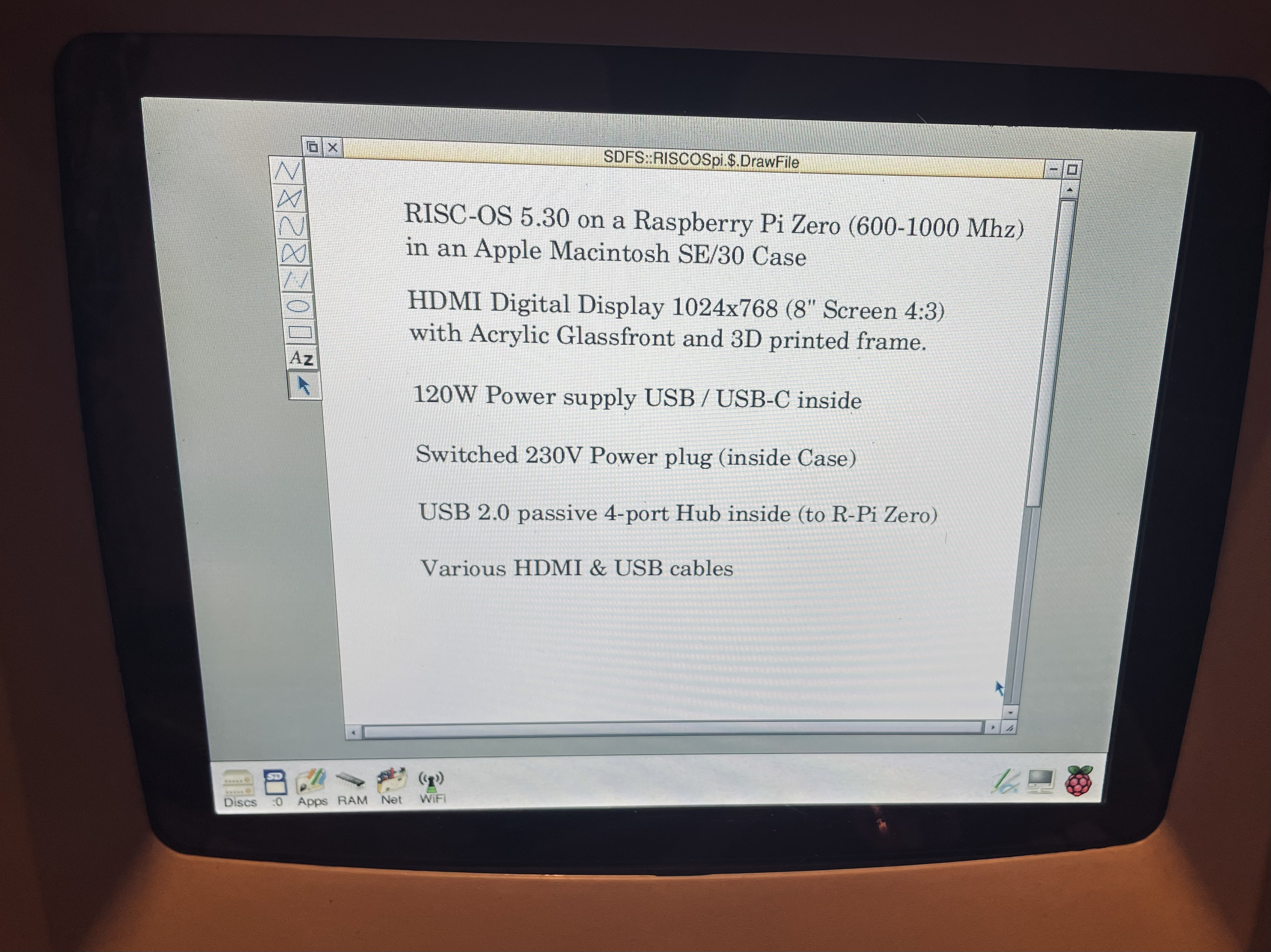

Apple Macintosh :apple: powered by Acorn RISC-OS Computer
This is my called Resto-MOD which I build last evening. As backgroud information, Acorn RISC OS Computer
was one of the first ARM-powered Mainstream PC which was in the end of the 1990 very popular in the british
Commonwhealth !
Both computers, the Apple Macintosh and the Acorn RISC Computer (A3000 / A4000 / A5000) costs in 1994
perhaps about 3000 $ - they were both no 1st choice Mainstream like the Atari ST or the AMIGA series !
With Next-Gen OS the Acorn RISC Computer and the Apple Macintosh were Dream-Machines in the 1990th.
I think that old ARM-based computers are the reason of the success of Apple (IPhone & Mac) today !
RISC-OS was the Grandfather of Task-Bar based Windows 95 or (later) MacOS. I think you can make today
everything with the 30 year old RISC-OS (with fluid Multitasking) ! 😉 So lets go, look at the pictures...
In fond memory of the 1990s, Steve Jobs (Apple and NeXT Computer) and Acorn RISC OS - Pop culture of the 1990th !!!

What bothers me is that with the Raspberry Pi, starting with the RISC-OS 5.31 update, a whole
bunch of modules get loaded, the OS then runs fairly smoothly on a RPi 4 with 4GB, but that’s no
good idea (with the Updates) for the RPi Zero with 512MB.

HDMI 8" Display 1024x768 Conversion - 2nd (cheap) Version
(no Acrylic bulbed Glass front and no 3D printed frame - 4:3 screen ratio - AliExpress / Amazon !
For that HDMI display conversion I use another Apple :apple: MacIntosh case from SE 1/40.
As you can see the screen was without acrylic glass front and without 3D frame for fixation inside.
Of course this solution was ok for usage as a 2nd HDMI monitor for Raspberry PI or another
device (Mac Mini / Mini PC - Linux or WIN) - but the Macintosh case take a lot space on the desk.
- I use some plastic rail pcs left and right to fix the screen with superglue.
- use black strong tape (duck tape) to fix and center the screen (look at picture 2).
- There were additional metal holders left and right + screws on top and bottom.
- the display controller was outside and not in the viewable area under the floppy
Hopefully you can see everything, pictures are sometimes better than words !
(a relatively cheap solution with usable HDMI screen, but of course no really good quality).
