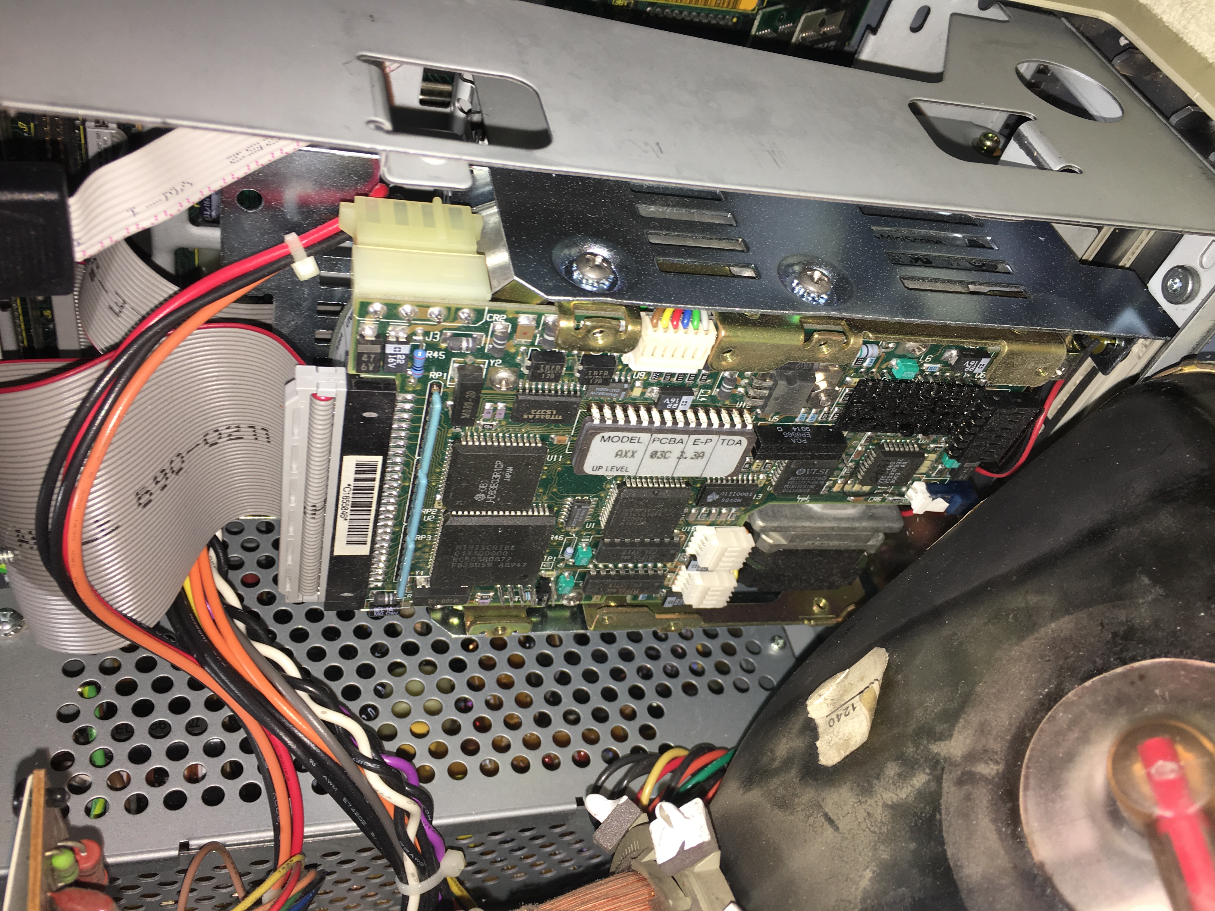

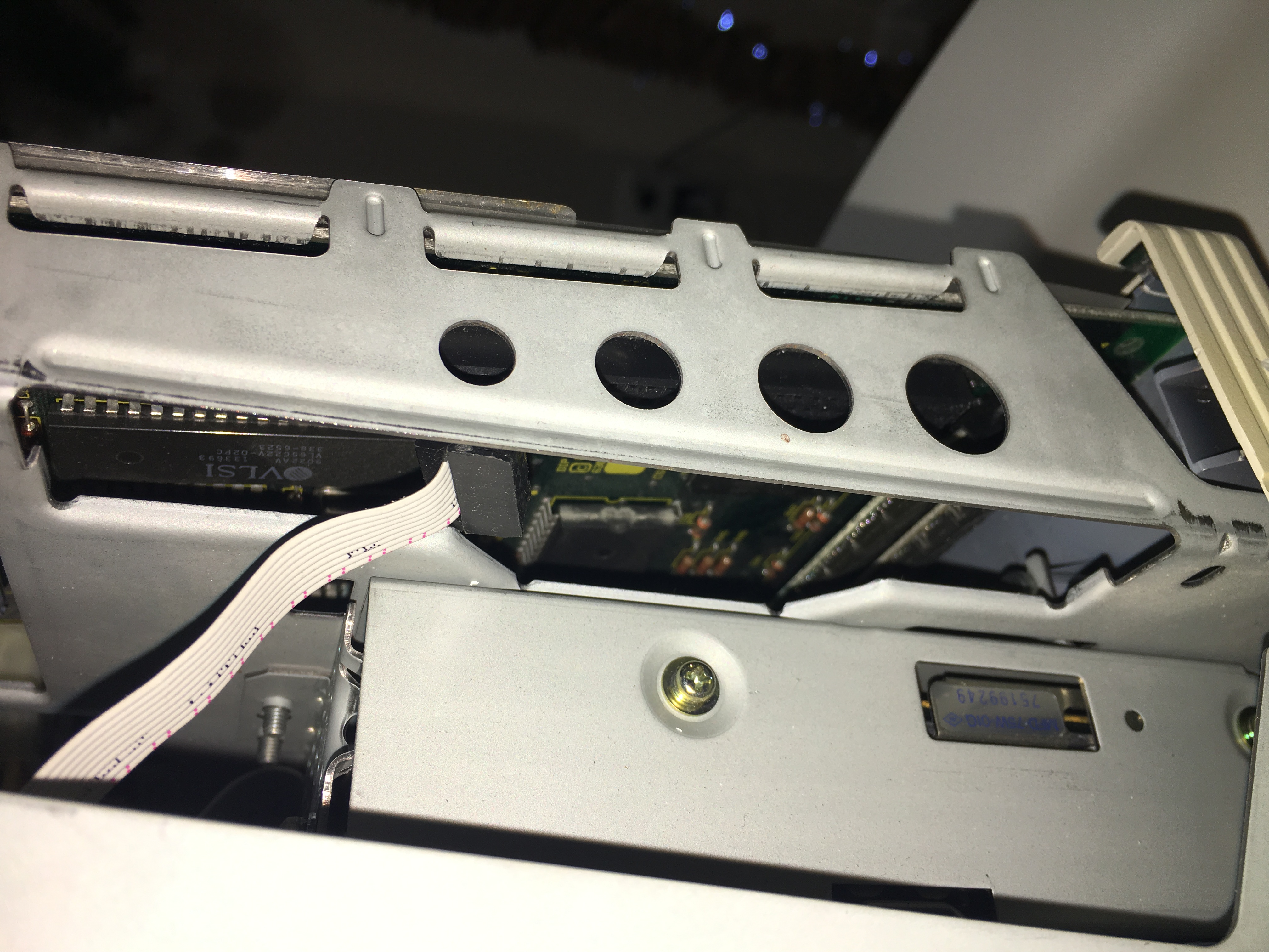

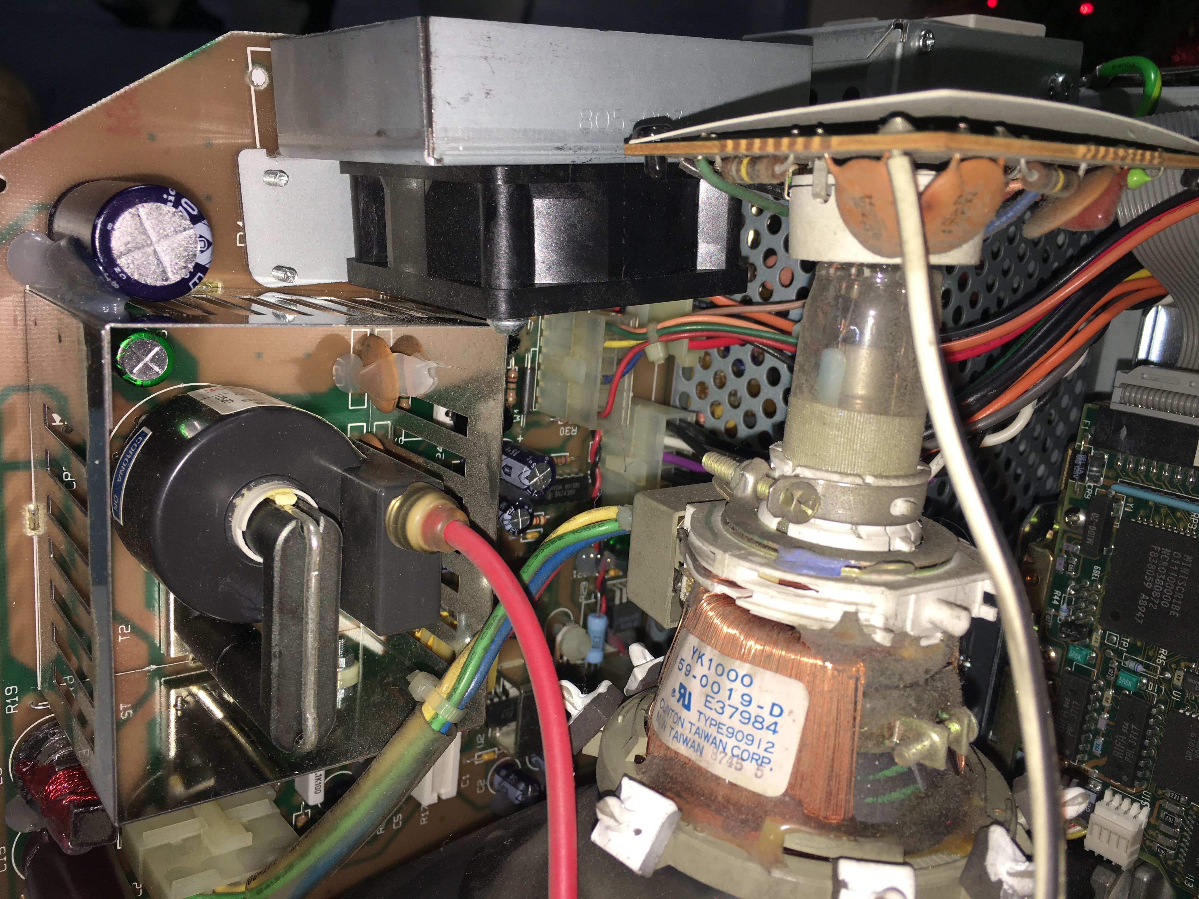

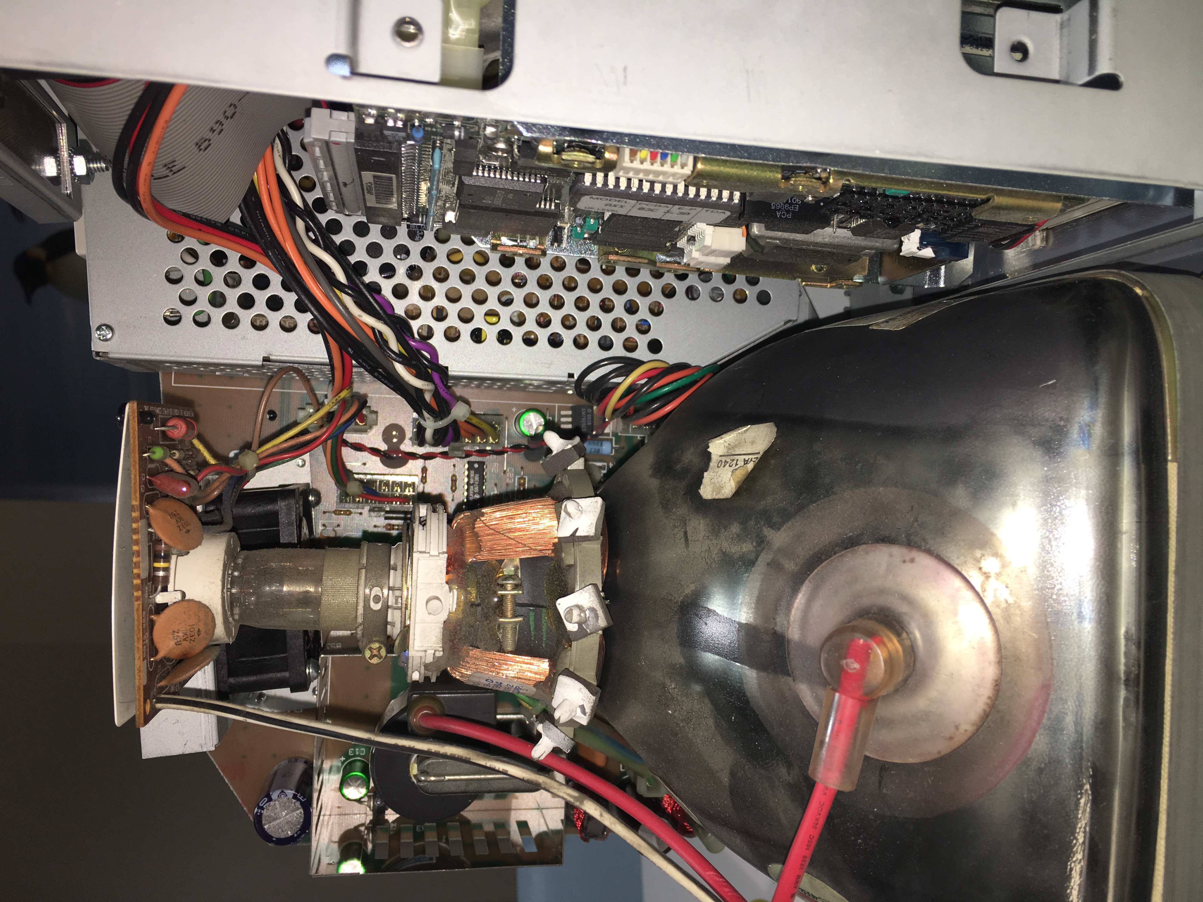

    Here's some pictures I took with the case off:
    [​IMG]
    [​IMG]
    [​IMG]
    [​IMG]
    And here's some 'fly-by' videos I took of the case, one is with an extra light, one is without:
    And lastly, I recorded a video with the case off while turning it on. I couldn't figure out where the sound was coming from, but when I turned off all of the lights I noticed that the very tip of the picture tube seems to be flickering (only barely visible at the very end).
    I'm really hoping I'm able to fix this because I've wanted an SE since I was quite young.

    I'm nowhere near an expert but from a quick Google search it seems as though your CRT picture tube has cracked https://goo.gl/LnGPW7

    Sadly, yes. My bet is the teat at the very back of the tube (where the little board plugs on) has been cracked.
    I've seen this a few times specifically with the SE in transit. :(

    It's the high voltage arcing inside the tube, since there is no longer a vacuum inside the tube. :(
    Very common with the SE. When Apple upgraded the fan to a square axial fan (instead of the original noisy barrel fan), the clearance was severely reduced between the fan and it's mounting frame to the CRT board that plugs onto the back of the tube. Flexing in transit seems to be enough to hit the board and snap the teat of the tube. :(
