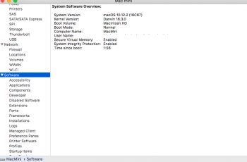

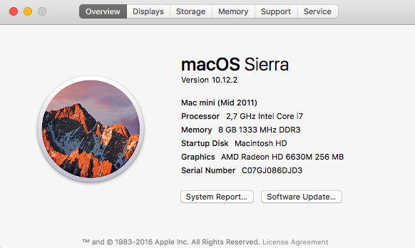

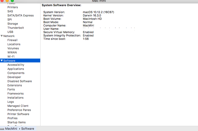

From the crash report, it looks like the LaCie driver is what's causing the crash. While you have the latest LaCie driver, the crash report says you have the initial Sierra version (16.0.0) or 10.12.0. The latest version is 16.3.0 (10.12.2) which is what you say you have. What does the "About" (Apple icon in top left corner) say?
EDIT: Looking at the build number in the crash report (16A323), that is an early Sierra build.
No, it is 10.12.2

So out of the machines you tested - Mini 2011, Air 2013, iMac late 2015 - and I'll throw in a couple of computers I have - the 2012 Mini and the 2014 Mini. Between these 5 computers, they use 4 different Thunderbolt controller chips (only the 2015 iMac and the 2014 Mini have the same chip). Compounding this is that the 2011 and 2012 have Thunderbolt 1, the later machines have Thunderbolt 2. A good guess is that there's some difference in the chip that's causing the issue. It's difficult for LaCie or other developers is trying to test all the Thunderbolt chips (particularly the older Thunderbolt 1 chips), if that is indeed the cause of the problem.
You should contact LaCie to make them aware of the problem. If they ask for your crash report, you should try to get one with your current OS version on it, if possible.
