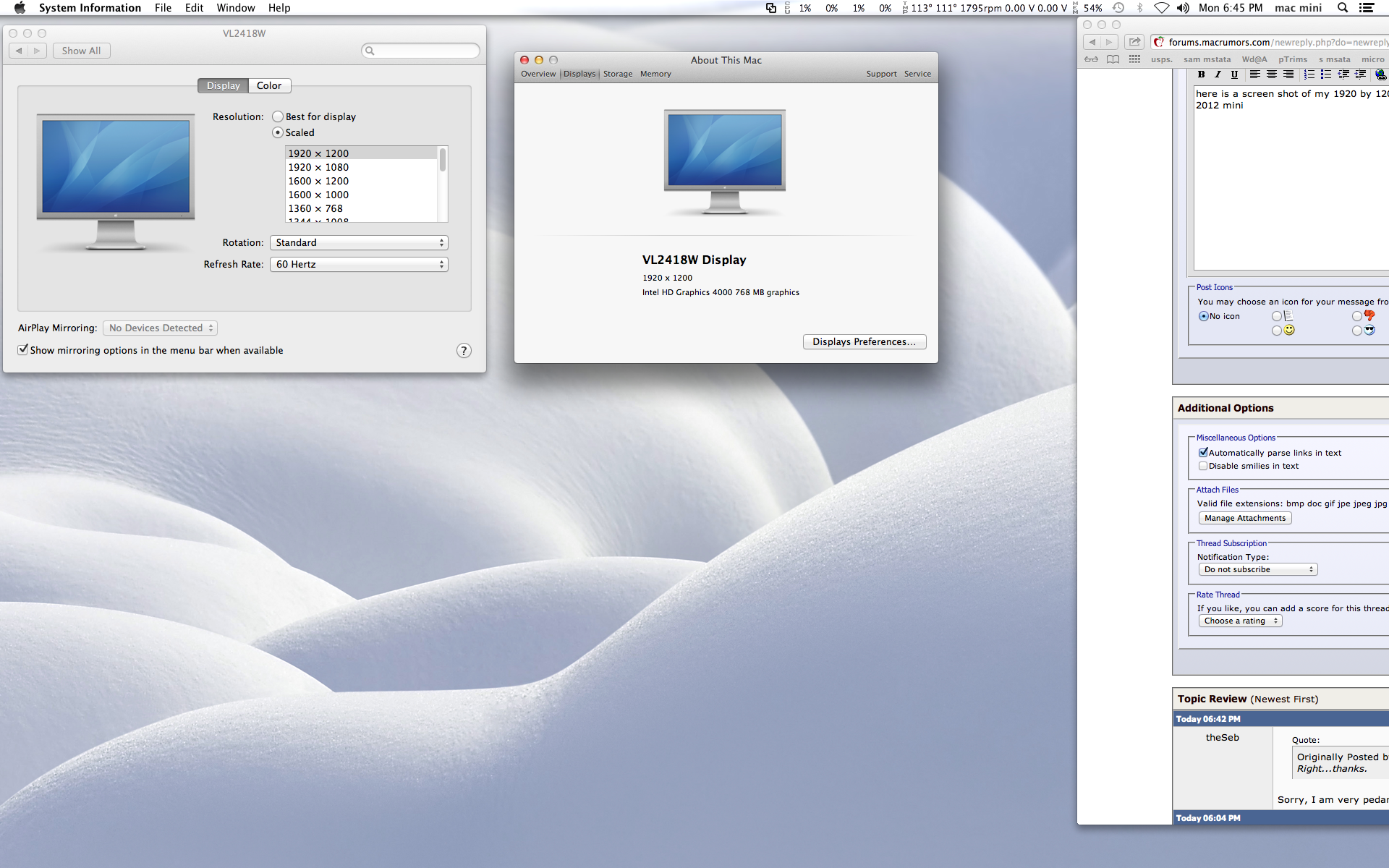

here is a screen shot of my 1920 by 1200 screen with hdmi to dvi adapter in a 2012 mini
Thanks, we know it works with a screen 1920X1200 but unsure if you can upconvert it to the width of the NEC.
