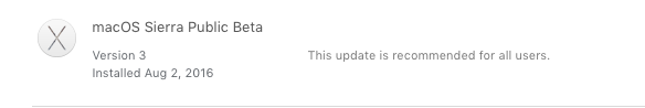

I think "16A270f is DB4"
Not according to the App Store ...
According to it, I installed Sierra PB3 last night
