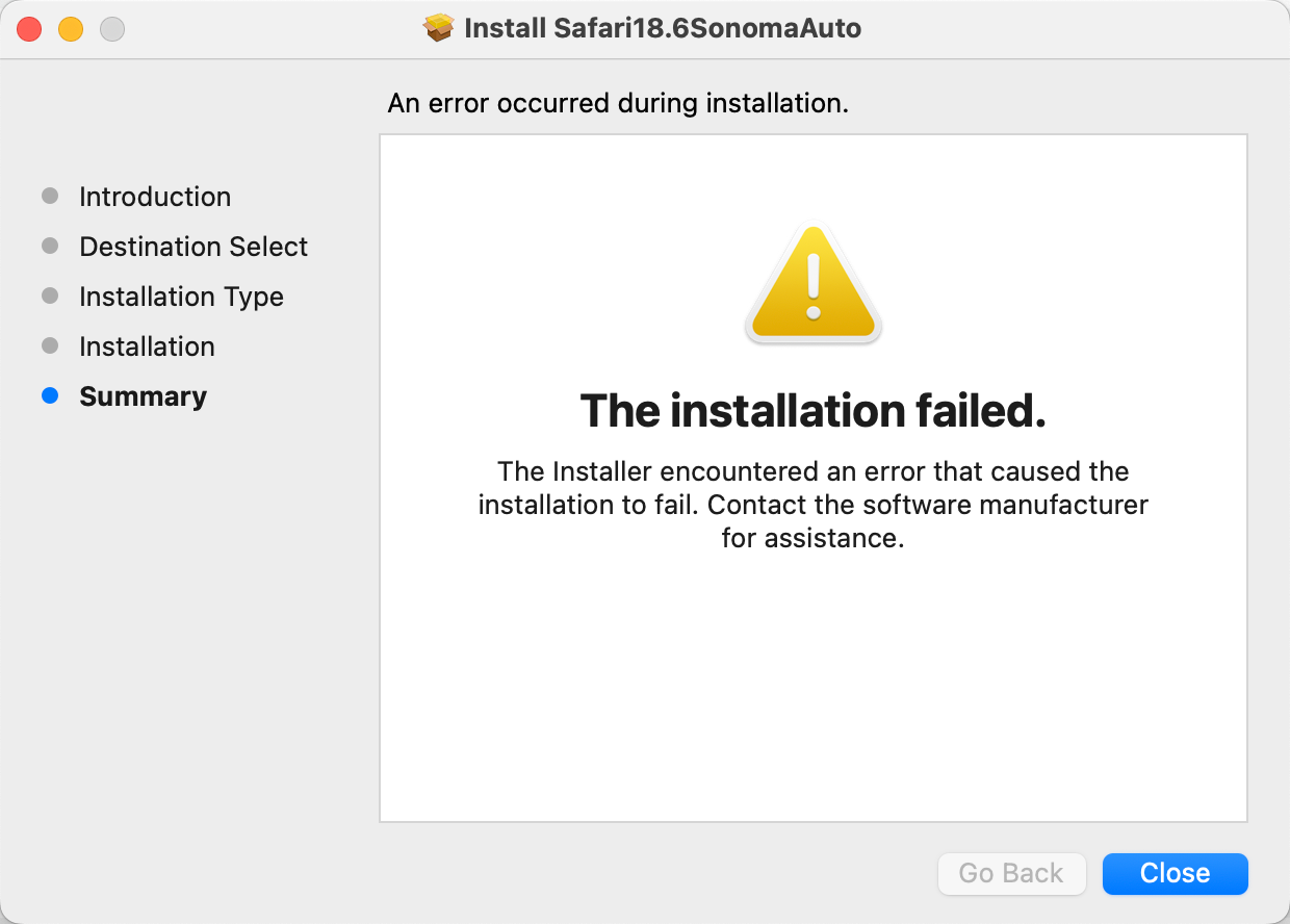

I tried to installed Safari 18.6 on my 15.7.5 M4 MBP, it shows "The installation failed."
Could you please advise how to successfully install 18.6? Thanks

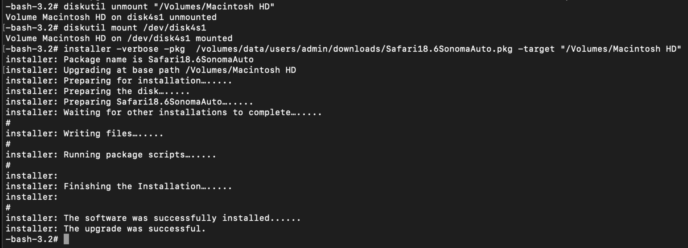

Another way: give Full Disk Access to Terminal and run:
Code:
sudo installer -verbose -pkg ~/Downloads/Safari18.6SonomaAuto.pkg -target /
The command assumes Safari18.6SonomaAuto.pkg is in ~/Downloads

I tried to run the code in terminal and got the error : installer: The install failed. (The Installer encountered an error that caused the installation to fail. Contact the software manufacturer for assistance. An error occurred while running scripts from the package “Safari18.6SonomaAuto.pkg”.)
To double click the pkg file with below error too.

Just tried on Sequoia 15.7.7 and an M2 MBA. Installs and runs fine using that Terminal code.
Thanks Bogdanw!
Reactions: bogdanw
