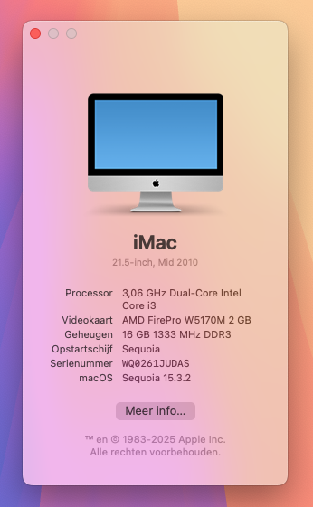

Sequoia 15.3.2 running nicely on 2010 iMac 11.2 with Metal GPU.
To be honest the update to Sequoia took a few attempts so I ended up doing my FIRST clean macOS install in 15 years!
There are a few small issues (mostly solved) with temperature sensors related to the GPU but these have nothing to do with Sequoia.
Thanks OCLP team!
