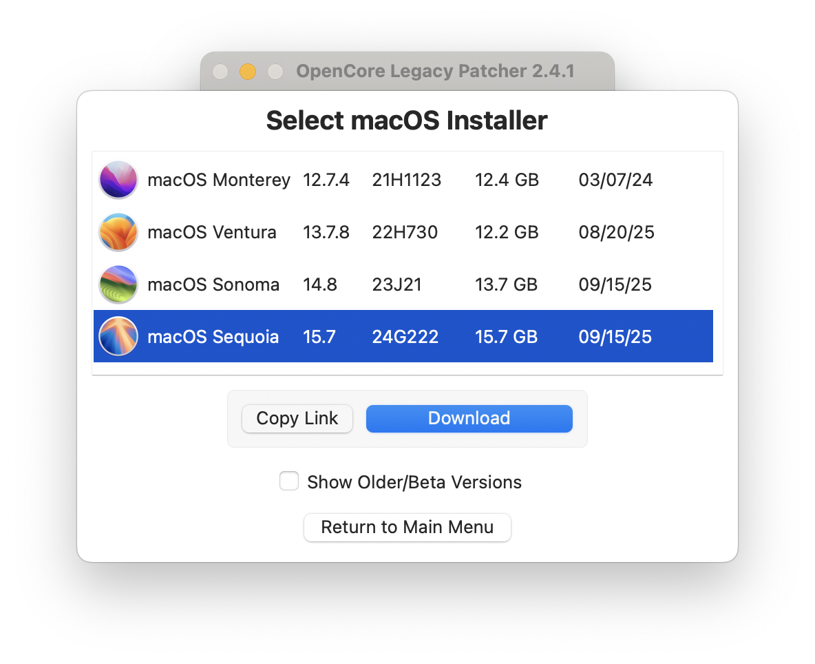

To update my earlier post, OCLP 2.4.1 is now correctly showing 15.7 in the download installers window.

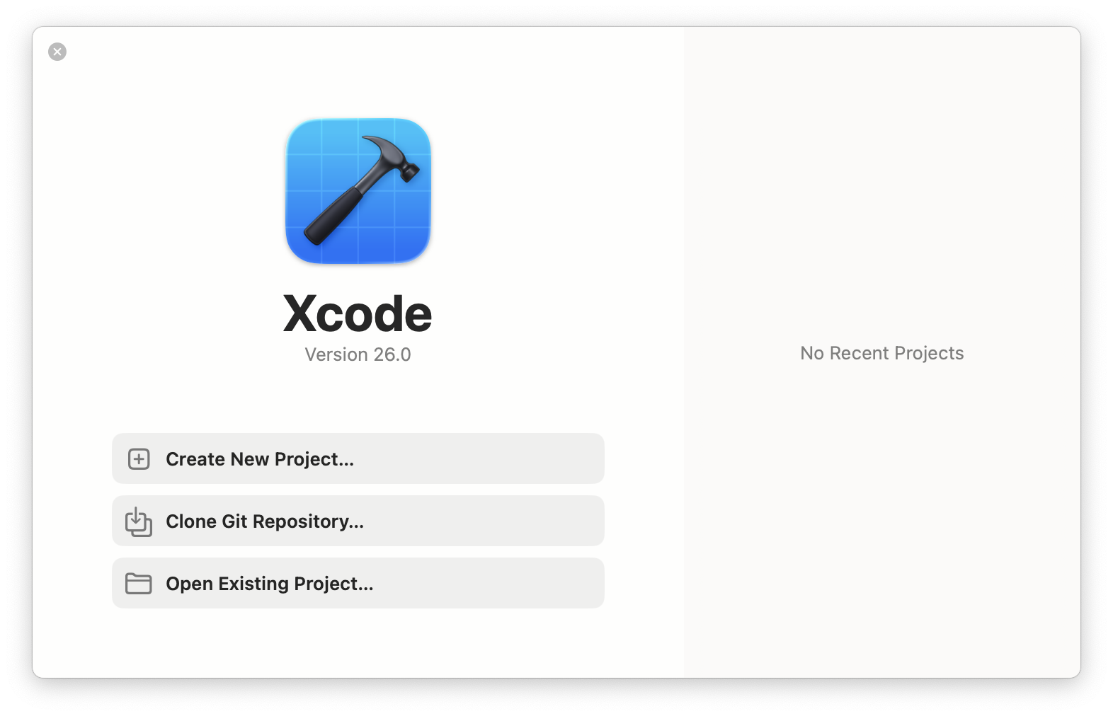

Is Xcode 26.0 compatible with Sequoia? It shows as an update. in the App store, it downloads, but then I keep getting a message saying it can't be downloaded once it gets to the installing phase, usually this only happened the first time when updating to a new version of Xcode under sequoia, but this time it keeps happening. Should I remove Xcode 16.4 first then install? Thanks.
Xcode 26
Is Xcode 26 incompatible with OCLP? I've been unable to install it from the App Store and from a downloaded official installer.
Somehow I missed your post, I was having the same issue. I was going to try and download it from developer.apple.com instead, to see if it works that way.
No, I already tried that. It doesn't work either. I don't suppose it's an AVX/AVX2 issue (my Mac Pro 5,1 processor doesn't have the requisite set of instructions), but who knows?
^I tried that, but, sadly, it didn't work for me. I downloaded Xcode_26_Universal.xip. When it unzipped, an Xcode installer was generated. Running it, it finally failed.
PS. The second attempt was the charm. I can't figure out why it failed a few hours ago. Now there were no issues.
Xcode 16.4 works for me (2015 15-inch MacBook Pro, MacBookPro11,5) on Sequoia 15.6.1.
I'll give Xcode 26 a test when I upgrade to Sequoia 15.7 in a few days, and the same with Safari 26.
From what I understand, it doesn't matter which you use, it's the same program. It's just the choice of how you want to manage updates.
