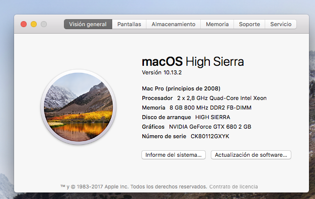

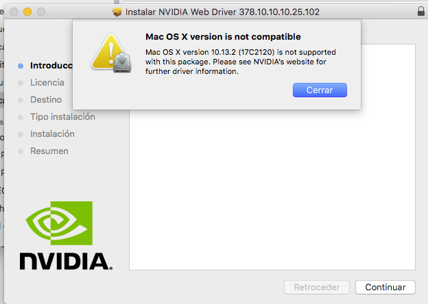

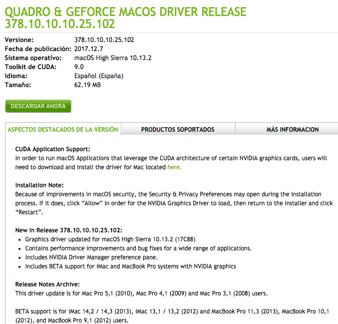

I'm in an MP 3.1, all good and super fast, test installation in an external hard drive usb. Apogee audio interface ensemble ok, the volume slider on the desktop does not work, change volume through the apogee software. my video card is a gtx 680 mac edition, 3 screens working ok hdmi ok , but I do not understand why I can not install the nvidia drivers, at the moment the generic drivers work well., any solution for the volume slider or teak increase cards? volume on the keyboard? the next test is in raid sdd software of the internal bays

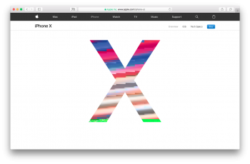

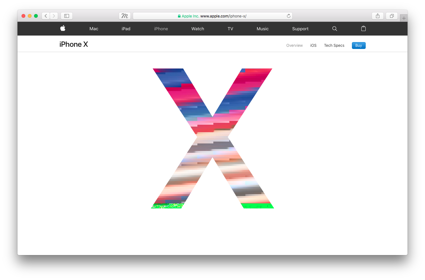

With 10.13.2 I got the same GPU issue that some people experienced before on past updates (MBP 5,3 Mid 2009). Isn't that weird that I never experienced this bug before till 10.13.1? WTF.
Reactions: kkkiller
