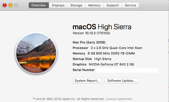

Similar system as yours, but luckily so issues whatsoever with the recent or any other update.
In a Mac Pro 3.1 Sierra runs like a charm. Made a clean Usb Installer with High Sierra 10.13.3
All runs fine except the AMD Radeon HD 7950 3072 MB. Fans high and cero performance. I suppose its not recognized, though I checked the patch in the Post Install
