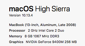

The 10.13.4 install went well.
Interestingly, the 2.3 GB install on this 2.0 GHz Core 2 Duo with old slow Kingston V+100 SSD was way faster than the 7xx MB iOS 11.3 install on my iPhone 7 Plus.
Unfortunately, the NVIDIA GeForce 9400M h.264 video glitch is still there. 😡
