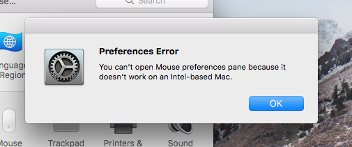

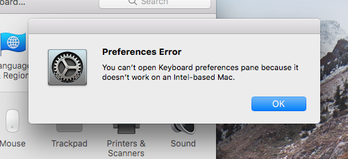

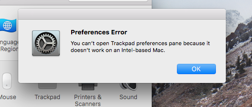

Hello everyone,
After installing the night shift patch through the patch updater, I am unable to enter the settings for keyboard, mouse and trackpad. Any solutions for this? Sorry if it has been asked before.

On another thread Olivia88 discovered what caused this issue, it's an invalid patched Night Shift CoreBrightness framework, if you are on the latest 10.13.6 High Sierra version, try mine NS already patched for High Sierra following these steps:
- Open Finder then GO "go to folder" or use keyboard shortcut CMD+Shift+G and copy-paste:
/System/Library/PrivateFrameworks/CoreBrightness.framework/Versions/A/
- Replace the one inside this subfolder with this already patched binary unix exec CoreBrightness I have attached
- After done restart your iMac, this will bring Night Shift natively on unsupported Mac and mainly will fix your input devices prefpanes issues
This solution did not seem to work, unless it has to be modified for my particular model.
@jackluke ?
@jackluke ?
It should cover all the unsupported high sierra night shift models.
Try using CoreBrightness unpatched from HS 10.13.6 and see at least if fixes prefpanes input devices issues.
Try disabling SIP, then try copying a fresh version of that modified file to that same location.
Restart.
Try your preference panes.
Re-enable SIP.
Verify that the panes still will open.
The SIP was disabled all along.
So far I can get to work either night shift or prefpanes, but cannot seem to have both.
Also after manipulation with CoreBrightness replacement I noticed that the optical drive started to spin at the boot up which is never happened before.
Is there a chance that the modified file got somehow corrupted? I don't know how to check it but the text editor could not open it, while I could open unpatched file in text editor.
