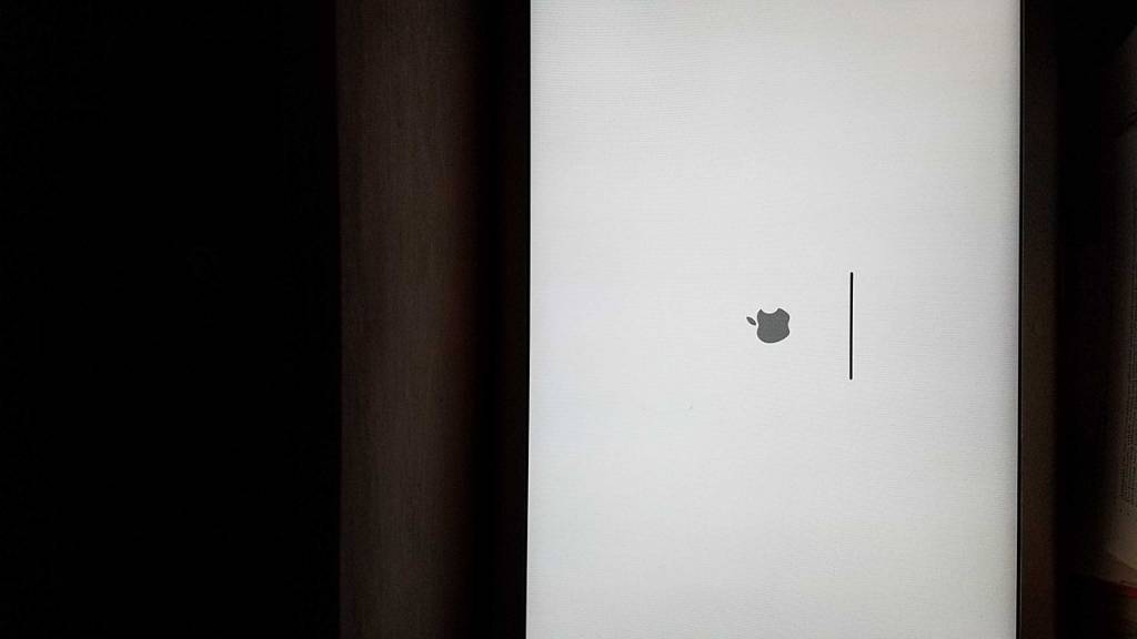

I made some progress.. The one thing I was thinking could've caused an issue may have been it, as I said, when I did the post install, I had to do it from target disk mode from my MBP this the post install detected the AMD in my laptop and wanted to apply that patch.
I copied the kexts that patch changes from the installer to SLE and rebooted, I got glitchyness and it didn't work too well, although the one screen on the 560ti looked the best..? So I figured maybe the kexts were slightly diff on the installer and maybe a reinstall would help..so I reinstalled it, not sure if it actually overwrote those kexts now either as I still got glitchiness after rebooting..not as bad this time though..but with the glitchiness, it would kick me out shortly after logging in..
Noticing my Cinema display on the 560ti had less glitches, I unplugged the screens from the Quadro and tried logging in again.. No glitches, and I am logged in, with acceleration and NVIDIA driver running, supposedly.
CUDA-Z still wont run.. but I can do rotation, and the graphics are clearly much smoother... I wouldn't be surprised if I have to find an older CUDA package for my card maybe..maybe even older drivers..but really I don't need CUDA atm..just proper acceleration..
Now to figure out why the Quadro boots me out..

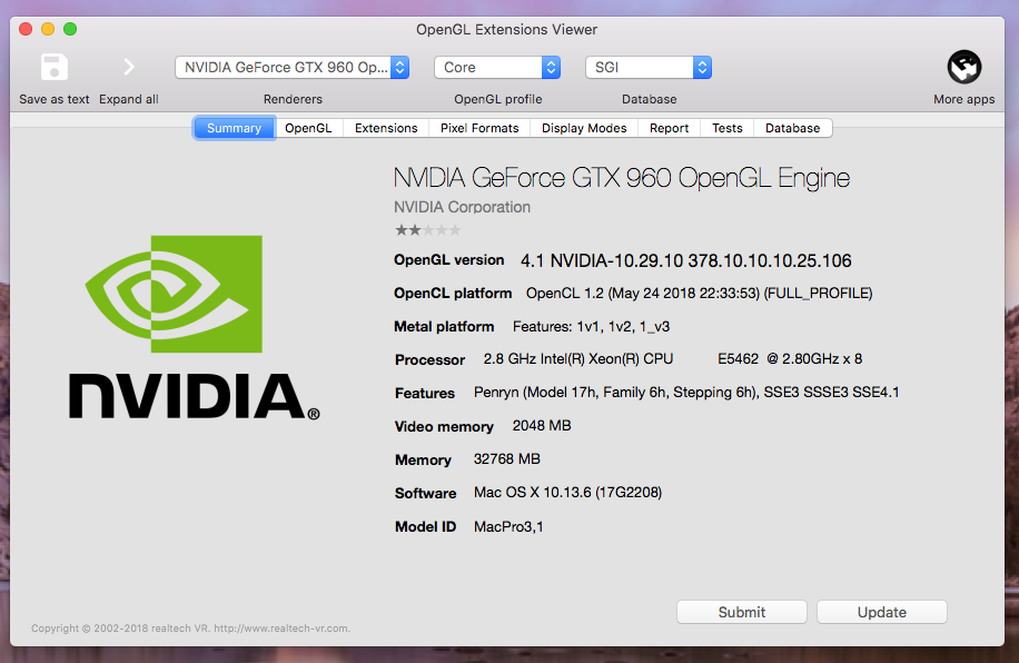

Still can't get CUDA-Z to launch, says no Cuda cards. Have latest web drivers and cuda drivers. Pew pew.
This is with only the 960 now. The fermi cards are retired, the fans were f**ked on the 560ti anwyay.
Curious..I have never seen any nvidia card ramp up fans in os x. Heck, I don't even know if its ramping core clocks and such. The game I want to play runs at like 0.25fps (Dirt Rally, metal-based game) but the gfxbench metal benches ran smoothly.

So i tried to boot from my usb to do this update and it is stuck showing an apple and full bar along the bottom, is that normal?
You didn't say which OS X system you are trying to boot. If it is Sierra or High Sierra, then you should re-check booting on an older installer, such as El Cap, or even Lion.
Does your MPro boot to a system that you know it supports? Try booting to an El Capitan install, or even Lion.
If it won't boot to Sierra, but WILL boot to El Capitan, or something older, then your Sierra bootable installer may be miscofigured, so you should try redoing that installer USB.
Reactions: j2048b
Im on el capitain, trying to boot to os high sierra on the usb to do the upgrade as dosedude explained but also never tried to make a boot disk or in this case a usb,
Ok cool ill see about that, i followed dosdudes instructions from his web site, and it just wouldnt work for me, then my computer went back to flashing ot a and ot b again on the logic board, and shut down so now i need to find out if its the logic board or power supply or ehat ever it could.possibly be
