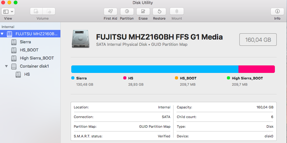

That doesn't look like the High Sierra Disk Utility... Are you sure you're using the latest version of the High Sierra installer? If not, you can just use to "Download macOS High Sierra" option in the Tools menu of the tool to download the latest version. Also, in the boot menu, the volume should be named "<High Sierra APFS Volume Name>_BOOT". It may also just show up as "EFI Boot".
I booted to working Sierra partition. Thats how it looks. Yeah, I downloaded the latest version 2 hrs ago. Damn, there was EFI Boot partition but Its gone now lol. I reformatted the partition to start over.
He's probably booted into working Sierra or something, since he can't boot into HS.
@Brale There's a "High Sierra_BOOT" visible on your screenshot - that's the HFS+ helper partition that handles booting into an APFS volume, so it looks like the patcher did what it should.
Try going into Startup Disk in System Preferences and see if you can see "High Sierra_BOOT" there. If you can, select it as the startup disk and reboot (or select it and click Restart).
I'm not sure but I guess it was working fine. The problem was that I was looking for High Sierra partition to boot from. I should have tried to boot from EFI partition.
Thanks roziek. That was the problem, I HAD selected the patch for Recovery Disk too as well as the APFS patch. Rebooting from the USB footer/installer and reapplying the patch only for APFS fixed it.

@nekton1 That "Spare" you talked about is not the helper boot partition that @dosdude1's patcher tool creates. Looking at your diskutil list screenshot I can see that the patch did not work for you. When it does, it resizes the APFS container and creates the helper boot partition there, with a _BOOT suffix. In other words, if it would have worked, you would see something like this:

This happened to me too at first, but I think the culprit is the Recovery Volume patch. If you select both the Recovery Volume and the APFS patch - it will simply not work. Fortunately you can fix that without repeating the OS installation process. Simply reboot into the installer created with @dosdude1's patcher tool, choose the Post Install Tool, select your Mac, and check the APFS Patch, but make sure that Recovery Volume patch is not selected. It should work.
You'll know it worked because you'll also see a message below saying it's applying the APFS patch and it might take a minute. I assume you did not see that message before, right?

See my reply to roziek. The problem was caused by having both the Recovery Disk and APFS patches ticked. Reapplying the post install with only APFS ticked fixed the problem.
@nekton1, can you run the post-install patch using Terminal? That will give you output, which should give me an idea of what's happening. When booted in your High Sierra installer, run "/Applications/Utilities/macOS\ Post\ Install.app/Contents/MacOS/macOS\ Post\ Install" in Terminal, and then apply the APFS patch. Get resulting Terminal output.

Ah, got it. Well, I changed it so it won't allow the Recovery Partition Patch to be applied if patching an APFS volume in version 2.1.1 of the tool, so this should no longer be an issue.

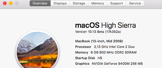

Just finished installing latest High Sierra Beta on my MacPro3,1 using the latest patcher and all seems to have gone well.
As always, thanks to those responsible for helping us keep these old work horses alive and productive.🙂
Installed using APFS...
