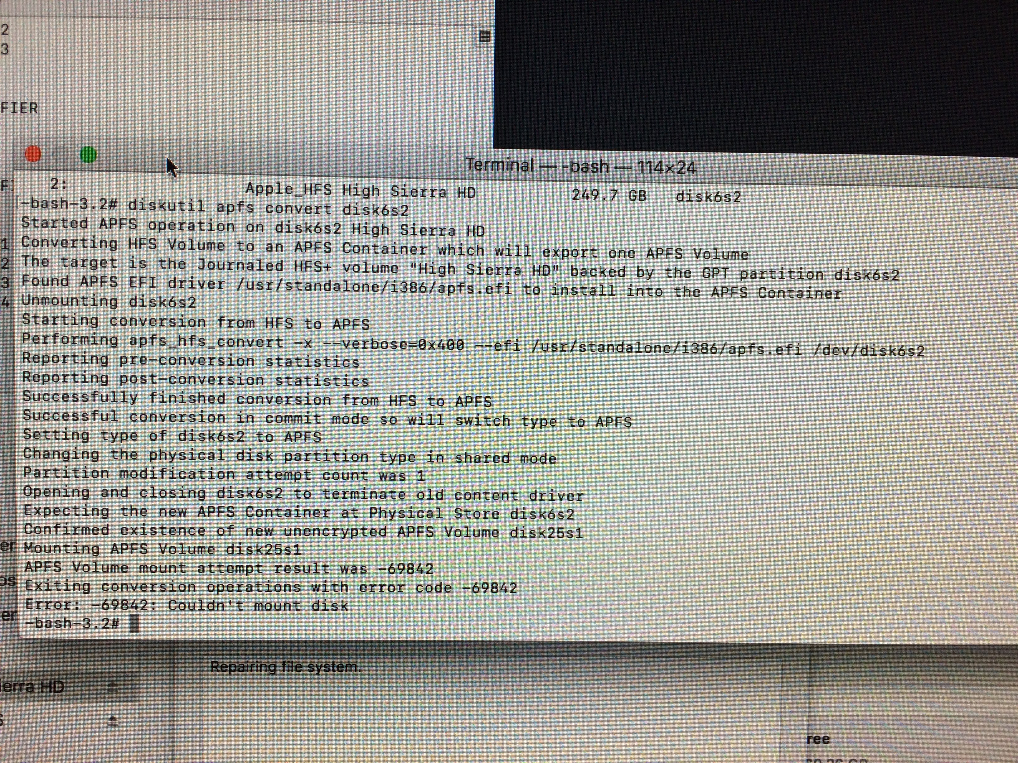

I've been installing HFS High Sierra on an external USB drive for weeks now. I can try converting that volume to APFS and installing the APFS patches later tonight.
As I suspected, the problem here may lie with the current state of the apfs conversion code in diskutil. Using my USB drive with a working patched HFS High Sierra installation as the starting point, I ran the 'diskutil apfs convert' command but it emits an error code on exit...
I ran Disk Utility on the resulting APFS partition and it claimed to do a successful repair. However when you apply the APBS post patch the progress bar immediately jumps to completion without actually creating the helper _BOOT partition.
I'll try a different tactic here to separate out the buggy apfs conversion issues from the APFS booting on removal media issue by reformatting the external drive and cloning the working SATA drive APFS partition using Carbon Copy Cloner. I suspect this will produce a usable APFS volume for successfully applying the APFS post patch.
[doublepost=1503868438][/doublepost]Note that creating an empty JHFS+ volume on the external USB drive and the running 'diskutil apfs convert' completes without error.

It appears the the APFS patch application isn't working on APFS volumes residing on external USB. I replicated the steps that I used to create the SATA based APFS installation by erasing the external USB drive as JHFS+, running 'diskutil apfs convert'. .. which completed without error messages and then using Carbon Copy Cloner 5.0 to clone my working SATA APFS partition onto the USB APFS partition followed by applying the APFS patch. I see the same behavior as before where the APFS patching prematurely 'completes' without creating the BOOT partition. Interestingly, it also seems to mangle my SATA APFS boot partition so I had to reapply the APFS patch on that one to recover booting from it.

Is that a cloned install? If that's the case, the reason why it's modifying your SATA boot partition is because it writes a file to the root of your APFS partition, which the patch then reads if applied a second time so it knows what boot partition it needs to modify, without unnecessarily re-creating another one.
So basically, if you clone a SATA drive's APFS patched partition with Carbon Copy Cloner,, when applying the APFS patch again on the cloned partition now residing on an external USB drive, it assumes you still want to use the helper partition over on the SATA drive. Oddly, in my brief testing with that configuration, HS on the external USB drive couldn't boot and produced the null icon during the second stage of the boot process.It is fortunate that you have found a workaround that avoids the helper partition and that method does have far too many corner cases to deal with.
