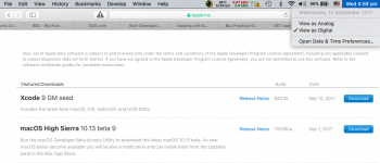

I saw on a Windows site stating as of today that the HS GM is out, and somebody else in this forum has confirmed that the Developer Beta page says it’s out too.
Also still seeing Beta 9

It does look like the GM's out - didn't show up as an update in MAS, however (and using the dev d/l link unfortunately gives my MBP 4,1 the dialog that 10.13 isn't supported on this machine) 🙂
Making a patched installer with the GM. Hopefully it installs without issue.
Edit: Nope, it's not the GM. Bundle is 17a360a (believe that's still DP9).
