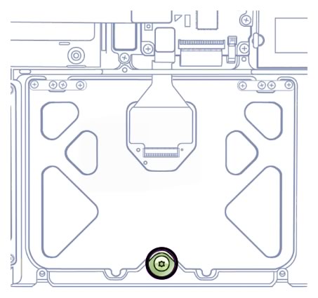

Picked up a used late 2008 Unibody aluminum MacBook5,1 Core 2 Duo 2.0 GHz to replace my wife's 2008 white MacBook kitchen computer (a MacBook4,1 which is stuck on 10.7.5 and therefore can't get any modern browser). I happened to have 4 GB RAM I wasn't using and transferred over the 128 GB SSD from the MacBook, and then installed the patched High Sierra. Everything works... except the trackpad click being a big sticky in one spot. The focally sticky trackpad has nothing to do with the patch though of course, just the perils of buying ancient used equipment. 🙁 But hey, it was less than US$150 for this now fully functional laptop running the latest OS Apple has to offer. 😵
Easiest fix ever! There is a trackpad adjustment screw. Lefty loosey, righty tighty.
Click intensity on the right and left sides are still not absolutely identical, but the feel for both is still good and the most important thing is now button clicks all register everywhere on the trackpad.
Reactions: philgxxd and Fuchal
