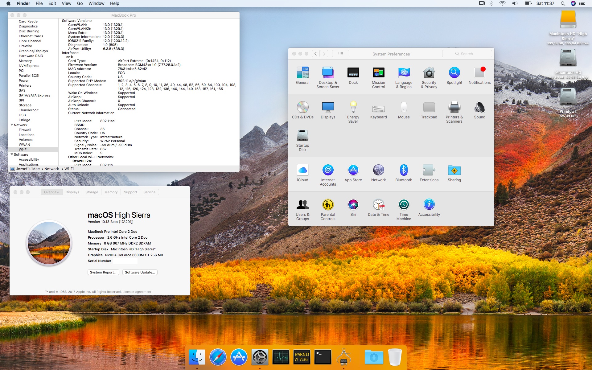

Even more off topic: I'm 90% done with patching the X3100(finally!!!) driver to load in 10.8, 10.9 and maybe later 10.10, *without* replacing any part of OpenGL.framework. can you test it when I'm done?
Just tested the IO80211Family.kext from 10.11.5 in Sierra, and this is what I get when attempting to load it (or any of its plugin kexts):
Code:
(kernel) kxld[com.apple.iokit.IO80211Family]: The following symbols are unresolved for this kext:
(kernel) kxld[com.apple.iokit.IO80211Family]:     __ZN22CCIOReporterDataStream35getIOReporterRawDataForSubscriptionEy
(kernel) kxld[com.apple.iokit.IO80211Family]:     __ZN22CCIOReporterDataStream41getIOReporterInterestArrayForSubscriptionEy
(kernel) Can't load kext com.apple.iokit.IO80211Family - link failed.
(kernel) Failed to load executable for kext com.apple.iokit.IO80211Family.
(kernel) Kext com.apple.iokit.IO80211Family failed to load (0xdc008016).
(kernel) Dependency com.apple.iokit.IO80211Family of kext com.apple.driver.AirPort.Brcm4331 failed to load.
(kernel) Kext com.apple.driver.AirPort.Brcm4331 failed to load (0xdc008015).
(kernel) Failed to load kext com.apple.driver.AirPort.Brcm4331 (error 0xdc008015).
Failed to load /System/Library/Extensions/IO80211Family.kext/Contents/PlugIns/AirPortBrcm4331.kext - (libkern/kext) dependency load failed.
