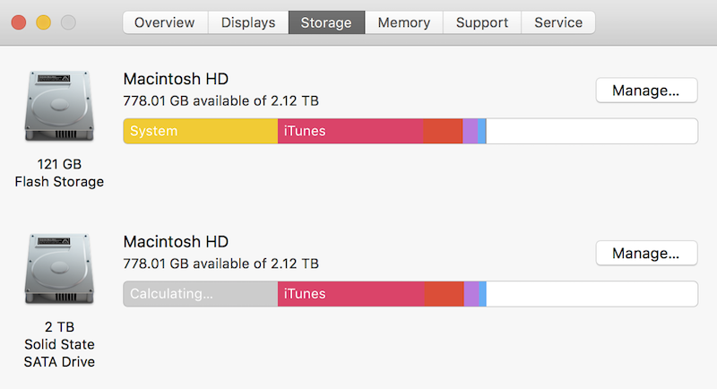

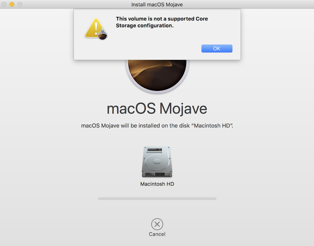

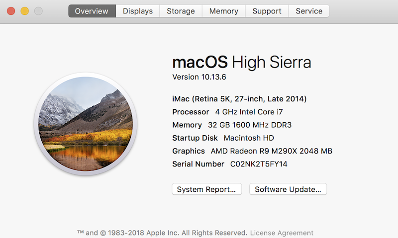

I'm trying to install MacOS Mojave on my late 2014 iMac with SSD and I keep getting the error message:
"This volume is not a supported Core Storage configuration."
Is there anything I can do to get Mojave installed properly? This is very frustrating... I can't believe a google search turns up no help on the subject as well, am I really the only one?

OK So I've booted into the USB drive to install it, and I'm getting the same error... I went into disk utility and clicked First Aid, but it finds nothing wrong with the Macintosh HD.
There has to be a way to solve this...

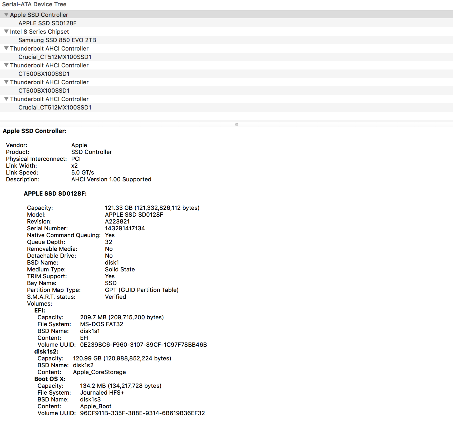

The installer might not like that MS-DOS FAT32 partition.
Nope, that's the EFI system partition that all EFI disks are supposed to have per specification.
Trivia: Apple never has officially used the EFI system partition for anything, but they create it per the specification. Other operating systems like Linux will use the EFI partition to store the kernel and bootloader and so on. EFI is actually a sort of "mini-OS" that is contained in the system firmware, and things like bootloaders, utilities, BIOS flashers, etc. are written as EFI applications. Macs basically have the bootloader that can load the OS from an HFS or APFS partition baked into the firmware so it isn't necessary to put the bootloader in the EFI partition.
FAT32 is the specified filesystem for the EFI partition, thus allowing any EFI implementation to be able to read the EFI partition. (Hackintoshers actually use the EFI partition to store the mods/drivers/etc....lol) If you were to dual-boot your Mac with Linux, say, you'd likely be using the EFI partition for Linux's bootloader.
