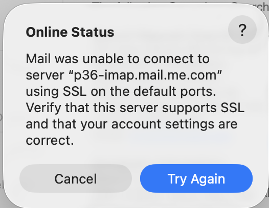

Mail won't connect to iCloud with my @me.com. And I can't find a way to update the settings.
a Reddit comment had the likely answer. network filters like AdGuard seem to cause the problems.

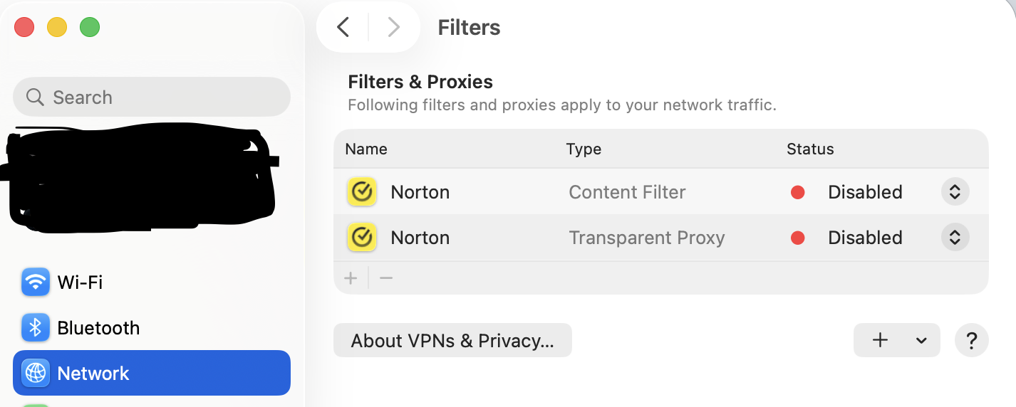

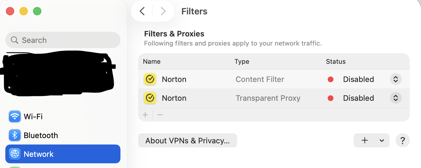

I have norton and disabled the filters and it worked for me. Give it a try. Here is screenshot.
I tried that, but they wouldn't stay disabled. they would turn back on after a few seconds. I had to uninstall the entire program. Funny that Firefox worked properly the entire time. It seems that I only lost internet access for apple products.
