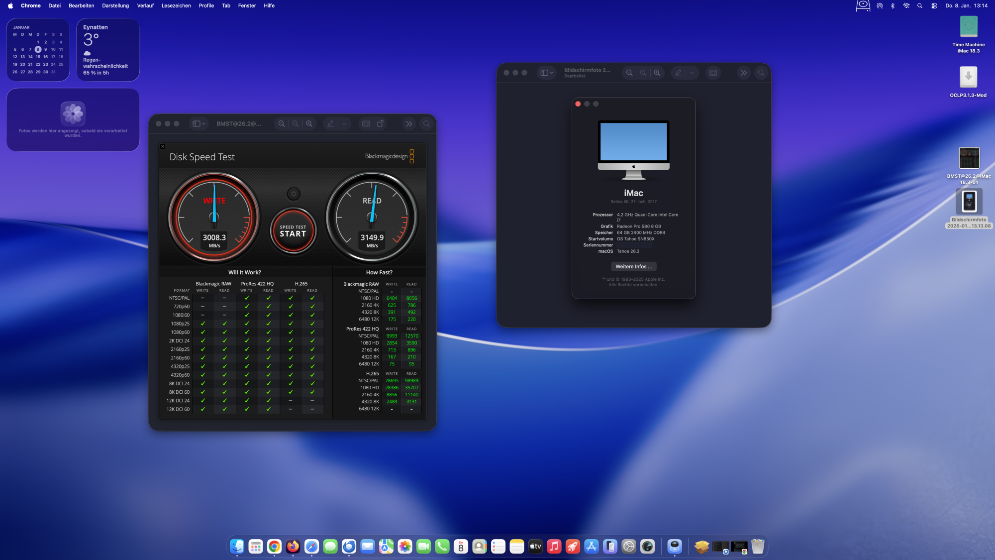

Slow and steady wins the race... 😉
Sometimes patience is the key.
Since my previous attempts to patch Tahoe 26.2 always ended in a boot stop, I tried again today.
Of course, I always performed a clean install of macOS 26.2 to avoid any issues caused by OCLP remnants from the previous version.
Today I used the OCLP3.1.3 mod, whose earlier versions repeatedly forced two patches all together — Wi-Fi and audio— which caused the boot stops. I then booted 26.2 with the newly created OCLP3.1.3-Mod - as usual on a USB stick.
It completed successfully, and then I applied the patches.
What exactly happened was a bit difficult for me to follow—I don't speak/read Chinese. 😀
I was following the instructions for an OCLP 3.0.0 as template and started downloading a KDK build, which prompted me to restart after it finished.
So far, so good.
It always stopped at that point before. "This is going to take a while," I thought and went next room to get something else.
When I came back, the iMac display was showing a wonderful Tahoe blue. So much for a freeze. 👍
Looks like they've fixed it. 🙂
That's definitely an improvement, and now there's also the audio, which I previously suspected was causing the Modern Audio issue together with Modern Wireless.
Bluetooth wasn't a problem at all, but Modern Wireless still seems to be a bit glitchy.
I do have a LAN connection, but the Wi-Fi connection still needs to be sorted out.
... But now I can actually work properly on the fully equipped 18.3 iMac @ Tahoe, because previously unresolved issues like LAN and audio are working. 🙂
One thing is also clear: I don't need a 27" iMac 2019 or 2020, not even a 24" Silicon iMac.
The 18.3 iMac is perfectly adequate for my needs. 😀
It looks like by that screenshot you even have graphics acceleration working based on the dock, and menu bar. I was looking through your signature and I think the iMac 18x family still have supported graphics in the most current macOS versions, correct?
Reactions: LuckyOldMan
It's Polaris with AVX2 CPU, so yeah it's native.
Yes - you're right.
