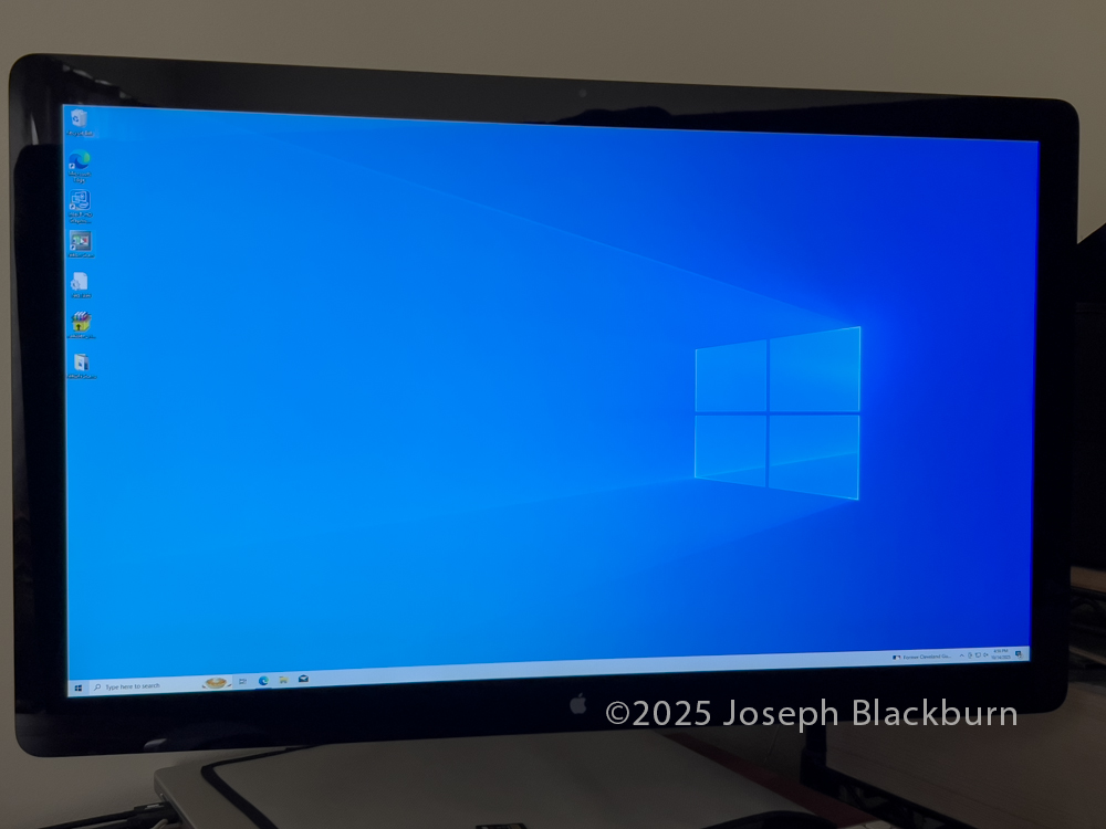

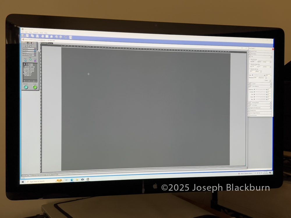

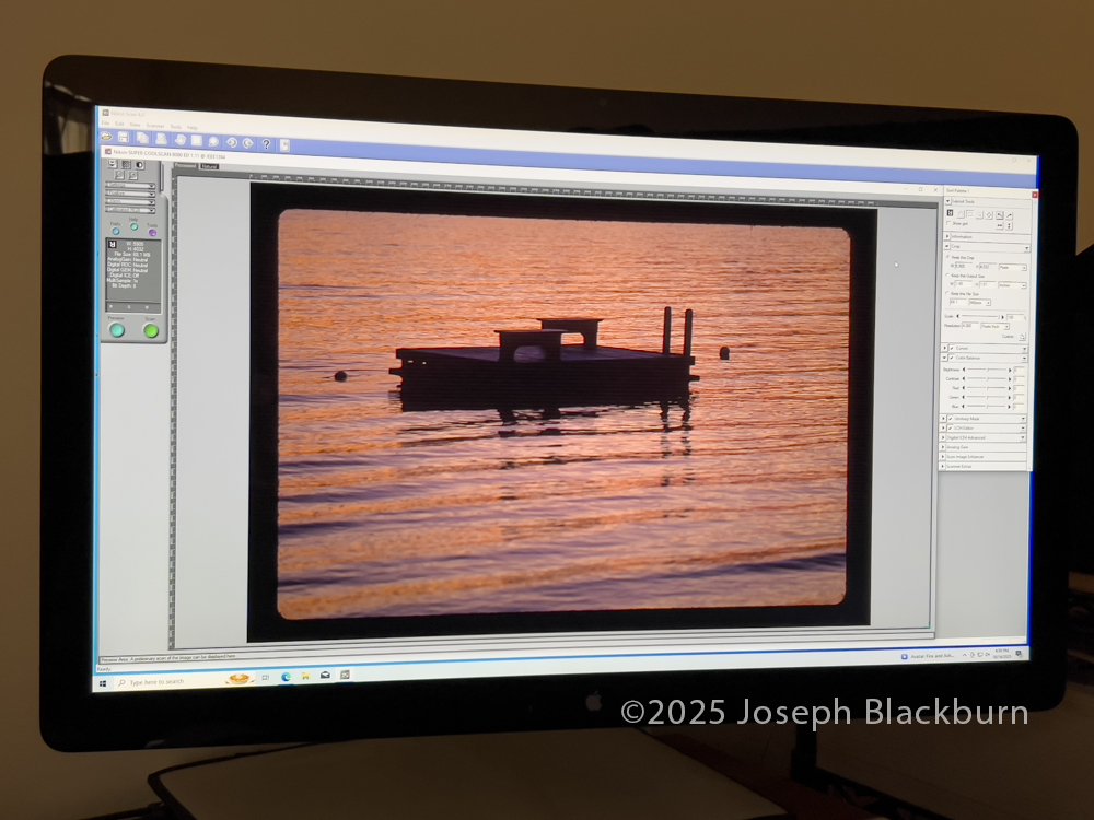

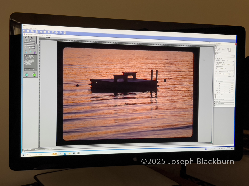

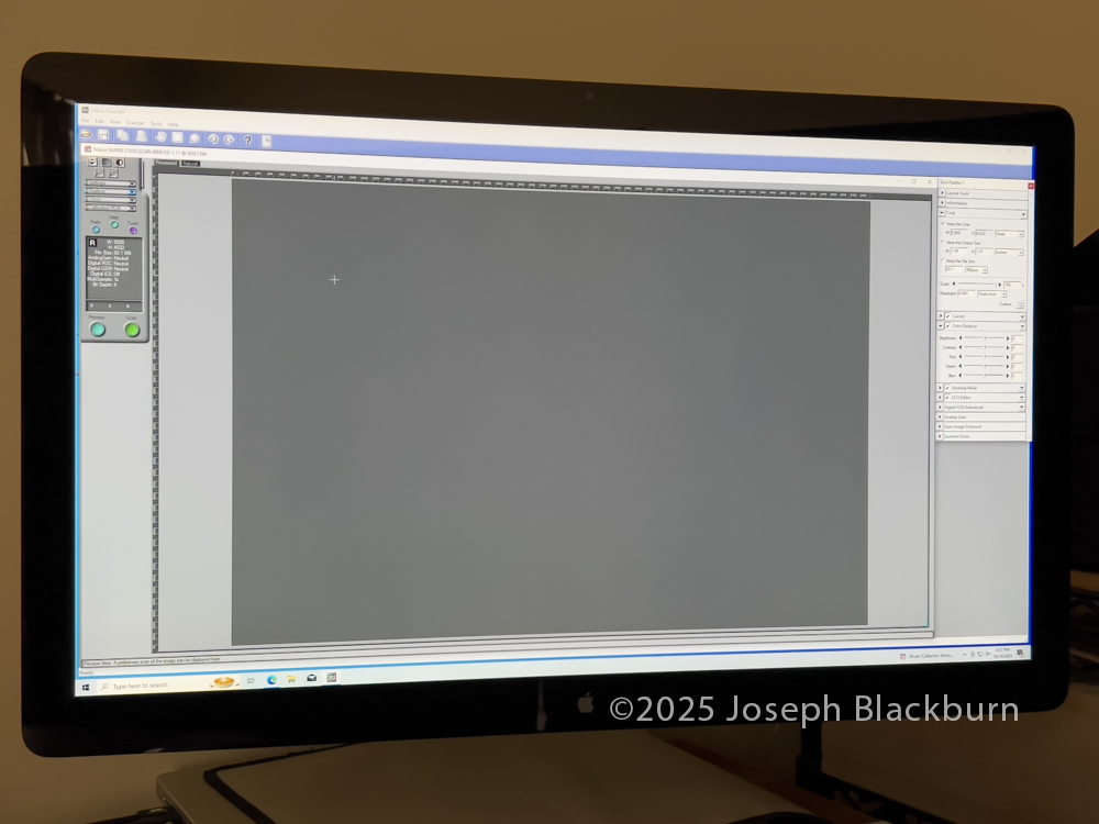

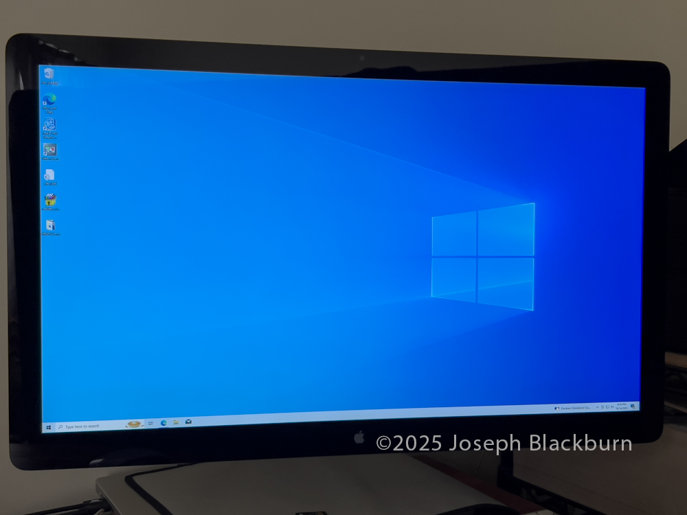

Hi, came across your mention of maybe needing to go to you MacMini to use your Nikon Coolscan. I had similar issue and did this to solve the issue:
"I worked on setting up my 2012 MacMini6.2 computer, connected to an Apple Thunderbolt 2, 27" Display to get Windows 10 and Nikon Scan 4.0.3 up and running. It is now up and running Nikon Scan under Windows 10 software.
The 2012 MacMini came out originally in two versions, one was 6.1 as a normal computer and the other as 6.2 as a server computer. This one is the server unit, but there's not any significant difference, both had a quad-core processor of which the 2014 and 2018 units did not. It came with a HGST 1TB 5,400 RPM drive as the top drive which was being used as a Time Machine backup of the other 250GB drive. The second drive was a Western Digital WD Blue 250GB SATA PC SSD. I ran both Blackmagic Speed Disk and AJA System Test Lite on both drives and decided to replace them, as I was only getting about 49-54 MB/Sec write and read speeds. I decided to install in the lower slot a SAMSUNG 870 EVO 500GB SSD as the system disk on which I installed MacOS Mojave 10.14.6, and I am now getting about 490 MB/Sec write and 525 MB/Sec read speeds. In the upper slot I installed a SAMSUNG 870 EVO 1TB SSD as a separate system disk on which I installed MacOS Catalina 10.15.7 and got the same speeds when tested.
Currently I have no plans to install any programs on either, but may install some of ADOBE's Creative Suite 6 so I can run InDesign when needed. I use my newer MacBook Pro M3 Max to run Photoshop, Lightroom and ON1 software for images.
Now for Nikon Scan. I chose to use the 500GB drive running MacOS Mojave to partition when I used Boot Camp to install the Windows 10 iOS installer. The partition size was made to about 150GB and the other side left for Mac OS. Then once that was successful I booted up Windows 10 to install the Nikon Scan 4.0.3 and make sure it was working properly."
I can provide more details on the setup procedures if there is any interest. Cheers

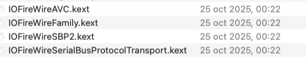

All hope is not lost.
In the attached screenshot you can see that the FireWire drivers are still present in macOS Tahoe, but not active.
System —> Library —> Extensions
Yep. They certainly are there—you're about the zillionth person to point this out on various boards. So what?
Doesn't mean a thing—no one is making it work. Copying over those and other FW support libraries from Sequoia doesn't work either—many of us have tried.
Apple has a toolkit for writing new drivers and those libraries may support them—or not. No one knows because the hardware makers would have to write drivers to support their gear. Apple dropped direct FW support in 2013 and the hardware makers did the same. No one is going to jump back in because there's no point in doing so.
You are also ignoring the fact that direct FW support in CoreAudio went away in Ventura. Also that FW800 was about as fast as USB 3.0 and most devices operated over FW400; nothing can make them faster.
How many times has Apple backtracked on decisions like these? Not once, not ever.
So, if you really think there's "hope", then please, do us all a favor and figure it out. Then tell us all about it.
Otherwise, in the words of Dr. McCoy, "It's dead, Jim"
