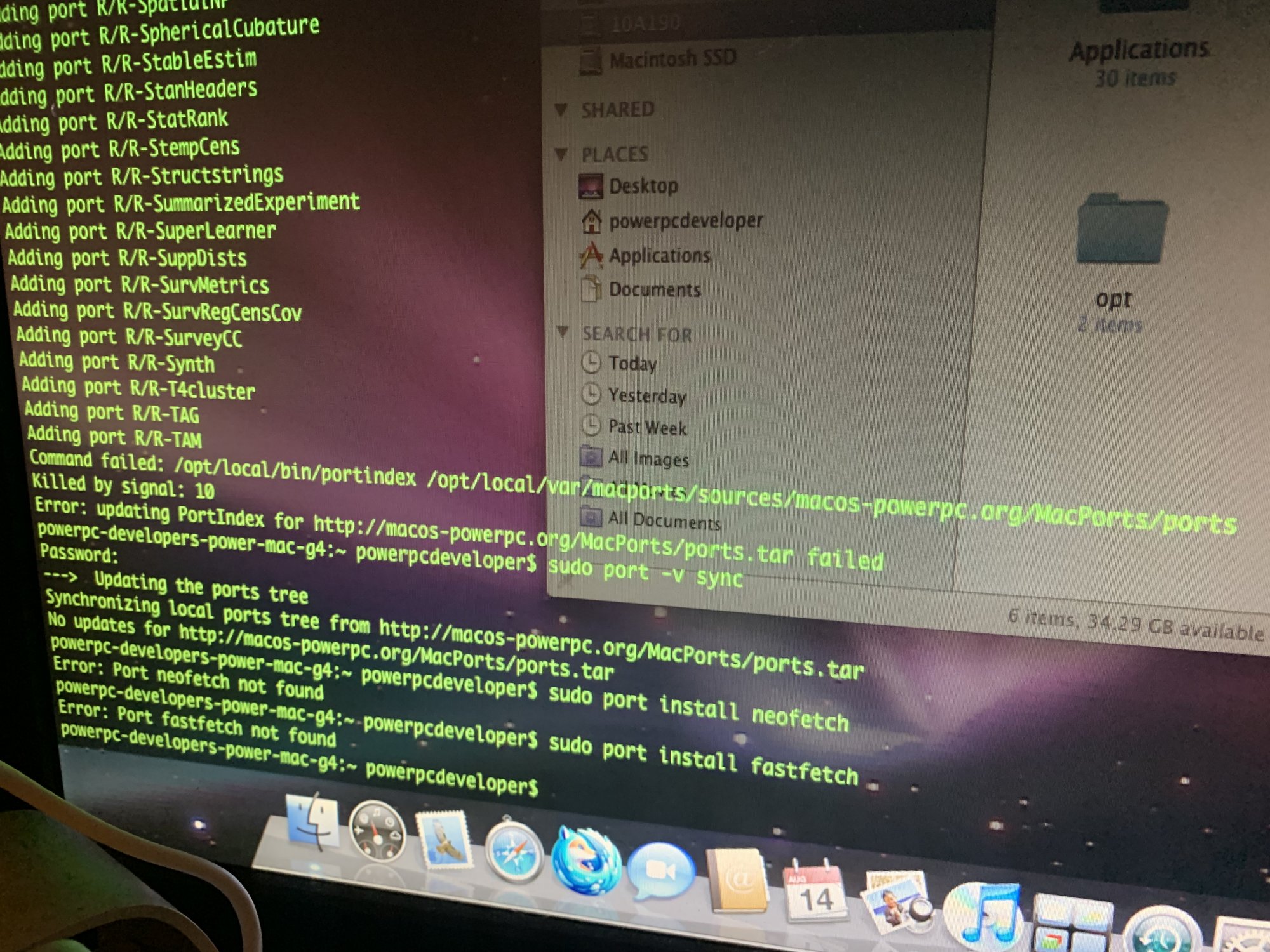

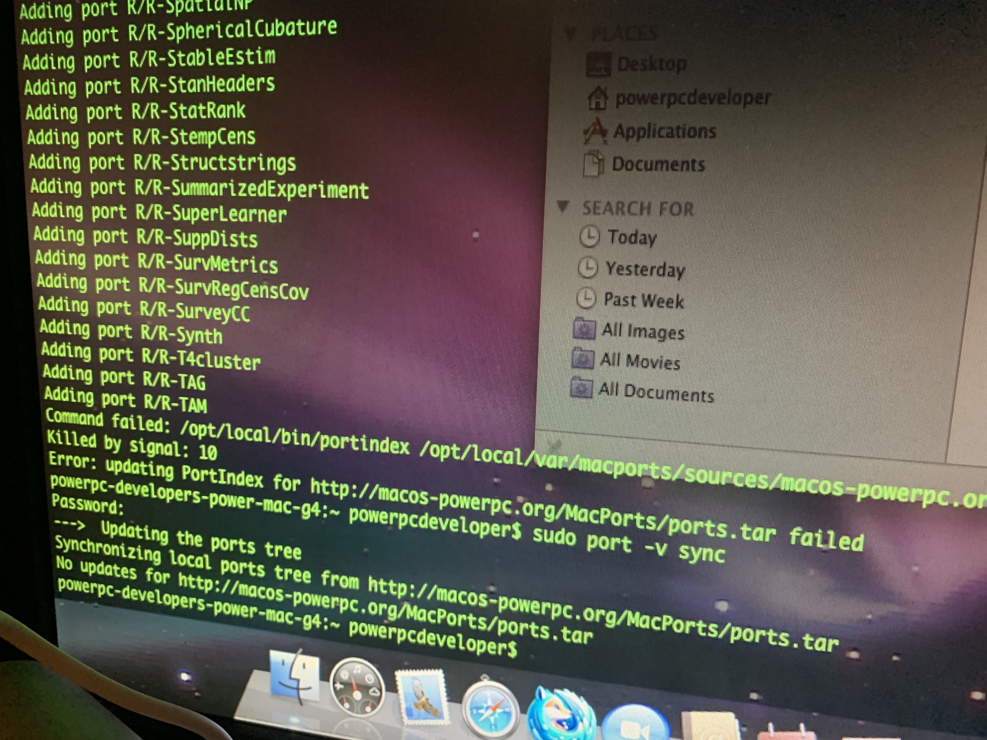

Hi @barracuda156!
Both installer packages for MacPorts and bootstrapped Curl installed on 10A190 as expected. The installer did not export the paths however so adding the lines manually to the users .profile is currently required - please add to your instructions for new users.
Currently running Sudo Port -v Sync and seeing a lot of errors…
Will leave it synching for the moment and evaluate properly later.
I haven’t modified any of the default config files, just removed the appended ‘default’ at the end of each of them as i assume the necessary changes have been implemented already in your installer?

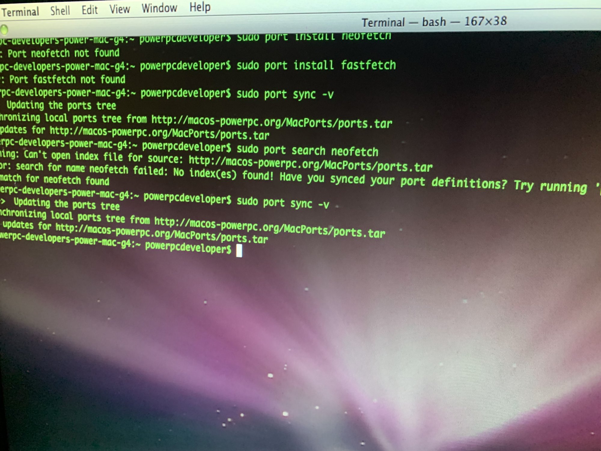

Running port sync a second time there were no errors, however the port index sync failed and now it isn’t possible to install ports…

It should be sudo port -v sync. (You have -v in a wrong place in a command on the screen.)
Everything works fine on my end. Could you please retry? Since you have no ports installed, you may just trash the /opt/local directory.
Just in case, rename conf files via `mv`. To make sure macOS does not add an invisible extension, that will prevent them from being read.

Pretty sure the first attempt was sudo port -v sync and the second screenshot when i was trying to install ports and discovered the port index wasn’t working i’ve clearly written ‘sync -v’ but will try again with the correct syntax when i get home to be sure.
If the error on your end will be reproducible (port groups not found), I will suggest how to debug.
P. S. Please install from scratch, not as an upgrade to existing installation.
Unfortunately same result starting from scratch. I will nuke it and try without installing the bootstrapped Curl.

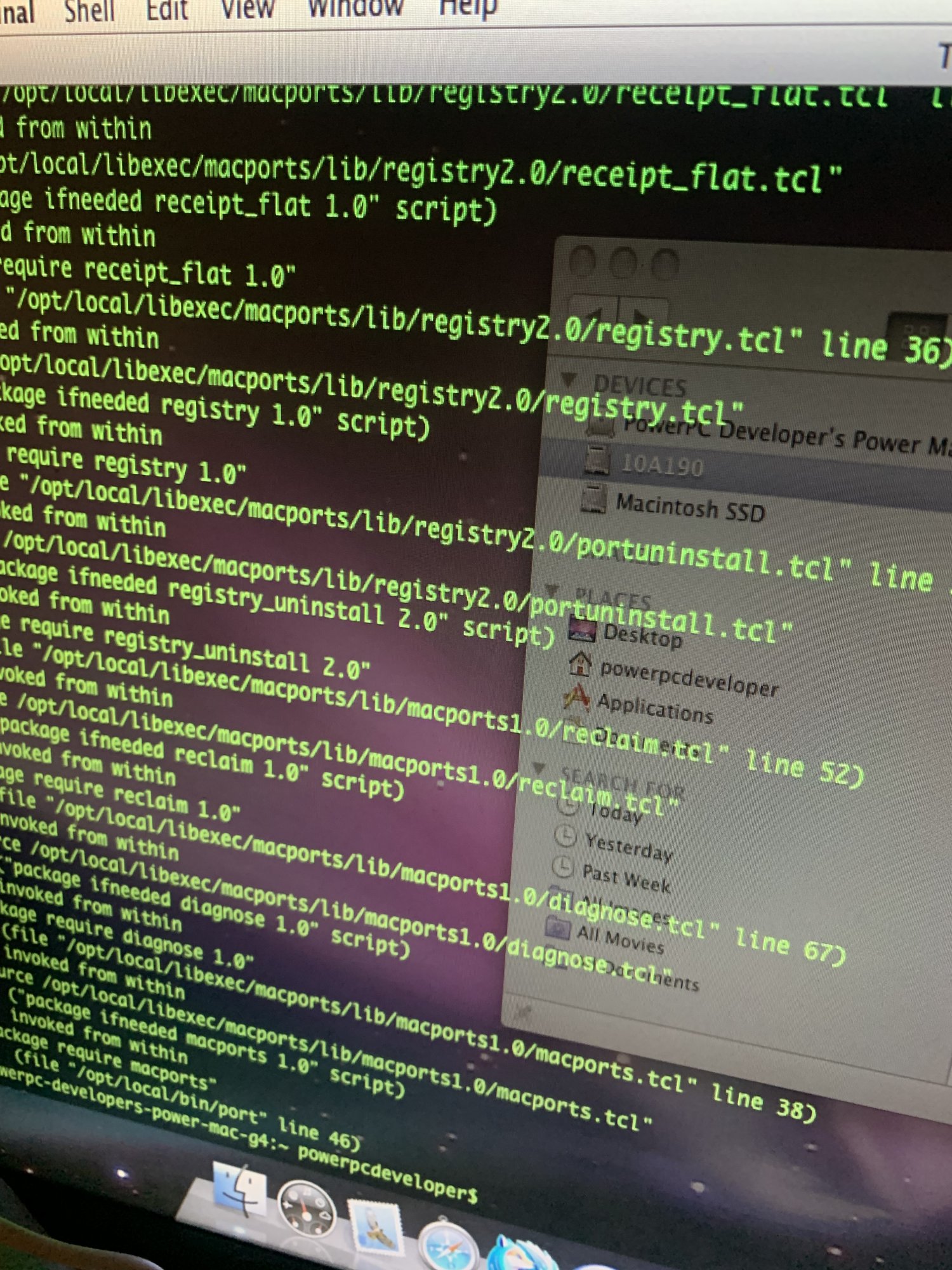

Nope. Looks like i’ll have to try updating curl from source. As and aside the apple provided Tcl is broken even in retail Snow Leopard so needs to be updated anyway on our systems.

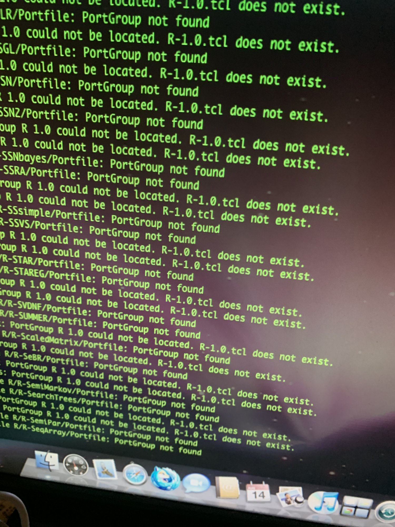

Wait, this does not look the same to me.
Originally the issue was that for some reason the Portgroup was not recognized, as if it does not exist. That was strange and I have no explanation to it. This issue cannot be on MacPorts upstream side, I think.
Everything after that appears to be a different problem – that registry database was corrupted due to an interrupted install (or some other reason), and cannot rebuild itself. This may well be upstream issue.
What happened in the third case? I see that no errors with R portgroup are displayed, but then process is suddenly interrupted.
I got no idea what’s going on mate. The R errors only showed up the first time. It’s very strange.
