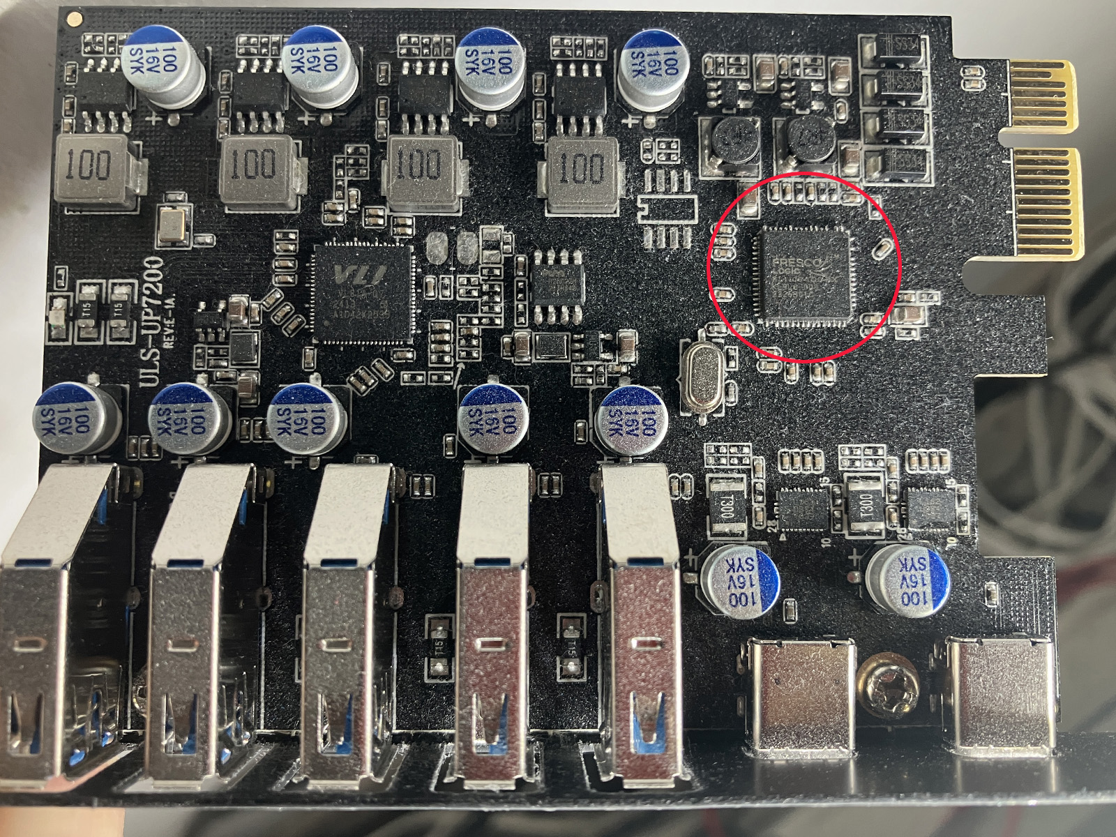

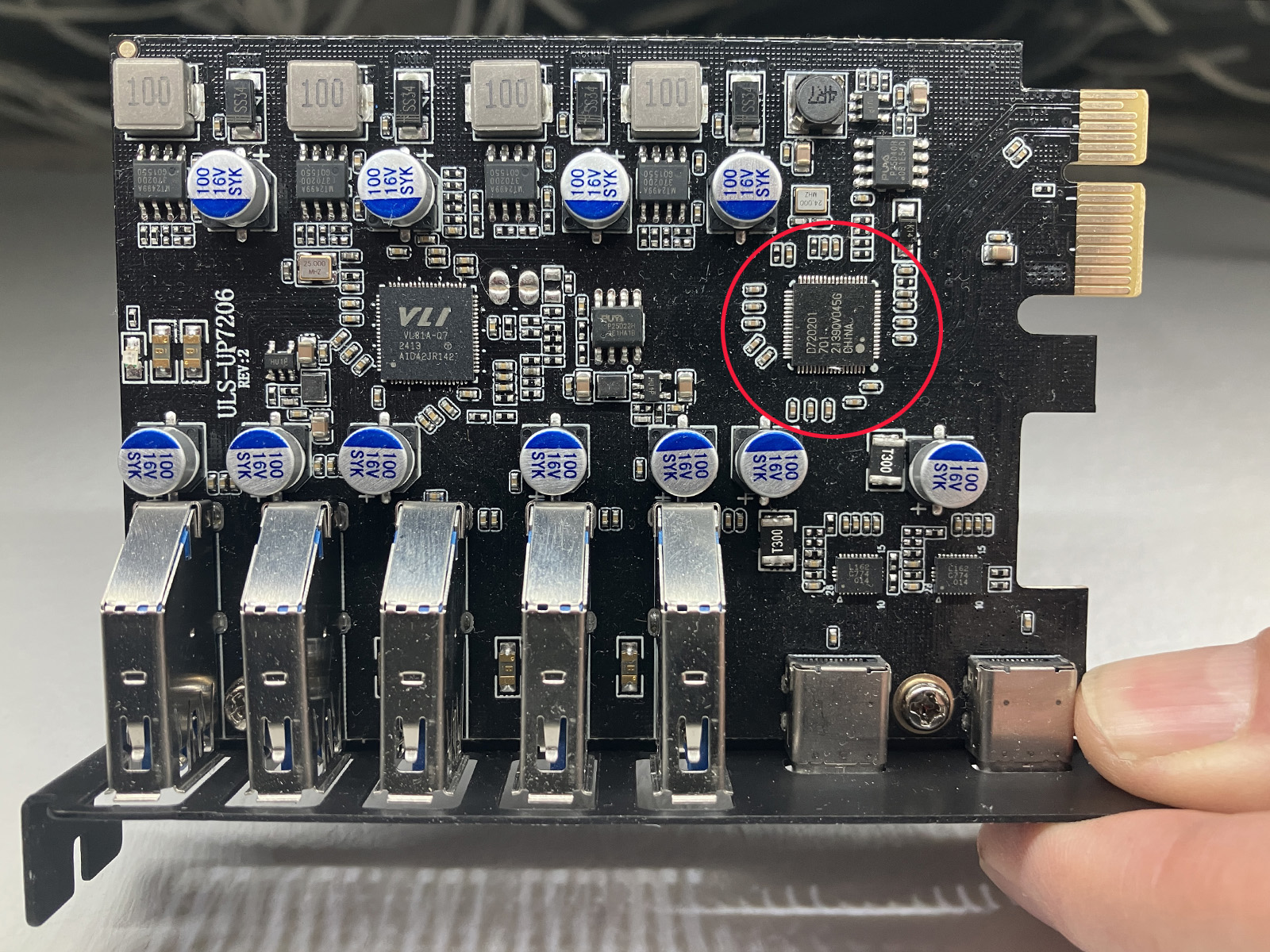

Ok, I investigated what the problem could be and where the difference is. The difference, as expected, is in the USB controller chip. Although the cards physically look completely identical, the one with the Fresco chip works on a Mac, while the one with the D720201 chip does NOT work on a Mac.
What you need to be careful of is that many AliExpress sellers take copy&paste descriptions without really checking whether something works on a Mac and even copy into the description that the card uses a Fresco chip, when in fact it has this replacement one that is not Mac compatible. Then they write in the description that the card is "MacOS 10.8.2 Above" compatible and they don't check if Fresco has a chip or a replacement.
Be sure to ask the retailer to double-check that the controller is a Fresco and not a replacement.

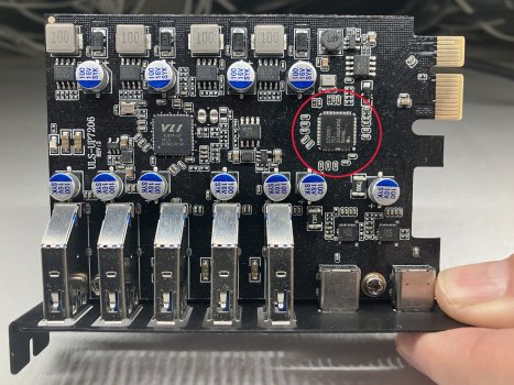

I can confirm that this version of the card works great:
