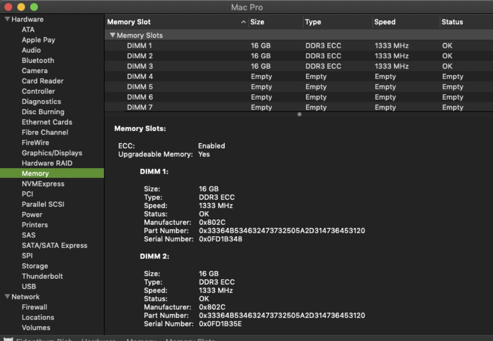

Go to About this Mac > System report > Memory and see if the ram has Status = OK
krakman. Thanks for your advice. In System Preference, all the RAM says OK. (would it even start up if there was a RAM problem..??). I've got 22Gigs, 6 of which came with the computer, and are all labeled the same. RAM was one of my first thoughts, so I'd taken it all out, and just rotated in 2 of the original 6 sticks, in hopes of finding one (or 2) that was causing the problem. But you have pushed me in the direction of this being a RAM problem. I did download memtest, and am running it while in Maverics, which seems to have a lesser RAM footprint that some of the more recent OS's. And as I'm wiring this, of course, the computer just froze, so now I'm going to go back to square 1 with RAM, take it all out except for some of the original sticks, and run the memtest more to try and isolate the problem. I use this computer mainly for accounting, and starts up in the morning and shut downs at night on schedule, and has been great up 'til this last week. While I suspose this is a RAM problem, I'm not thinking of ways and things that my have damaged them all in some fashion, while the machine was running... or even NOT running.. a very close lightning strike perhaps... this computer is at my office and I'm not there 24/7 so it could have easily been something like that. It IS plugging into a battery UPS, but the RAM is damaged, I don't doubt it may have come in thru the AC as well. Anyway.. thanks for your tips. I'm hoping this is really a RAM problem, and not a power supply one.
Yes, you can start a Mac Pro with problematic RAM. ECC error correction make more troublesome to find some types of RAM errors, most that happens after some temperature only are difficult to track.
