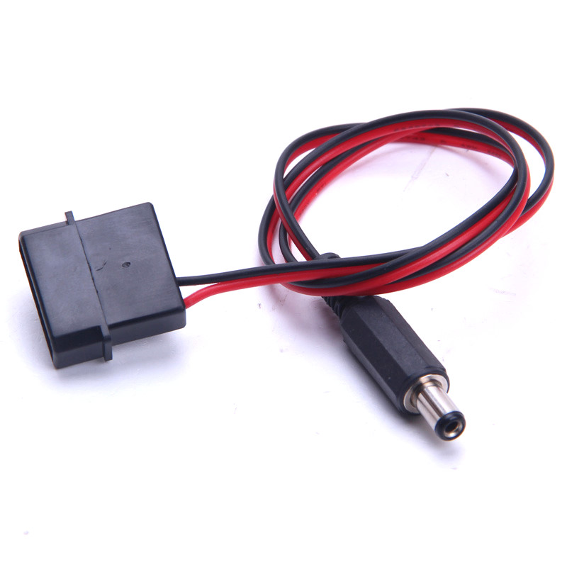

Years ago deep down inside Vault 1304 , built by Vault-Tec before I moved in , I placed in storage an external USB floppy drive compatible with Mac OS X in order to help a friend who needed to transfer files from an ancient Quadra 700 into a more modern PowerMac G4 . I am not certain if it will work in an Intel Mac running OS X , but if it does it would not be difficult to obtain a PCIe USB card with an internal data connector and snake an USB cable into the Optical Drive Bay and fire it up with the Mac Pro 1,1 (2006)'s Molex power connector , with a Molex to DC adapter available from ModDIY .
