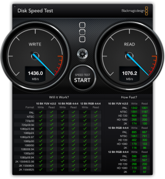

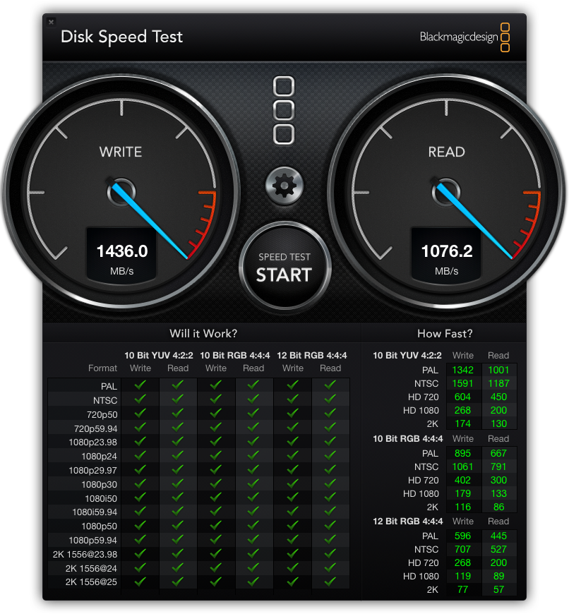

I edit 4K on my 2008 all the time. I have a RAID setup

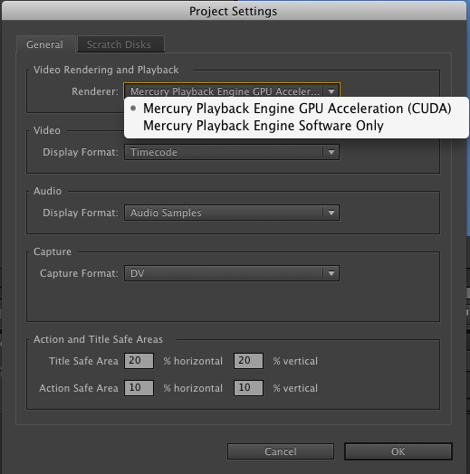

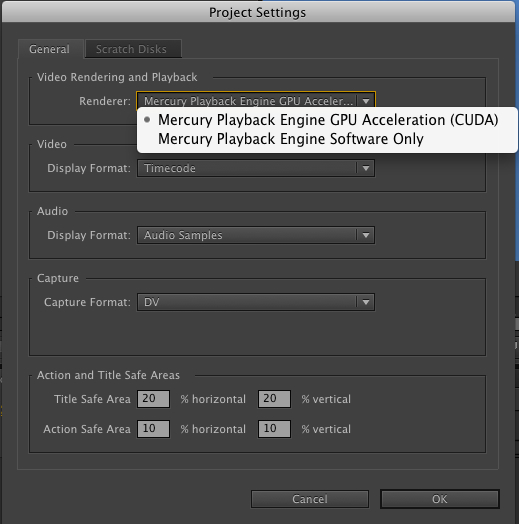

This is done in AVID 8.4.4 If you do it in Premiere try the both ways
Using the CUDA cores and the Ram

every thing i read about adobe and there apps says the GPU does very little once you have a GTX650 or faster, so 960 is fine just massive overkill and wont give much of a boost. CPU is still the most important thing, most the time.
https://www.pugetsystems.com/labs/articles/Adobe-Premiere-Pro-CS6-GPU-Acceleration-162/
list of gpu effects
https://helpx.adobe.com/premiere-pro/using/effects.html#gpu_accelerated_effects

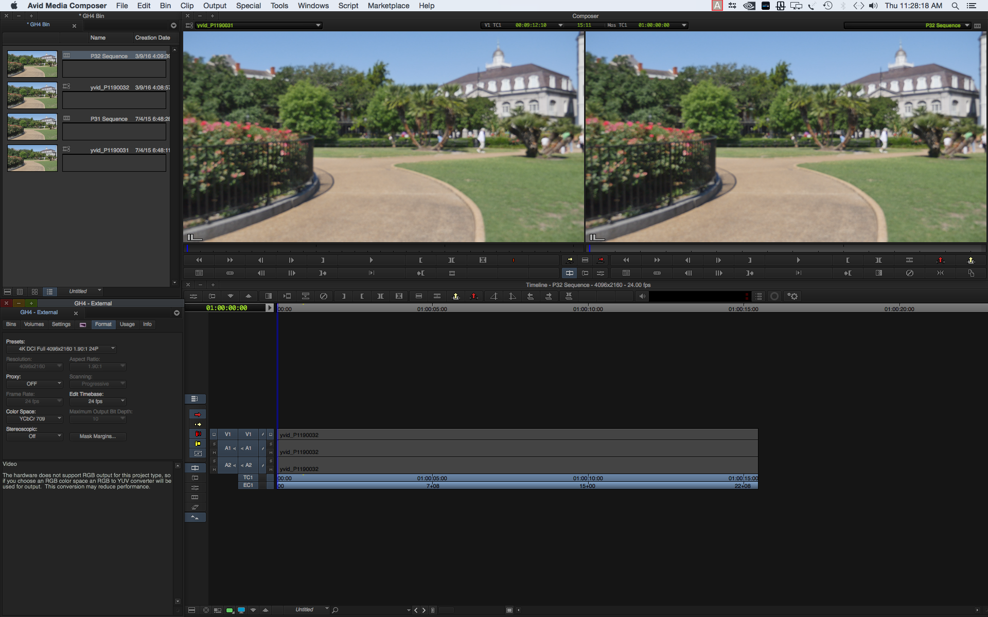

If you are not able to play/edit 4K on your current 3,1 setup do the following
1. Try in 1/2 or lower resolution.
2. Import or AMA the footage depending on your app
3. Transcode to something your "system" can handle
4. Edit
5. Relink to 4K files
6. Export
Photo of Panasonic GH4 footage in Avid 8.4.4
