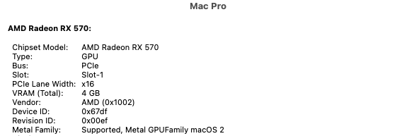

Hello. I have a mac pro 5,1. Did a fresh install of monterey with oclp and with my rx570 installed. System information says "No kext loaded" for the rx570 and I get no video output from the card. Any suggestions??? Can't figure this out!

Thanks. I did the post install patches. They’re all up to date, rebooted and still says ‘no kext loaded’. Opencore is completely up to date on my system. Been dealing with this for over a month now and can’t fix it.

I had a similar experience with my MacPro4,1/5,1 and Monterey. An Nvidia card would work but I would get no output with a RX570. I tried different things and eventually tried booting from an EFI from OCLP 4.4. I then got video output back from the RX570 and could update OCLP to the current version without further issue. Something got changed but I don't know what.

Unfortunately this did not work for me. Tried a few different oclp versions with no luck. Guess I’m just stuck with this issue, unless I just downgrade back to high sierra. Thanks for your suggestions.
