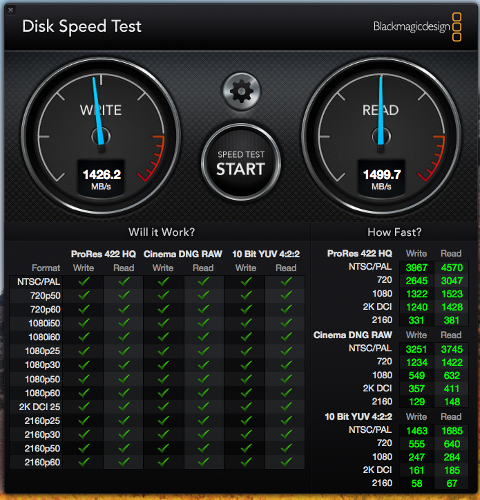

@tsialex I just installed my NVME Samsung 970 EVO, did a clean HS install on NVME and copied my system disk to NVME.
Boot from NVME works perfectly, even with HDD removed, recovery also works without installed HDD. When I switch on the computer it takes approx. 16 seconds before the chime, after the chime the computer logs on approx. 15 seconds later, total logon time approx. 32 seconds.
The only small thing is that my NVME disk is identified an an external disk.
THANK YOU!!!!!!!!!!
