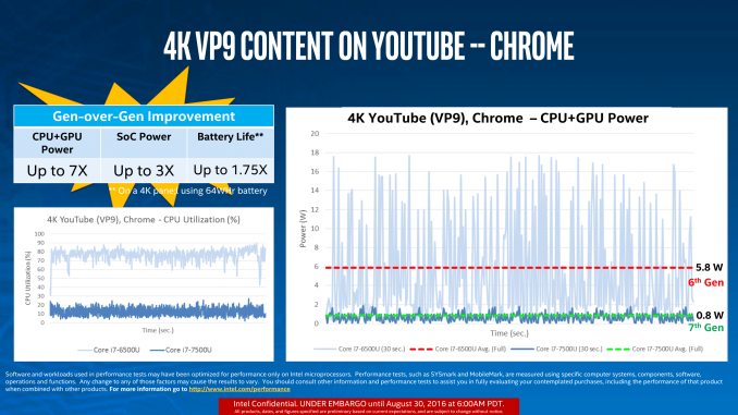

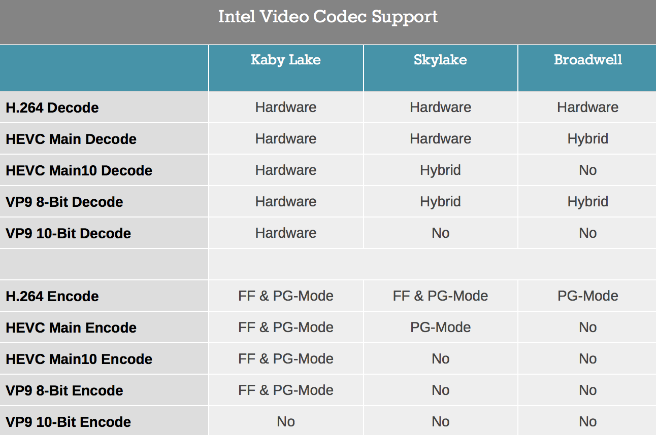

HEVC decoding (Netflix and iTunes) is much, much harder than VP9 decoding (YouTube). While some older machines can do 4K VP9 (albeit using a LOT of CPU cycles), those same machines can't do 4K HDR HEVC decode. Hardware decoding is required for 4K HDR HEVC.
However, 4K HDR HEVC per se does not necessarily require T2 either. Kaby Lake or later Intel iGPUs also support this in hardware.
BTW, Kaby Lake or later Intel chips also have full support for VP9 decode in hardware. There is limited hardware VP9 decode support in earlier Intel chips though.
P.S. The above table represents one of the reasons I chose to buy a MacBook and iMac in 2017. Both are Kaby Lake.

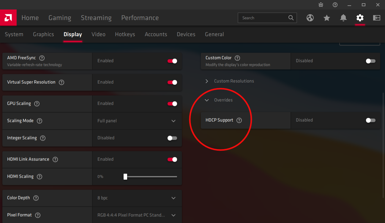

Netflix does not support AMD GPUs on the Windows side for 4k/HDR. Could this have anything to do with it? Apple's discrete GPUs are all AMD-based.
AMD does support HDCP though. Might not be understanding your point correctly.
That was my initial thought, but what exactly is the DRM here?
Everyone playing high definition contents needs to support HDCP, which is some technology that encrypts the video between your graphics card and the monitor. So that evil hackers can't record a video directly from the output of your graphics card. And then you have to make sure that HDCP cannot be turned off. So it's DRM that is completely invisible to you as long as it works. A typical sign of it is an external monitor that suddenly just shows snow and you have to unplug it and plug it back in, because usually _everything_ is always encrypted.

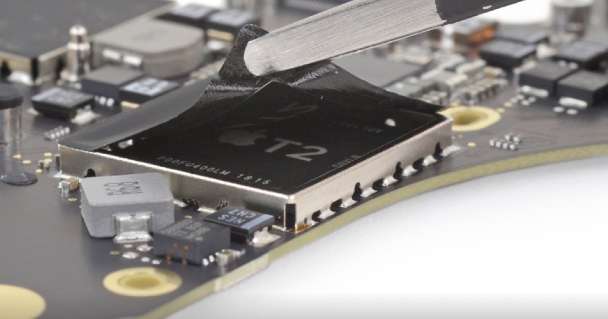

T2 has hardware acceleration capabilities for video. That’s why it’s required.
With Windows, it’s possible but you’re going to lose out on performance and battery life since it’ll probably use software decoding. Apple thinks that’s bad UX so they put a requirement on.
