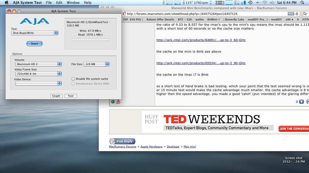

to illustrate look at a short aja test on a 320gb hdd allowing the hdd's test to be included

your welcome I just posted an example above on including the cache for an hdd test look at it! It reads at 1978 MB/s LOL

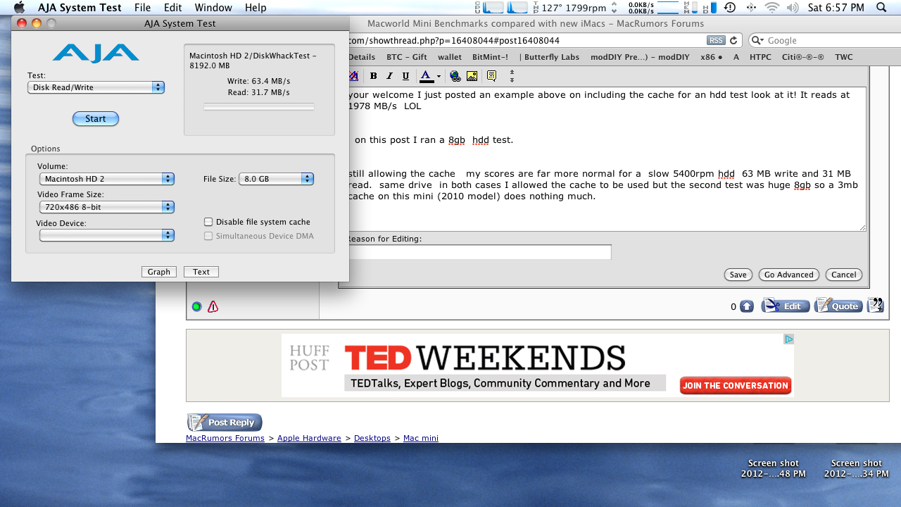

on this post I ran a 8gb hdd test vs the 128MB test
still allowing the cache my scores are far more normal for a slow 5400rpm hdd 63 MB write and 31 MB read. same drive in both cases I allowed the cache to be used but the second test was huge 8gb so a 3mb cache on this mini (2010 model) does nothing much.
