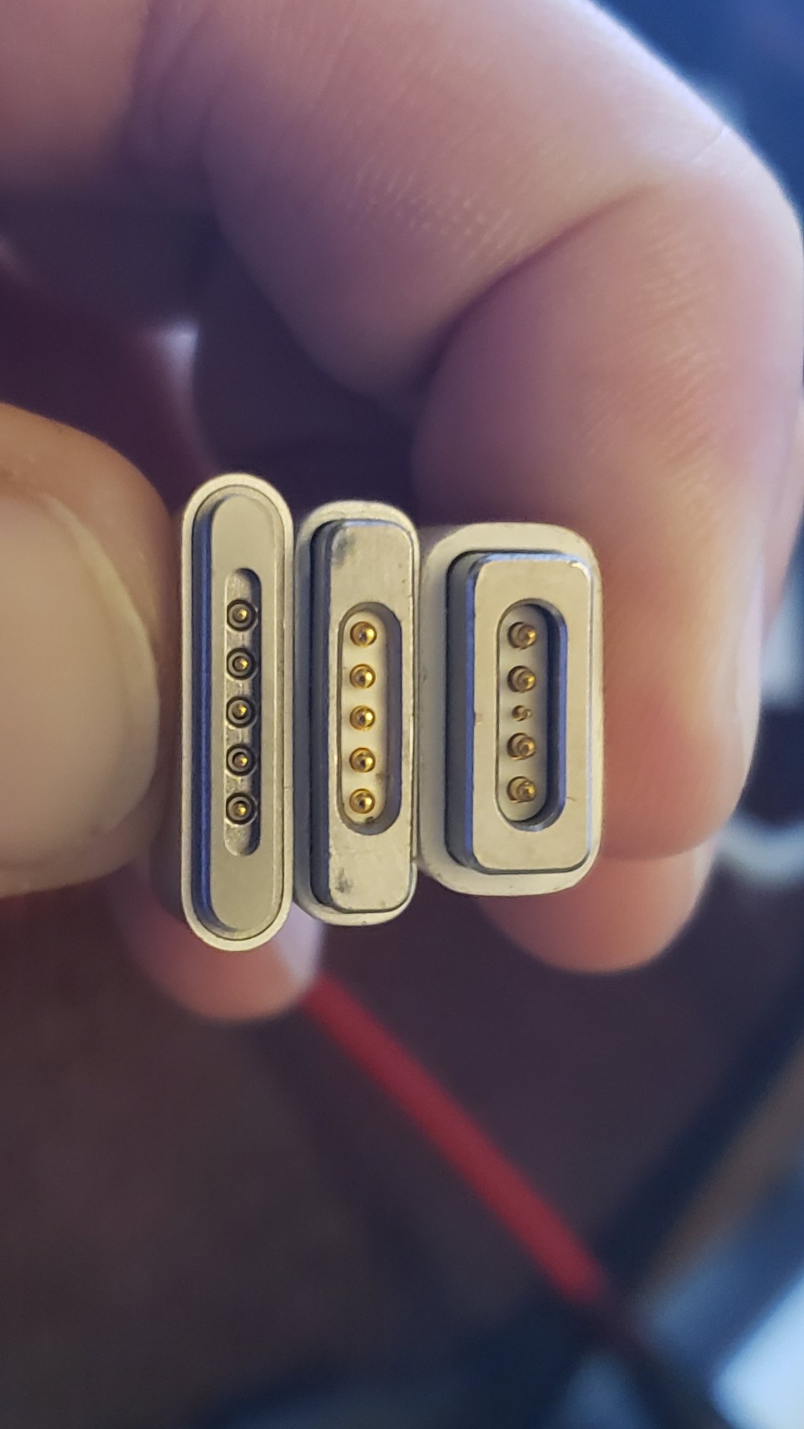

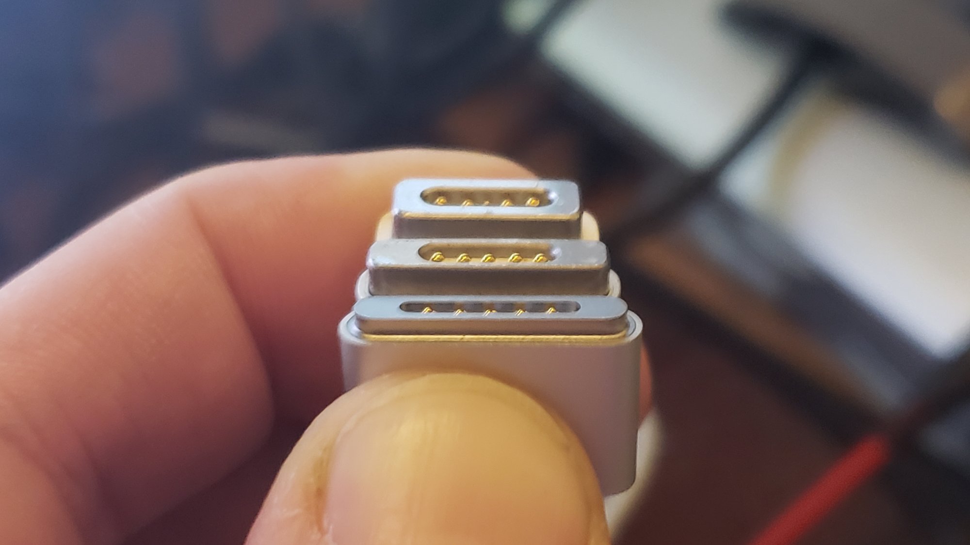

Photos from my dremel modifications
One is a 27 LED Cinema Display MagSafe1 connector dremeled down the long sides to also fit into MagSafe2
The other is a USB C to MagSafe2 cable dremeled down the short sides to also fit MagSafe1
I've tested with MBA2009, MB2009, MBP2008, MBP2010, and MBP2015 and both cables work with all Macs.

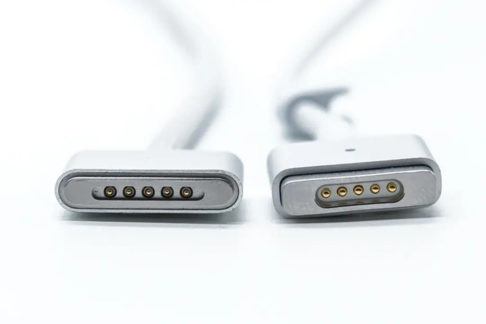

Here's a side-by side comparison of the Magsafe 3(left) and Magsafe 2(right) connectors...
From the same page that came from, I found this tidbit:
Supporting PD3.1 is the biggest highlight. It can also be used with a third-party PD charger. Selling separately means that this cable may not only be designed for these two models.
I know from personal testing that the 14" M2 MBP can also charge over its USB-C ports via a USB-C charger that supports PD, so I'd assume that you could take the Magsafe 3 cable and use it with a third party USB-C PD charger as well.
While all MagSafe versions (1, 2, and 3) work with 20V USB C PD chargers and the proper USB C to MagSafe cable, the MS3 doesn't seem to be compatible with MS1/2 as not only is the length, width, and depth different, but sadly also the pin spacing as well, something Apple didn't need to do but did it anyway.
