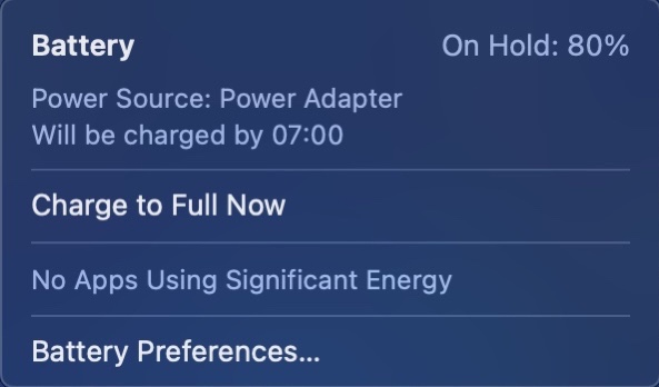

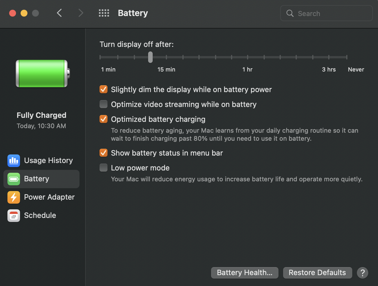

If you have "Optimized battery charging" turned on it should stop at 80% if you regularly use the device while plugged in. I've noticed it doesn't exactly stick to that charge percentage and will eventually top off based on when you most often go off the charger, so there is some learning and logic on the feature's part that anticipates your habits. I really suggest using this feature. I've had my Mac since launch day and still have 100% battery health despite being plugged in most of the time so it seems to do its job.
As for the OP's question, the light will only be green when it is at 100% charged in my experience.
