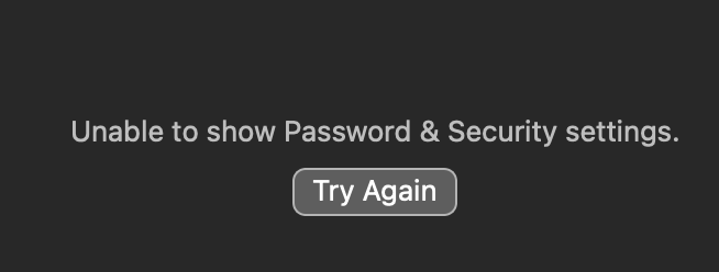

[edit] - I just went in to System Settings > Apple ID > Password & Security and got this interesting message:
