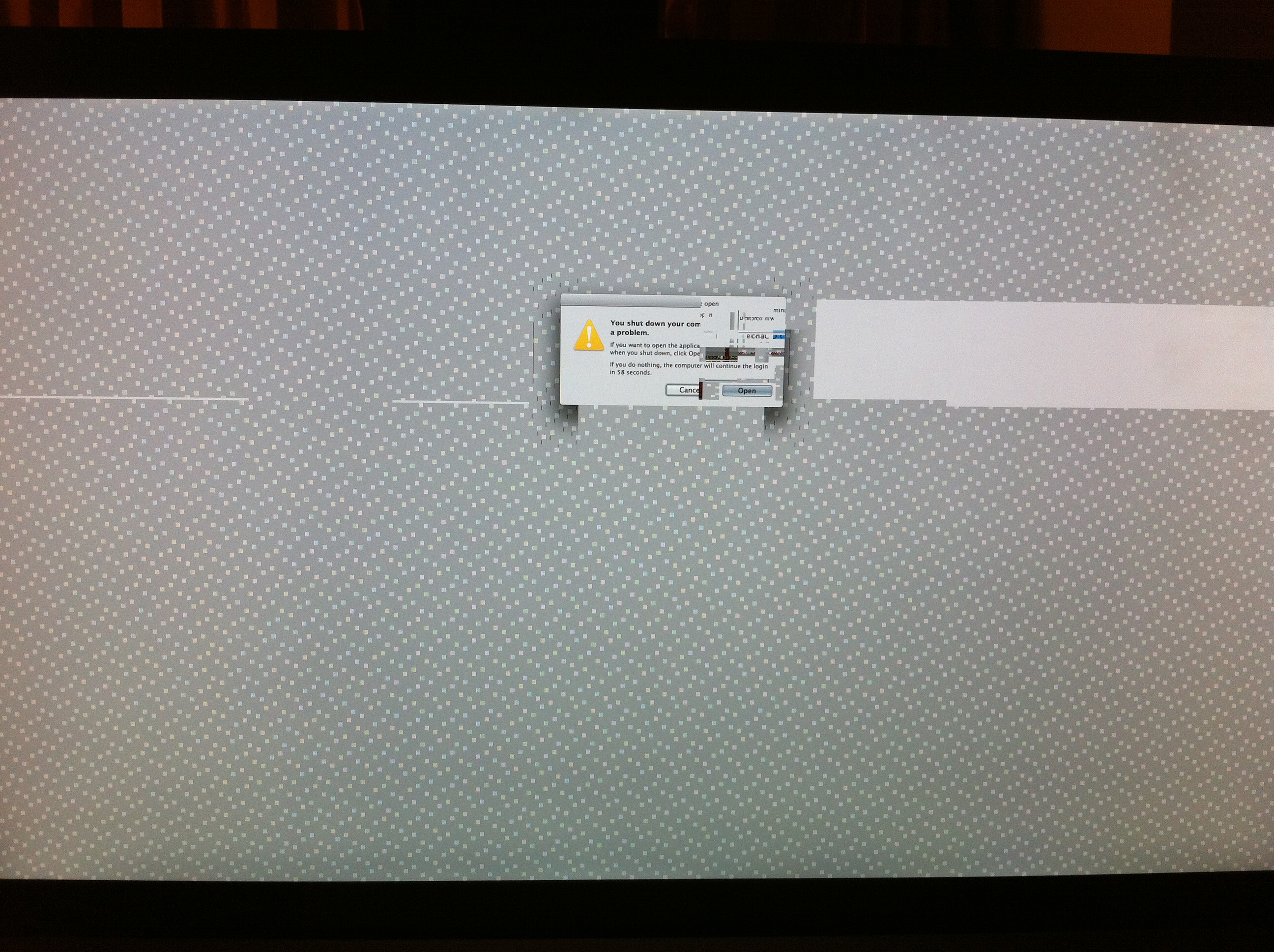

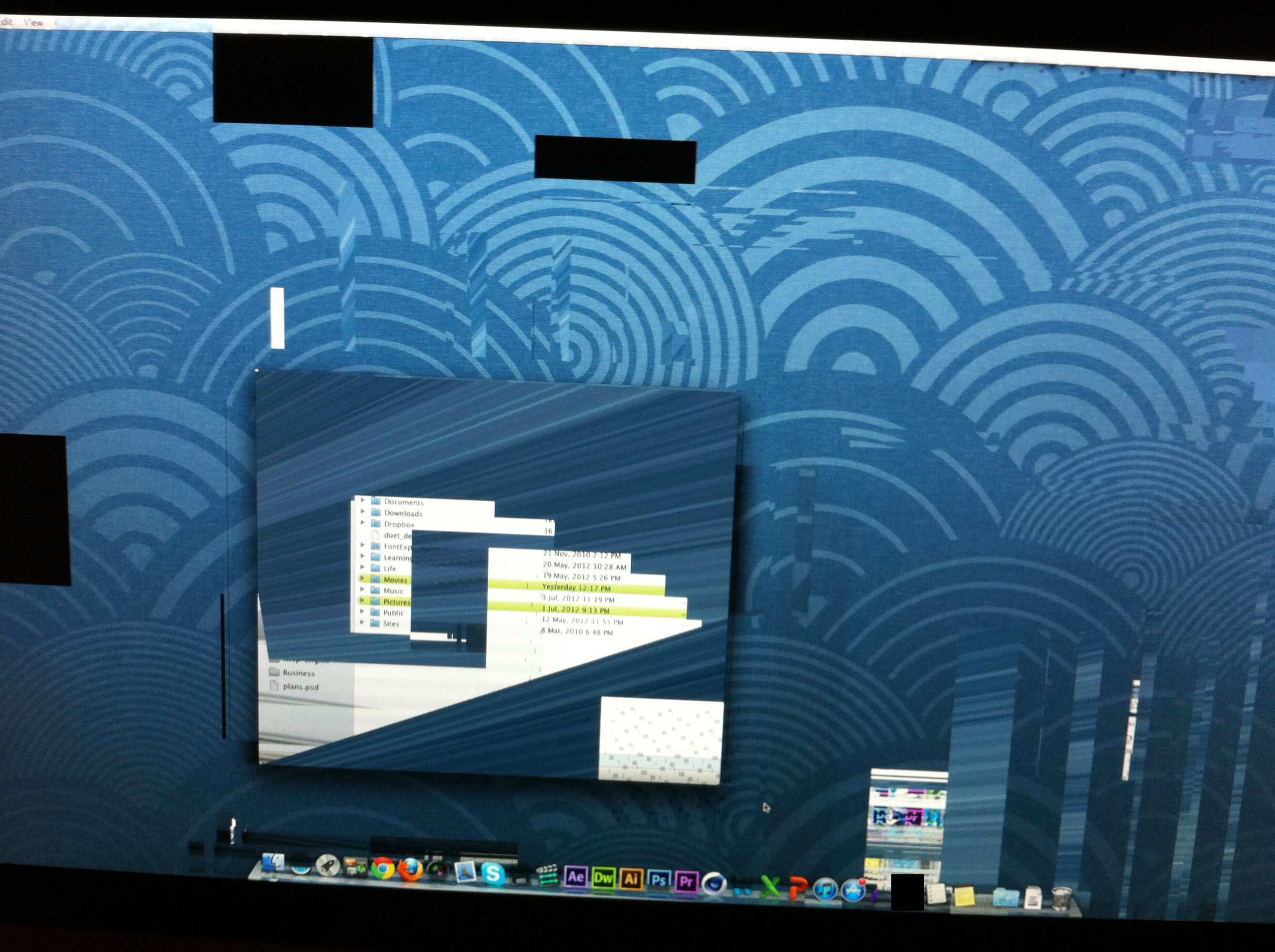

I upgraded my iMac '27 i7 (2009 model) from Lion to Mountain Lion. First day in, everything smooth and felt better than Lion.
Second day, it all went wrong and I can't use it at all.
There's some major flickering and distortions going on, to the degree it's not usable. Usually after about a minute after it has restarted and the flickering goes on, it goes black, and sometimes the 'Major problem has occurred, hold down the power button to restart'.
Very disappointed! Any thoughts?
I have done the CMD+R and tried to repair disk, disk permissions, reset PRAM. No use.
Anyone experienced the same?

A little update. I did a clean install with ML and I got hopeful as it looked good. But it took a couple of minutes and it locked up again with graphics getting all distorted and stretched. So I guess that means it's a hardware fault.

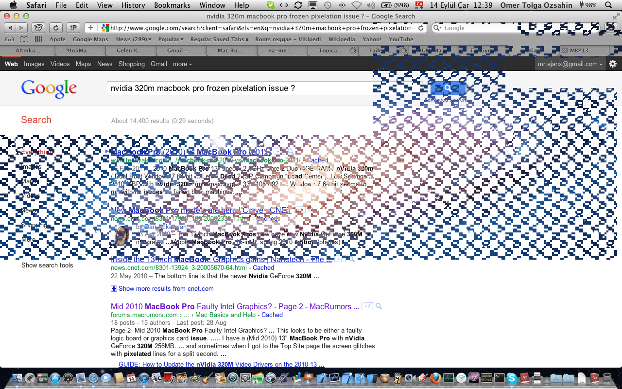

I experienced the same issue with my (Mid 2010) MacBook Pro just after I upgraded from Snow Leopard to Lion last year. Also its one year warranty was over one week or two. I also did not have Apple Care. I called Apple Care (USA) and explained the problem and they told me that it is a hardware problem. I asked them to repair it for free since the warranty was recently over. They transfered me to a Manager, he wanted to see the distorted screen image. I sent to him with email. They repaired it for free and sent it back to me. It is a bit over 10 months and now, so far I am not having distorted graphics yet. They changed the logic board and top case.
