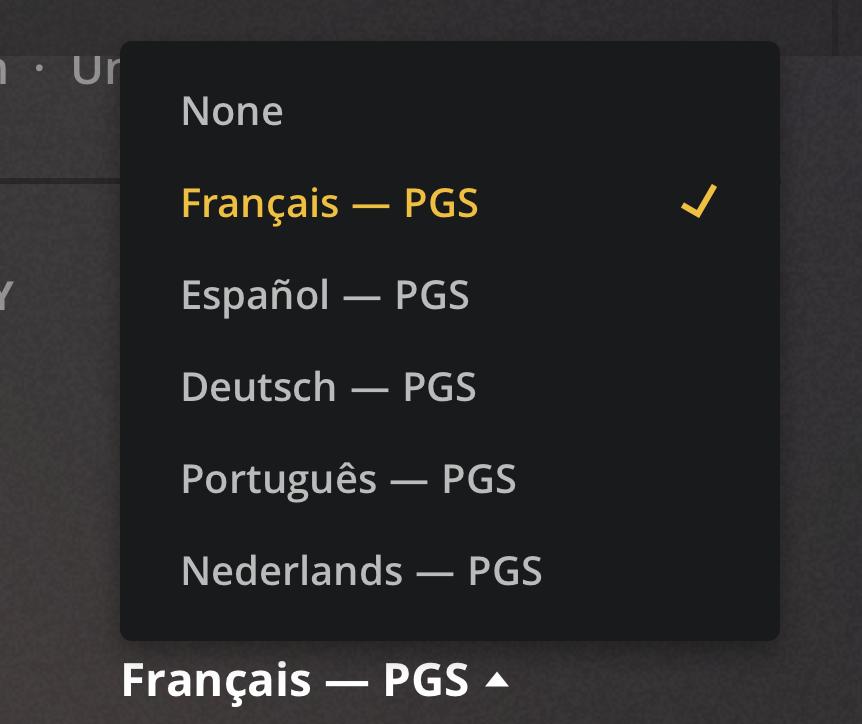

If you sort the stream folder in the package by size, normally the largest file is the main title. In some of my .m2ts files I do see the language subtitles in Plex:
so I guess I would say you might see the languages associated with the subtitles without any of the other support files on the disk.

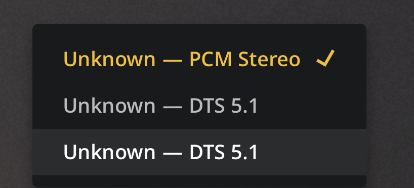

My major problem is determining which audio track to use as Plex gives minimal information:

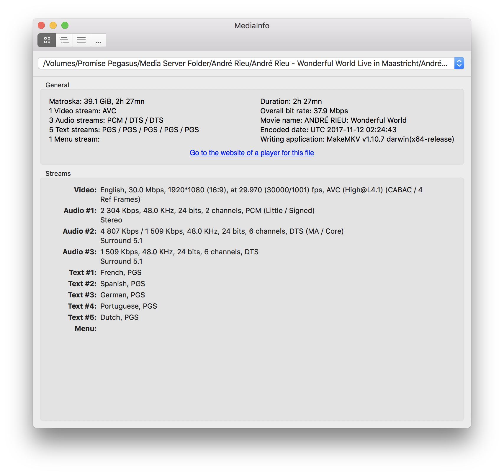

I drop the file into the MediaInfo app in order to determine which is the DTS-MA track:
so I know that audio track 2 is the high resolution one. I then add to the movie title name "T2" so I know which track to select in Plex. Awkward. Maybe someone else has a better way.

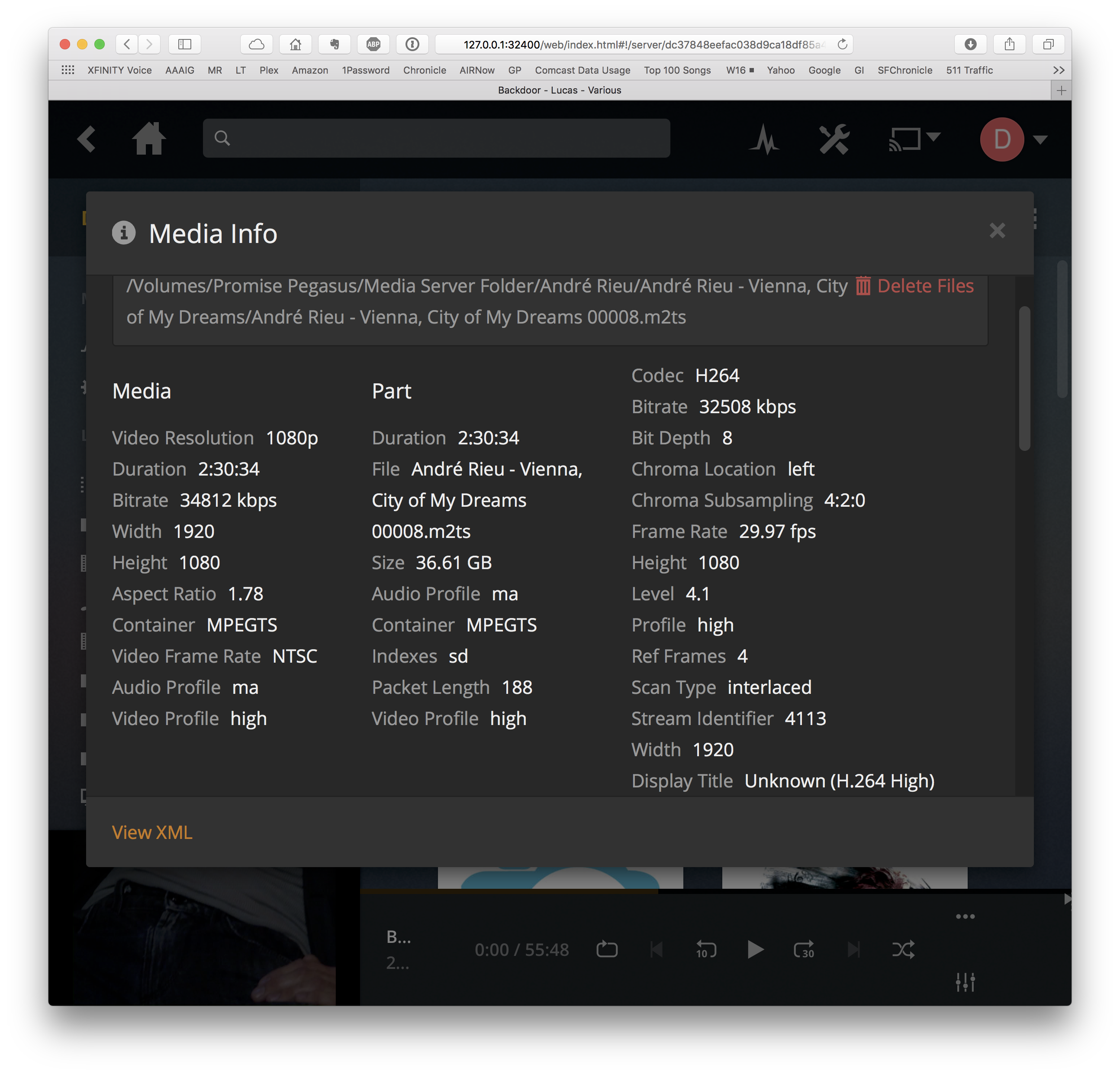

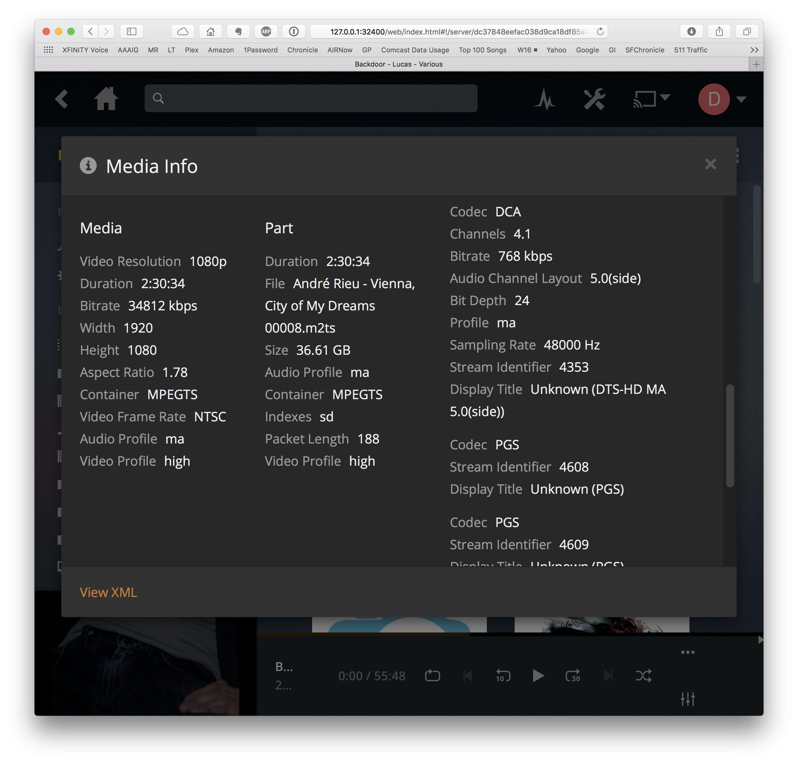

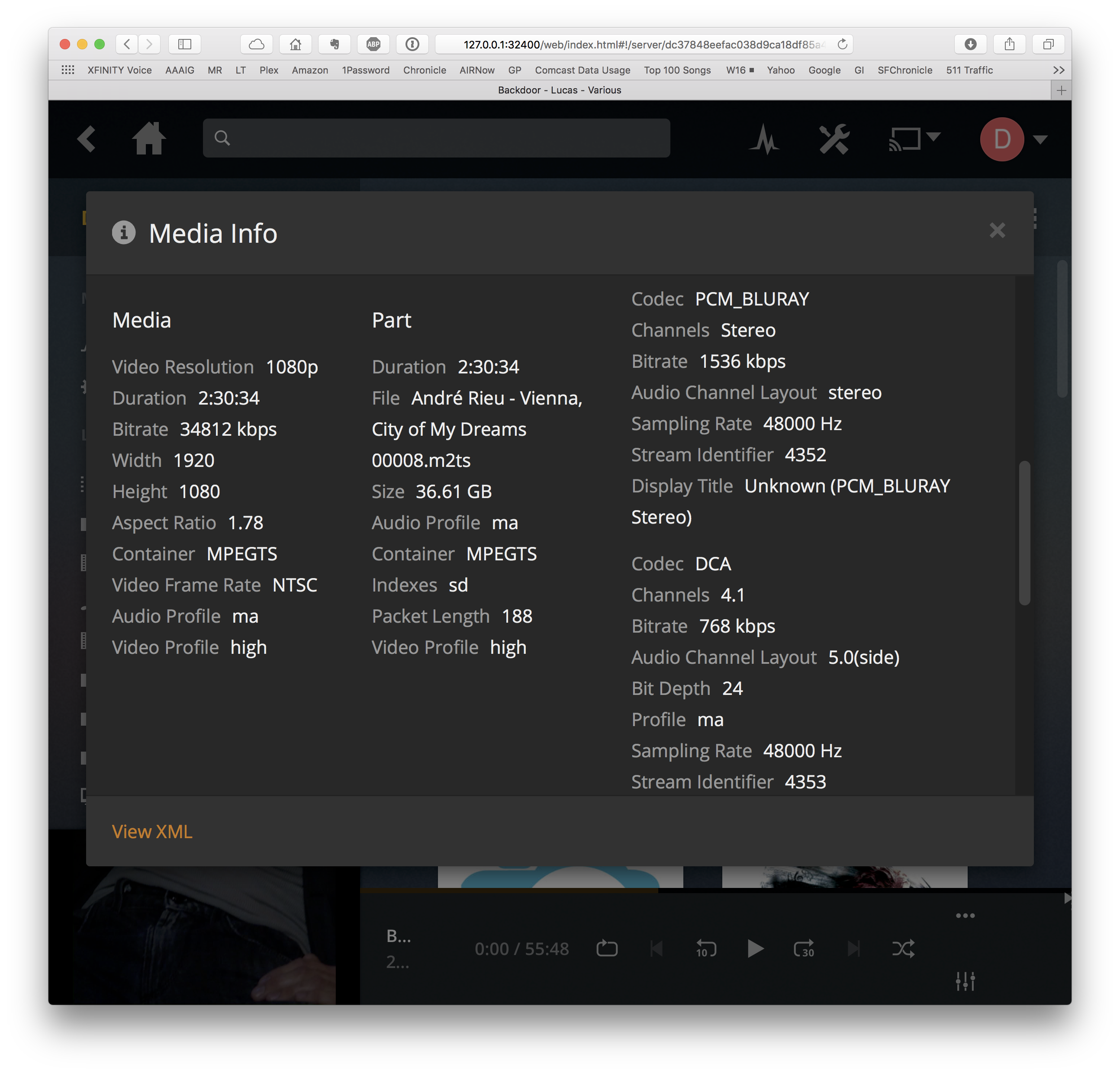

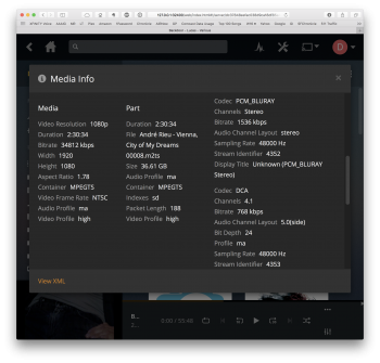

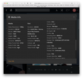

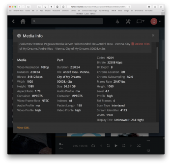

Ah, I see the 3 dot (more) option on the movie info page (in the Plex web app on my server) has the information.
