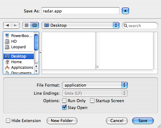

Dronecatcher's applescript launcher Code:
on idle
tell application "WeatheRadar.app"
activate
tell application "System Events"
tell process "InterWebPPC"
keystroke "r" using {command down}
end tell
end tell
return 60
end tell
end idle
@Dronecatcher I tried the script with the box and both are in applications but the launcher just instantly closes. Only thing I changed was 60 seconds to 300 and the app name from WeatheRadar to liveradarppc. It doesn't launch the box at all. Do you know whats wrong here?
Did you save as Stay Open as advised?
