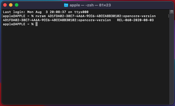

The guide has been updated to OpenCore version 0.6.0.
