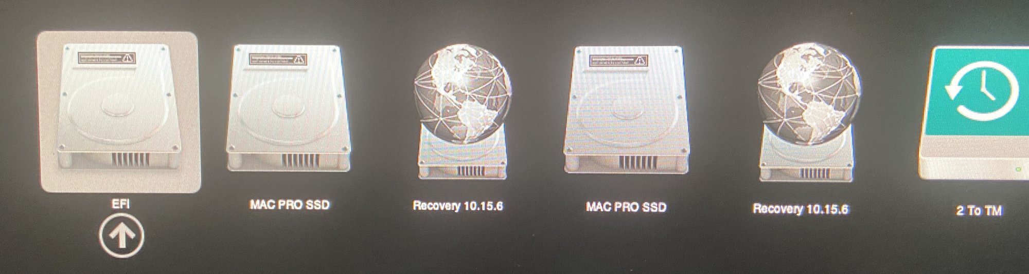

Hi thanks everybody for the good work.
I have bootscreen with your 0.6.1 package, thanks.
But something weird : My SSD and HD partition clone (pre open core ) appears with the same name :
Mac Pro SSD instead of first , ok
and the second name should be DEF CLONE CATALINA 2 (as name in finder, recognized by disk utility).
I can choose the second one and boot to the HDD clone, so it is a progress.

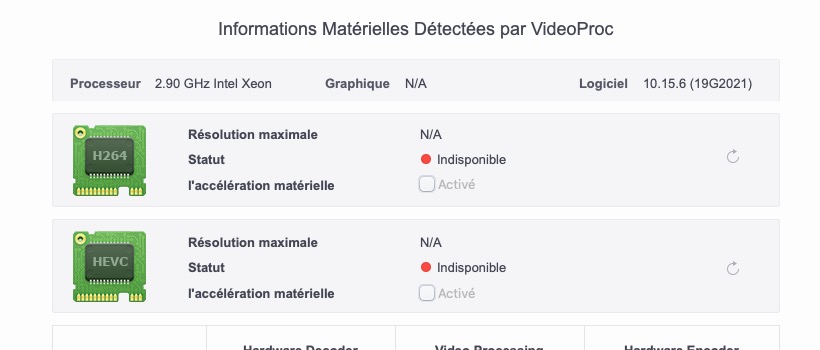

The Graphic acceleration isn't seen by Videoproc. What should I do please ?
Edit : For that I got it reading agin on the first post, I do not have a required Westmere (E56xx, L56xx, X56xx) / Gulftown (W36xx) processor but a Bloomfield one.
Remain the mystery of the boot picker 😂
