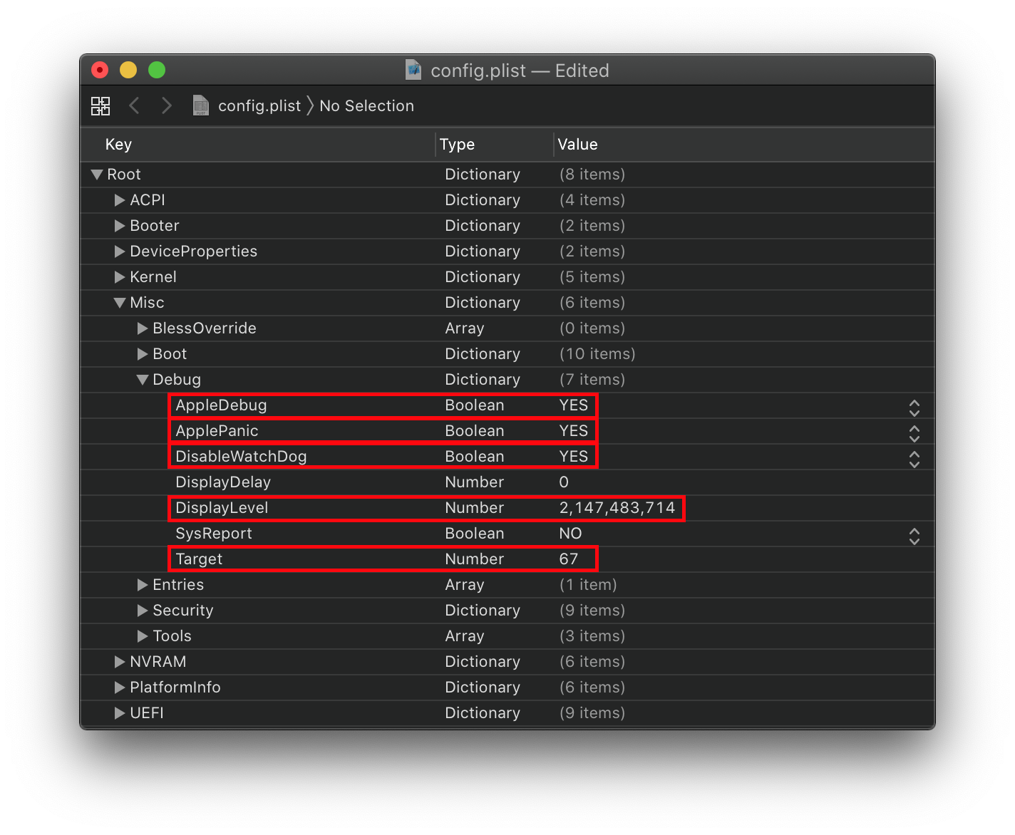

It kind of does not work for NVIDIA. Can you please use the debug version for logging?
File Swaps
To start, make sure you're using either the DEBUG or NOOPT versions of OpenCore. This will provide much more info than the RELEASE version, the specific files that need to be swapped:
  • EFI/BOOT/
    • BOOTx64.efi
  • EFI/OC/Bootstrap/
    • Bootstrap.efi
  • EFI/OC/Drivers/
    • OpenRuntime.efi
    • OpenCanopy.efi(if you're using it)
  • EFI/OC/
    • OpenCore.efi
Misc
Here we'll want to enable the following:
  • AppleDebug: YES
    • Provides much more debugging information, specifically relating to boot.efi and will also store the log to disk.
  • ApplePanic: YES
    • This will allow kernel panics to be stored to disk, highly recommend keeping keepsyms=1 in boot-args to preserve as much info as possible.
  • DisableWatchdog: YES
    • Disables the UEFI watchdog, used for when OpenCore is stalling on something non-critical.
  • Target: 65 (disregard 67 in the picture below)
  • DisplayLevel: 2147483714
