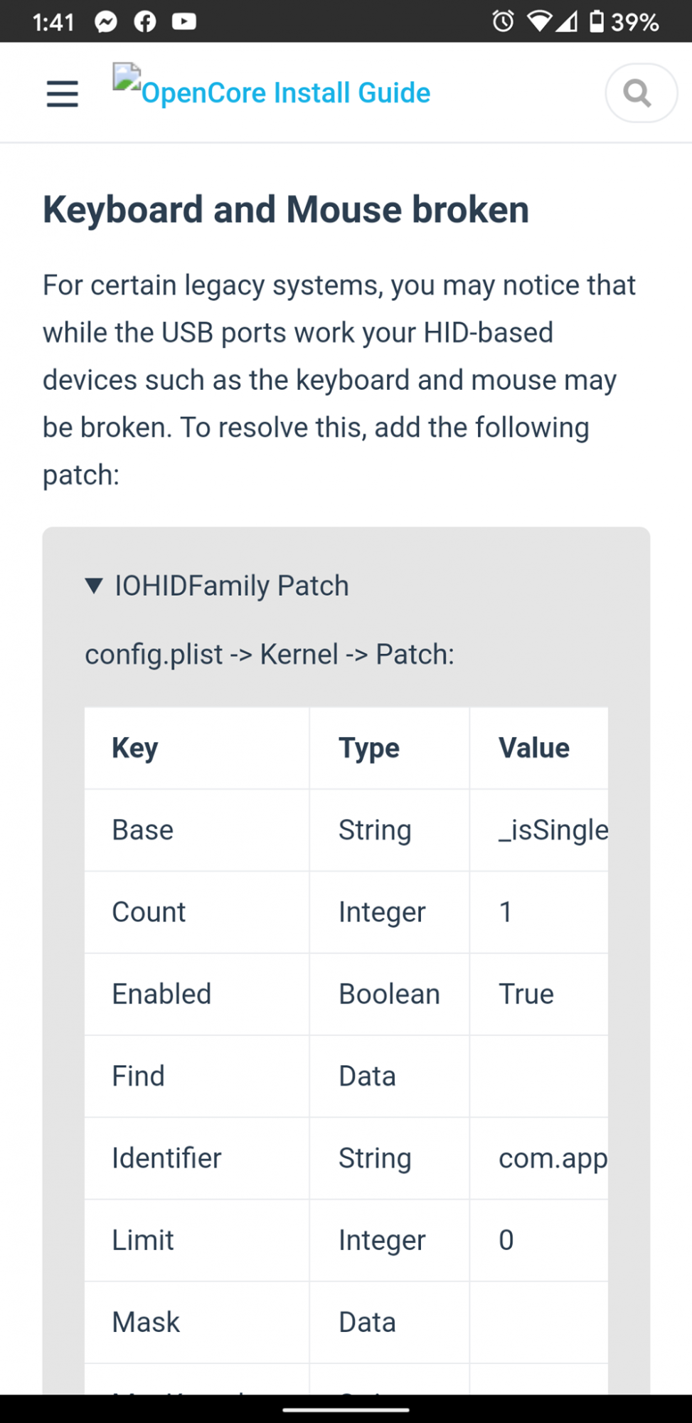

Hello everyone. I'm running a 5,1 and successfully installed OC to move to Catalina with everything working fine. No issues. I recently upgraded to Big Sur with the typical software update and everything installed fine and appears to be running ok, except 1 thing: My USB Keyboard and USB Mouse are acting strange.
My Mouse plugged into any USB 2.0 port on my tower is recognized in the bootloader and after logging into Big Sur BUT if I unplug it after logging in, and plug it back in, the computer won't recognize it, but it is powered.
My Keyboard plugged into any USB 2.0 port on my tower is recognized in the bootloader BUT after loading into Big Sur it isn't recognized and I can't enter my password. The caps lock and function LEDs flash but then go out and no input works.
Luckily if I plug them into a USB 2.0 hub attached to my USB 3.1 card, they are both recognized and swappable.
I've tested flash drives in every 2.0 port and they are recognized and swappable, so I'm really not sure why this is an issue with my mouse and particularly my keyboard.
Any ideas what may be the issue? I've searched the site and this appears to be a unique problem. I appreciate any feedback, thanks so much.

Something similar happens to me with a USB MIDI Controller, the system only recognizes it if I connect it to the apple keyboard port, I don't know if it will be an OC or Big Sur problem.

I have same an issue. It is a bug in big sur. I think usblegacy is broken
You gave me an idea I hadn't yet tested... I plugged my usb 3 hub with my mouse and keyboard into the usb 2 ports that aren't working with them individually, and they work. So I'll probably just get another cheap hub as a workaround... thanks!

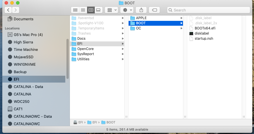

Bootable volume renaming issue
I apologize if this has been addressed before, but I've been unable to locate the specific instruction to rename an EFI volume. As soon as it was released, I installed Big Sur on top of a secondary disk that used to have a vanilla version of Catalina, and the disk name or label was Catalina. After successfully upgrading it to Big Sur, I changed its name to "Big Sur", and that's the way the disk appears when Apple's Startup Manager kicks in. However, if I choose Boot EFI as the the startup disk (when I press Option at the chime), the Boot Picker displays that Big Sur disk as "Catalina". How can I remedy this?
For disk labeling OC provides its own program called disklabel:
Copy and paste that to your Bootx64.efi folder:
cd to the folder in terminal and run:
Code:
g5@G5s-Mac-Pro-2 BOOT % /Volumes/EFI/EFI/BOOT/disklabel
Usage:
disklabel -d .disk_label image.ppm!
disklabel -e "Label" .disk_label .disk_label_2x
disklabel -bgra "Label" .disk_label .disk_label_2x
I normally pick the second option disklabel -e "OpenCore" .disk_label .disk_label_2x
in Big Sur If I disconnect my USB keyboard from the USB 2 port it will not reinitialize on a USB 2 port, only through my 3,1 Anker USB hub connected to a USB 2 port or directly to my USB 3.2 PCIE card.
yes I tried to plug usb flash drive 3.0 and it recognized. I think only issue is with usb 2.0 1.1
