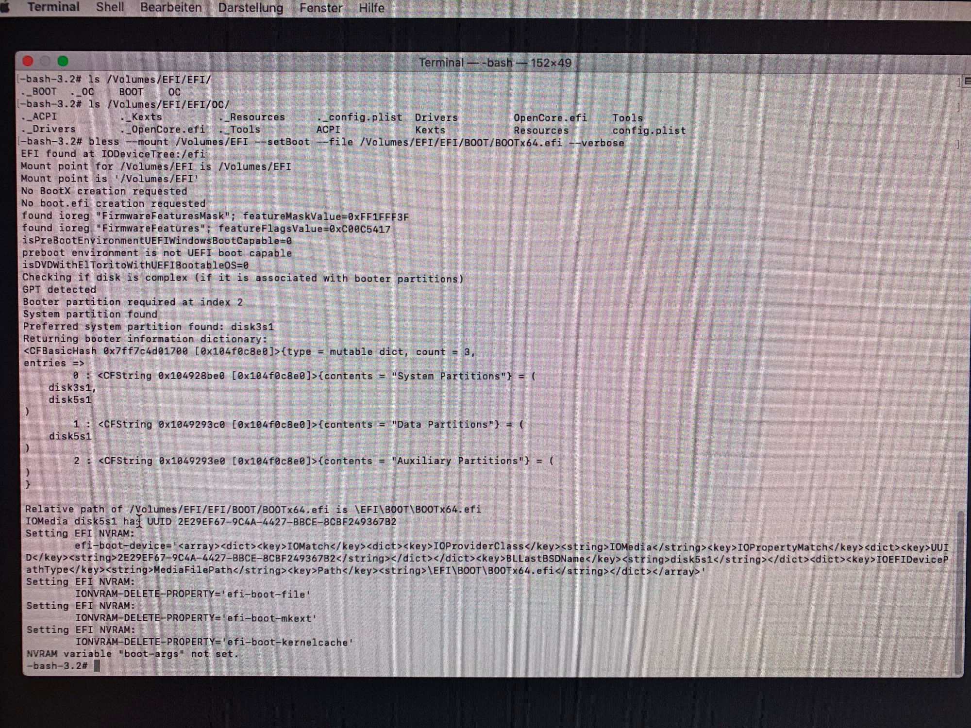

Next Problem. I have followed all Steps to the step blend: bless --mount /Volumes/EFI --setBoot --file /Volumes/EFI/EFI/BOOT/BOOTx64.efi --verbose. After rebooting i have no text-based boot picker, the Mac booted directly into MacOs. Is this happened while i have only one bootable system or must the boot picker always shown?
This is the output from the terminal in recovery mode after the bless command:
Why says bless "Preferred System Partition found disk3s1"? The OC Partition is disk5s1. Disk3s1 is my MacOS Mojave Installation.
