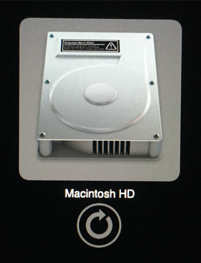

As a minor point I noticed that even with AllowSetDefault=true the OC bootpicker does not change the arrow icon as you hold CTRL (unlike the Apple bootpicker), so it is less obvious that the feature is there, but yes, indeed, it works fine - thank you!
Open a suggestion on Acidanthera bugtracker, you're pretty good at it making it happen. 🙂
I actually pointed this out to Vit a while ago, suggesting that a text version could be implemented first in Builtin mode, but it never panned out...
